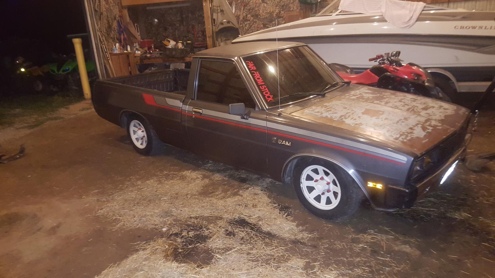

    So much "fun"... I don't think Dodge and Mitsubishi designed these engines to come out with the body on. 2 more engine/Trans bolts, exhaust manifold and turbo, and a few misc wires and the engine will be ready to pull out of the little truck. I've been spending most of my time working on my K10 pickup that caught fire last week, nothing like having 3 projects at once. Ready to get the little Ram running so I can sell the big one and continue with my K10.

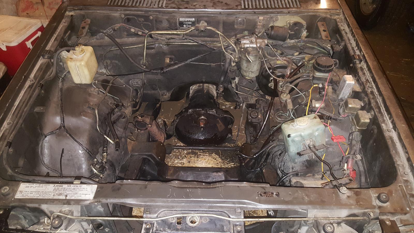

    I have been making some progress. Engine from the little Ram is sitting in the engine bay ready to pull out. Everything is completely disconnected, just need to put the trans in neutral and engine will be free from the trans. I think on the other truck I am going to take a different approach and remove the engine/trans as 1 to save time. I'm using basically everything from the new truck, such as the starter, alternator, whole engine, and turbo. I'm using my power steering pump, cold air intake, battery, and new radiator. I'll also probably swap out the valve covers. I will also need to trade the oil pans on the trucks, as the 4x4 and rwd have different shaped pans and also different power steering pumps and lines. I pulled the head off to look at the engine, and the valves looked good and so did everything else. I'm confused about that engine. I also discovered the turbo was fully caked in oil.

    Engine is completely out of the grey Ram and the engine in the Power Ram is ready to pull out. I'm free tomorrow-Sunday so I'll see if I can't get it running by then! I stopped by the store and got new coolant and diesel fuel cleaner, and I am going to order a new pan gasket from Rock Auto tomorrow morning. Not sure if I am going to keep the engine out and put the pan gasket on then or get the engine set it and hooked up and install the pan afterwards. Depending on when the gasket comes it may not be done until next week. I am going to order the halo headlights also, bolt the leather seats down, and clear coat the hood.

    Good engine is out. Power steering pump was switched over. Oil pans looked very similar so I didn't mess with swapping them. I also switched out the oil cooler and lines. Tried for 30 minutes to get the imput shaft into the engine with no luck. I don't think it's an easy task to begin with but after 7 hours today I was very tired. Hopefully it can be completed tomorrow or at least this weekend. Just need oil, filter, power steering fluid, and I'm going to swap the valve cover since my old one had new gaskets. Then I will empty the fuel tank to be on the safe side.

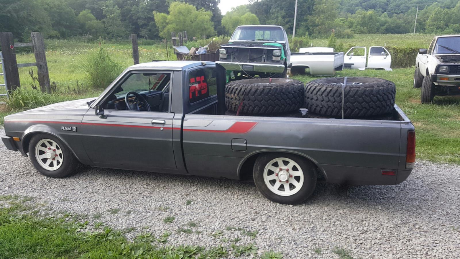

    I took the truck on a 2.5 hour one way trip today (around 5 hours total) Truck got around 30 mpg and I wasn't very easy on it and I also had 600 lbs of 37" rims and tires in the back of the bed. I did have a few issues.
    1. Truck rides terrible... to be expected from a 30 year old lowered truck. It needs an alignment. Front crossmember bottomed out many times.
    2. Starter took a crap when I got to my destination. It got stuck and I had to disconnect the battery terminal. Bump started it to get it home. That shouldn't be a huge deal.
    3. This is pretty serious... truck spit a TON of oil in the engine bay. When I got there it had probably spit out a quart at the minimum. It was literally everywhere. Left side of engine bay, right side of engine bay, both sides of the radiator, out the valve cover, oil pan, was on the bottom of the hood, bottom of the skid plate and there was a huge puddle on the ground after I let it sit. The guy I was meeting knew a good bit about diesel trucks and thought I was driving the truck too fast on the interstate and my RPM's were too high. (80-85 mph with the weight in the bed) Thought the rear end ratio may need adjusted after the engine swap. On the way home I kept it at 55 mph and drove it like a grandpa. Just got home and under the hood looks the exact same. Not sure what this could be, the truck seemed to run good. Could I have possibly put too much oil in it?
    I put 6.3 quarts because that's what it recommended for the 4x4 when changing filter (mine came from a 4x4 and still has 4x4 oil pan, 2wd recommended 5.8 quarts) I put in 6.5 quarts because I also put the oil cooler from the 4x4 in and it was empty. I figured that would be about right. I did have to install the oil cooler differently than the old one was, could I have possibly hooked up the 2 lines that go to the oil cooler backwards and that's what is causing the issue?
