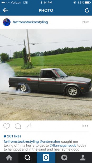

    Found some old rolling shots of my truck that the previous owner took. Figured you guys might like them. I followed these guys on Instagram way before the truck was for sale and always thought it was the coolest little truck. So yes I was pretty excited when I saw it on Craigslist so I had to buy it lol. If you guys have an Instagram, check that account out. The shop builds some pretty sweet trucks.

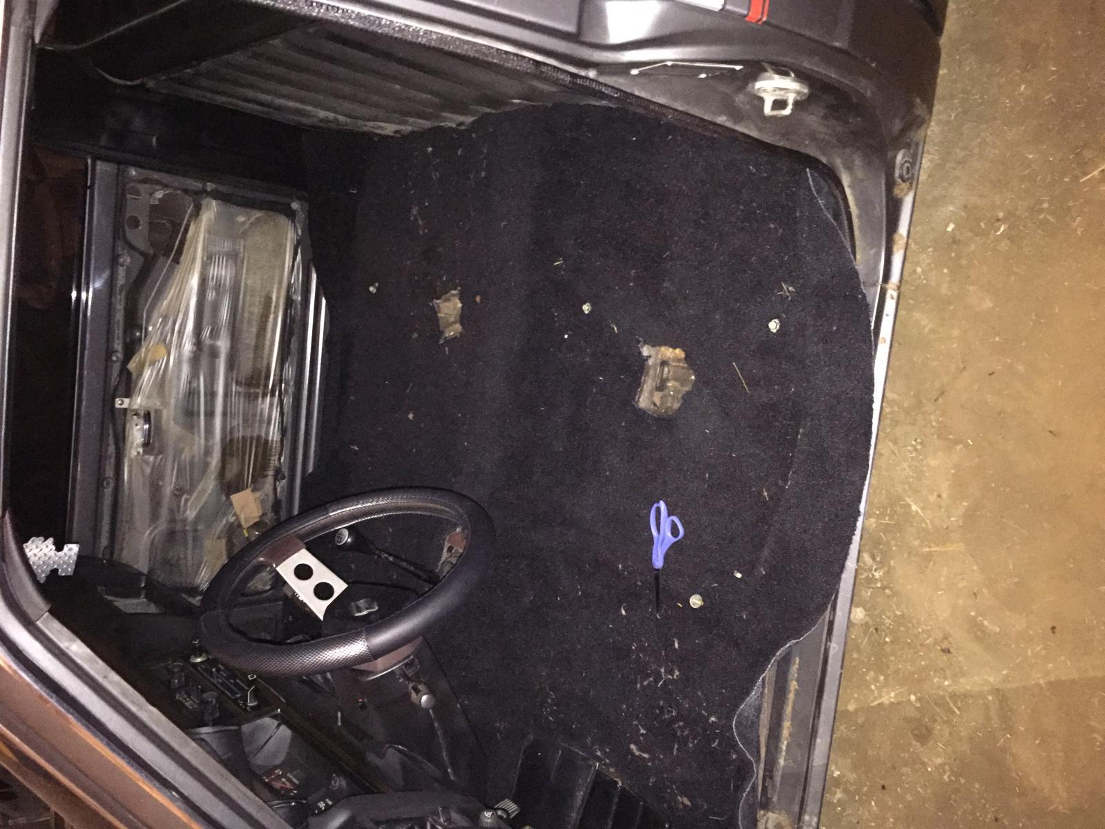

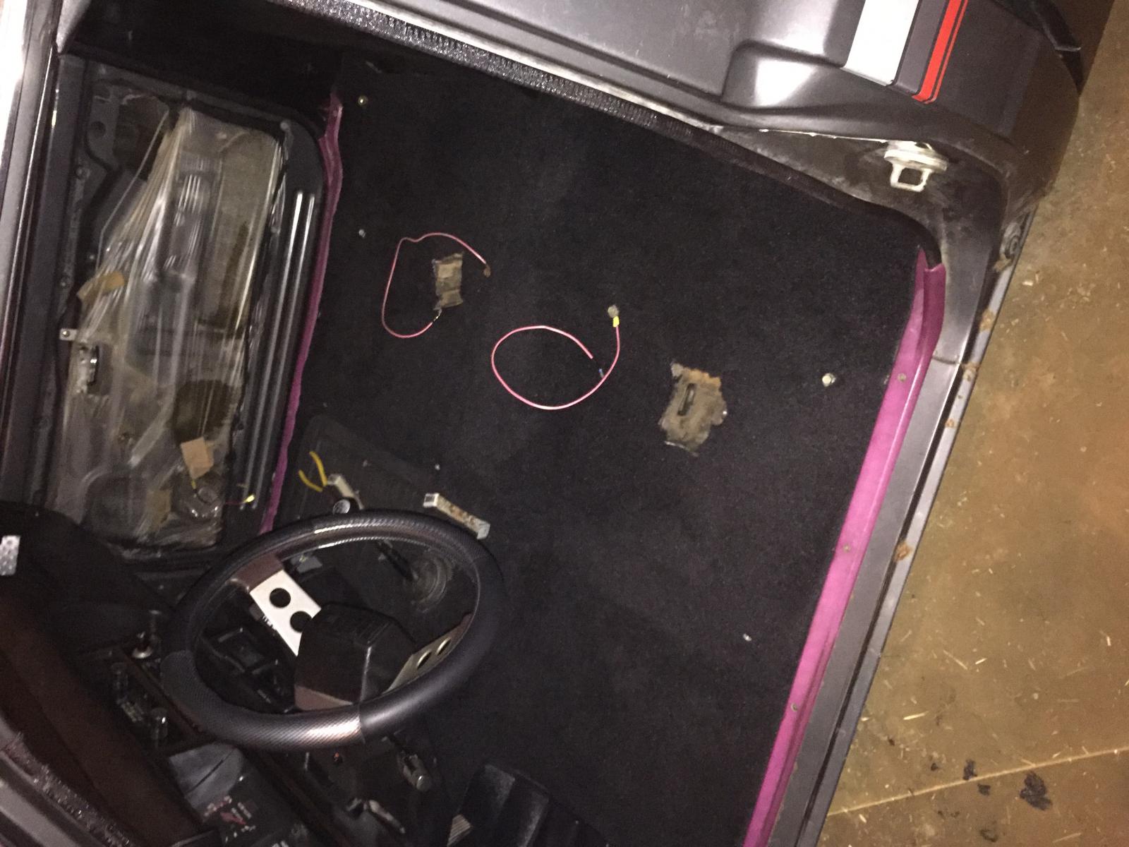

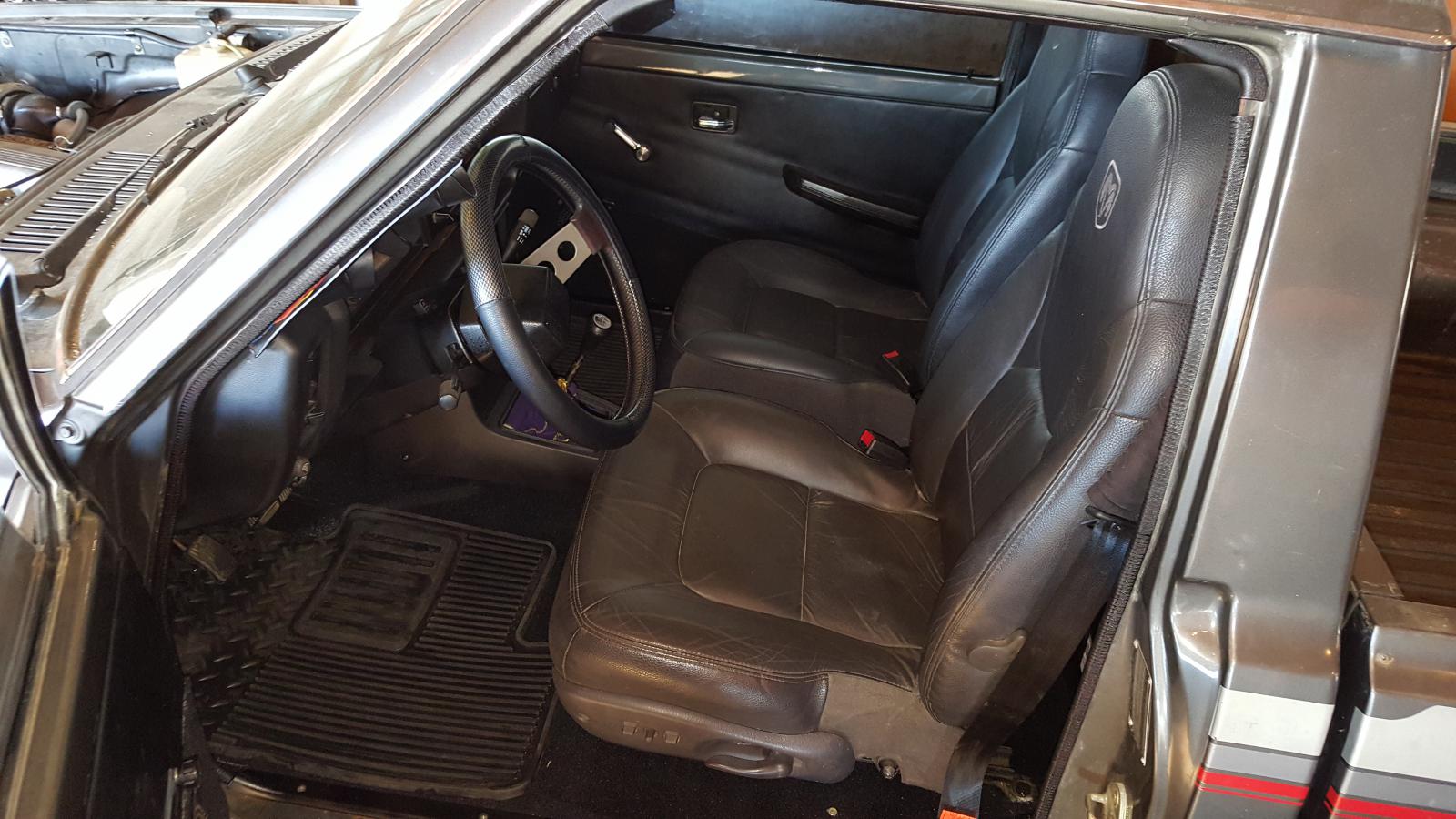

    Sorry I haven't posted much lately. Not much interaction going on and I don't like feeling like I'm talking to myself But anyways started on the new black carpet. Pretty dirty since I had to lay the old carpet over it to make the holes and trim it to size. It's ACC carpet and supposedly "Custom fit" but it was over a foot too long and wide and doesn't have pre-cut holes for seats, shifter, etc. I guess you could say it's a royal PITA but hopefully the finished product looks good

    95% finished with the carpet. There's a few spots under the pedals that don't want to lay flat and it's not letting the gas pedal go all the way to the floor (which I'll be doing a lot) However it does look pretty good cleaned up. After I used the old carpet as a stencil for the new one, I layed it back down in the truck and installed the new carpet over it, as I figured it'd help insulate the truck, keep down road noise, and make the floor feel softer. I also got the entire interior back together which isn't pictured. Still need to get stuff to do the door panels and headliner then I'll almost have everything I need. I also put the sun faded door sills back in to hold the carpet in place. I'd eventually like to find a new set as one of mine is missing 2 inches or so on one side and the other one has a few big chips of the plastic missing. I may just paint them black for now but when I get the new ones I'll probably get them hydro dipped in carbon fiber print. Also, I ran a fused wire to the battery for the power seats and ran another power wire off that for the passenger side, and then made a ground wire on each side. I also spliced the wires on the two seats and put connectors on them (similar to what you slide onto the stereo prongs) and put the prong style ones on the wires I ran in the truck. After I get the seats installed it will be as easy as plugging in 2 ground and 2 power wires to make them work.

    A little trick I did with my carpet was use a heat gun to warm up the backside then pressed it flat. As for underlay look at Cool It sound mat it's a hell of a lot cheaper then Dynomat. http://www.summitracing.com/int/part...4720/overview/

    Thanks Fordubishi I'll have to try the heat gun tomorrow. I don't know if it makes a difference but it's right under where the vinyl foot pad is and it's also the area with the insulated backing. And also ty camoit, I'm pretty new to the site and didn't realize there was a view counter. Was going to ask where but I found it

    That's how ACC carpets come, they are custom "molded"(meaning made to he shape of the floor pan) not custom fit. I find it much better to be that big so you can custom fit it to your vehicle, as not all vehicles are created equal and not all are "stock". Some, had buckets, some had benches, also etc.
    Looks good though, a new carpet can make the truck look brand new inside again.

    you can also use a hand steamer to reshape the carpet to fit. Part of the reason the carpet is not fitting around the pedals is they allowed for the differences in the tranny tunnels between the automatic and the manual trannys - the auto tunnels are wider - which causes the carpet to lump under the gas pedal in a manual tranny truck

    The new carpet looks awesome I'm yet to find any aftermarket vehicle carpet manufacturer that makes a 'true to fit' replacement carpet. Some of the carpets I've seen were just - terrible. This is another one of those jobs on my to do list. Can't wait to see how the new seats will look!
  14. #39
    You can also do a relief cut with a sharp utility knife then use self sticking carpet tape on the back to pull the edges back together. I Had to do that to mine in the passengers side under the heater area.

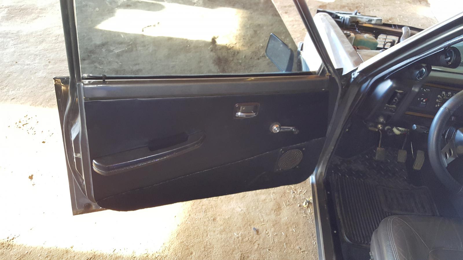

    Sorry I haven't been on in forever but unfortunately I haven't made any progress engine wise. I've got the interior almost finished up and removed the plasti-dip from the front bumper so it's a nice chrome now but if anything I've went backwards on the engine progress. It would turn over forever but not start. I put all the timing marks where they should be and still no luck. It seemed like it jumped time and it made what sounded like a grinding sound. I took the valve cover off and there was a U shaped piece of metal broke in 2 just laying on the top of the head. I think it came off something connected to the cam... Looks like I'll either have to pay high dollar for a rebuild or have to take it to a shop to fix it because I'm done messing with the engine myself. I was excited to start driving it after winter passed but I guess it had other plans.

    Been very busy with school and haven't had much spare cash to work on the truck. I've been buying and selling cars and atv's these past few months and just bought a motorcycle so I haven't had much money at the same time and I have no clue what it's going to cost to fix so I've been putting it off. The interior is basically finished besides a headliner, sun visors, and the seats need bolted down. Put a makeshift shift boot in since the original was ripped but will get a black leather one sometime. Also just ordered a black dash mat. But for now the interior looks pretty good to me. Still can't figure out the engine problem, put it in time, bled the lines, and double checked everything and it's still not firing. I'm starting to lean towards the engine having low compression and needing rings or something else that could have went bad or overheated when the head gasket blew. I'm starting to just lean towards forking over 3k to get the whole thing rebuilt since it's starting to look pretty cool and I wouldn't mind keeping it awhile
  18. #43
    That cabin is lookin' seeeexxy Drake. Shifter boots are cheap - you'll find one that will tie in nicely with the interior theme you're building. Maybe a billet shifter knob too. The black dash board and door trims always look like they mean business (as apposed to Mitsubishi's lovely poo brown )
    p.s. those Ram seats are killer!

    Thanks. I must say the seats look pretty good for what I paid for them. $25 for the passenger seat and $50 for the drivers seat! I've already got the power wires ran for them also. They are extremely comfortable also.

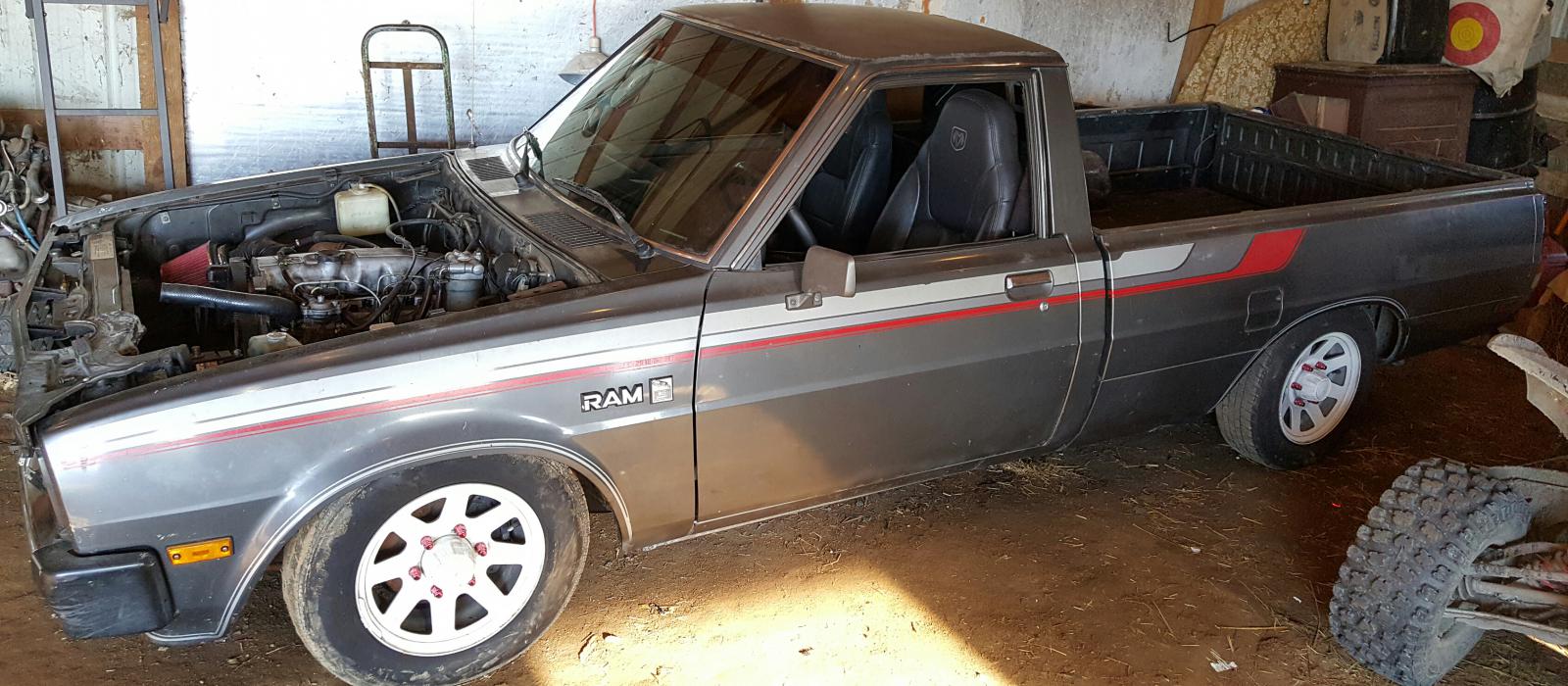

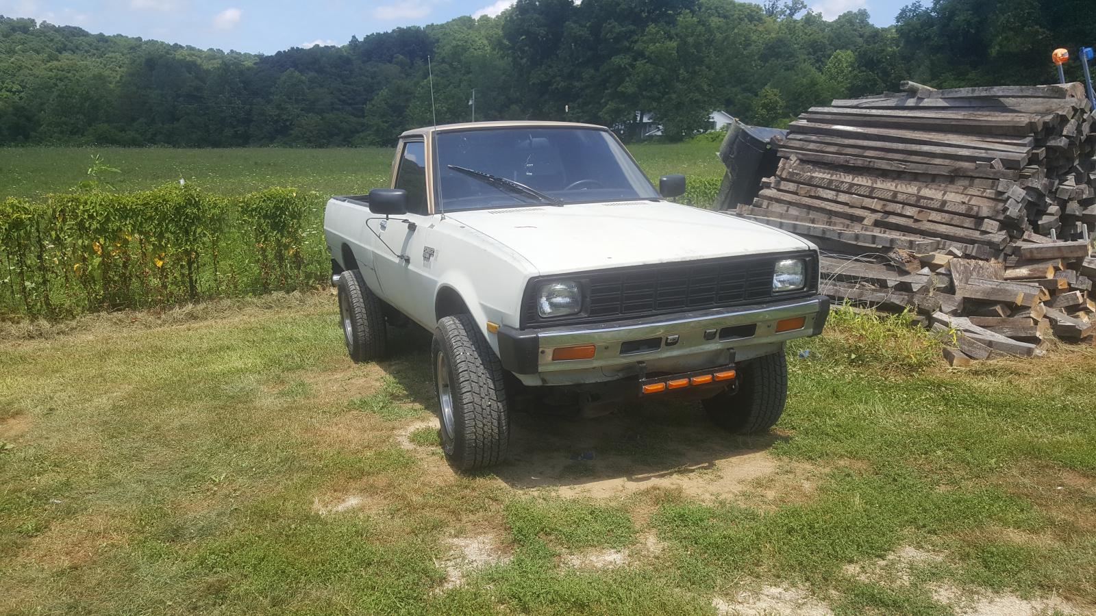

    I have been very preoccupied, but I got lucky and found a 1983 4x4 Ram 50 diesel on CL and purchased it last night. Only 84,000 miles and the engine runs great. Frame is a little rusty and the transmission is not the greatest but the engine was what I wanted. I figured I could swap the engines then sell the truck and not have too much into it.
  23. #48
    12-18-2015
    46
    Zanesville, Ohio
    1983 Dodge Ram 50
    4D55-T

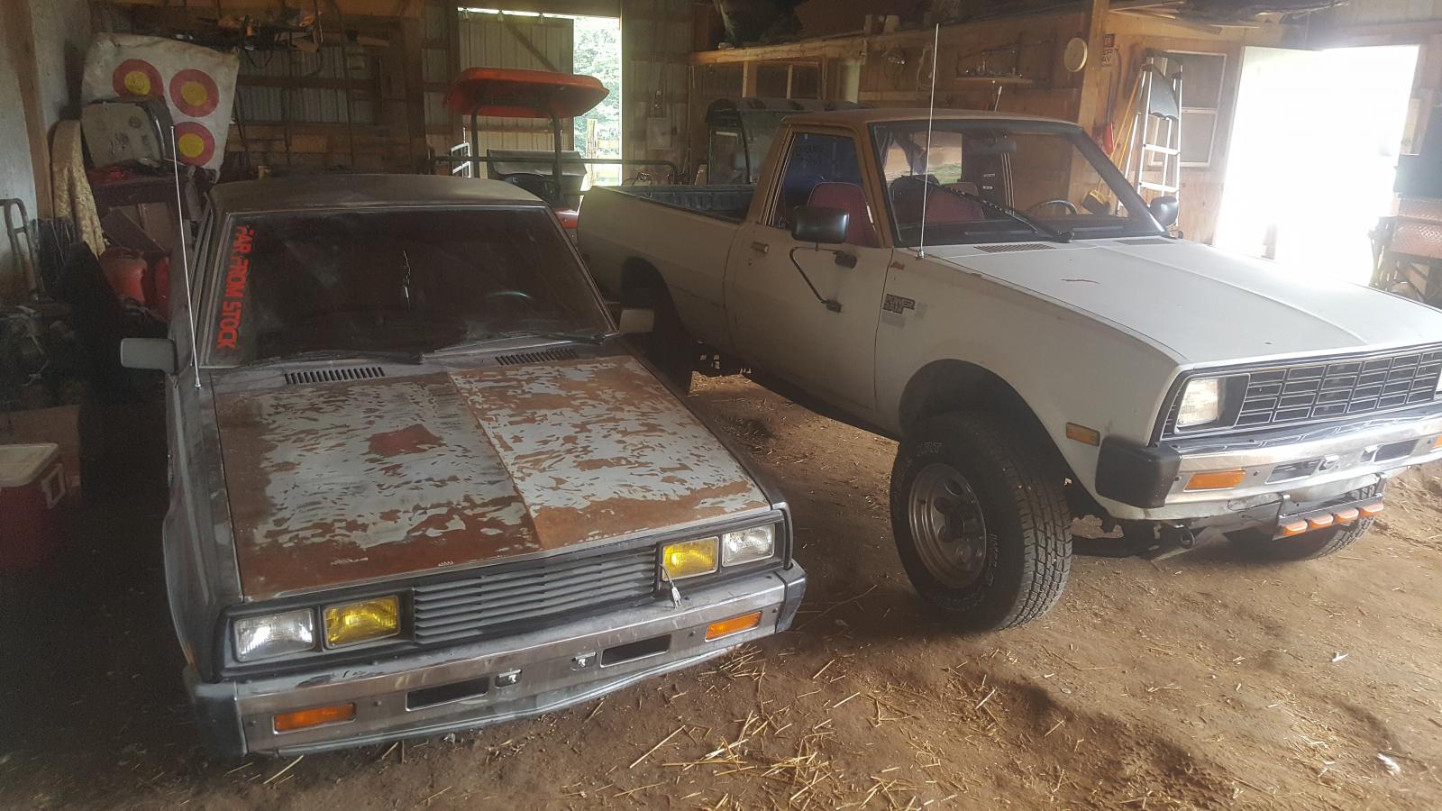

    Here it is. 1983 Ram 50 TD, 3" lift, brand new 30" tires, rust free bed, very nice interior, 85k original miles. Engine will be swapped info mine and this will be sold as a project or parted out. Hope to have the swap done in a few weeks. I will take pics of the process.

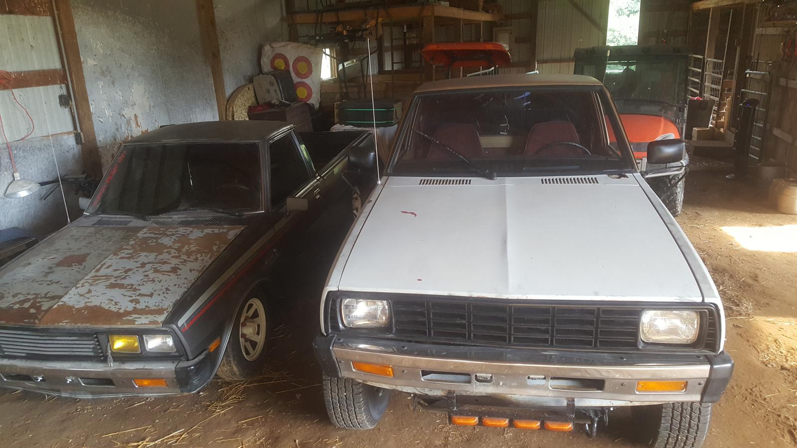

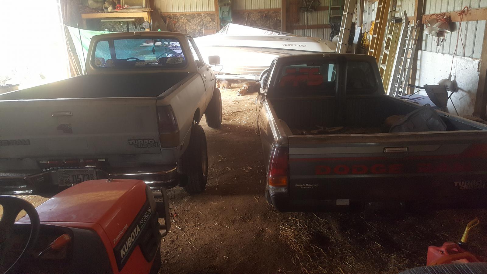

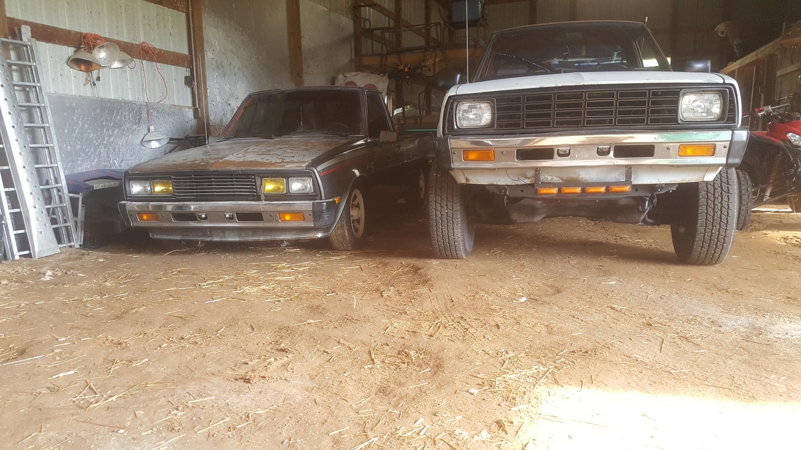

    Here are some pre-swap pictures of the 2 diesels parked beside each other, pretty big difference if you ask me! 5 inches shorter than stock and 4 inches taller than stock. I decided to not paint the hood factory color since it would look too "new" compared to the rest of the faded paint so I removed the temporary black paint and am going to leave the patina look. I will be clear coating it after it rusts a little more. More than likely I will get 4 clear headlights with red square halos to put into the little Ram after I swap the engines and call it a day. I also got a Hurst shifter out of the big one, and the fabric on the underside of the hood.
