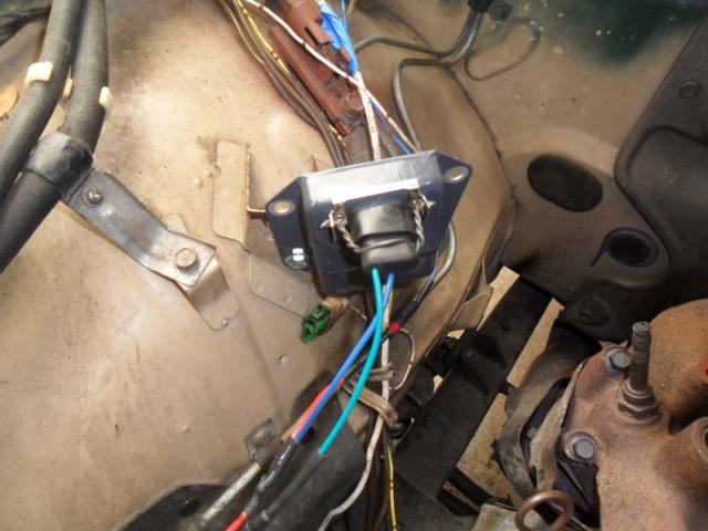

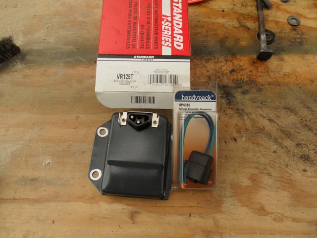

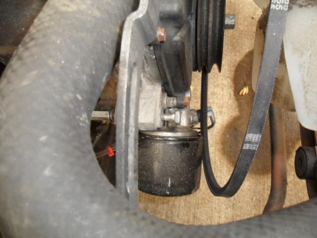

    OK I took out the old alternator and started to try to install the new one. I have the feeling I have to eat this alternator and buy another, but not yet. First pic is of the regulator and pigtail for a 73 Plymouth Duster.

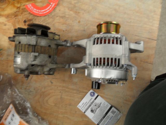

    The shaft on the 45 amp is smaller, 5/8. The new one is 11/16, so the short bushing off the 45 amp won't work to let the pulley ride on the new one. So I need a new v belt pulley bushing or pulley if the newer ones aren't two piece and have a similar set up to the serpentine pulley.
    Next the pivot bolt is 1/4 inch as is the hole through the motor. The holes for the pivot are two sizes, 3/8 and the one with the bushing in the picture is 1/2. How have folks been coping with that?
    The top bolt hole is 3/8. You'll need an 1.5" 3/8 bolt with washer and nut for the adjuster. The single bolt on my 45amp won't work.
    Except for these annoying but critical differences the sizes look and measure the same. That's 7 inches between pivot and adjuster bolt.
    Can't think of anything else right now.

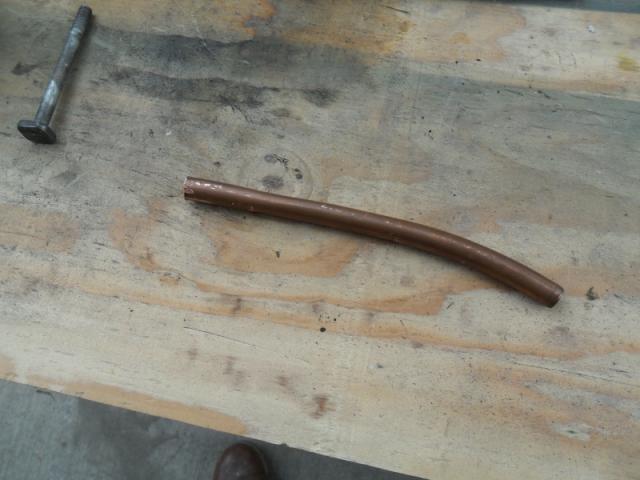

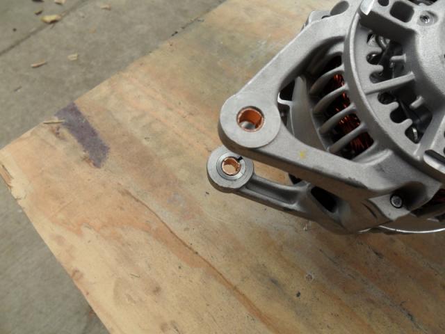

    So I was looking for unthreaded slotted spacers. I called and went to several places. No one could help. At the last place the guy, cutting on a huge vertical band saw outside, looks over the alternator and listens to me. Then he says wait a minute. He was gone so long I thought he was pulling my leg. Then he comes out and he has that piece of copper. He told me to take it. It took me a bit to work it out but by the time I got home it sunk in. The OD of the tube was just over 10mm the size of the existing holes. The through bolt is 8mm. Sure enough I cut the tube and it worked. I had to cut it two thicknesses of the cutting wheel on my grinder. Then I cut off the extra spacer that came with it.
    I installed it and hooked up the wires and now all I need is to find a V pulley for it. Then I can find out if it works

    Note- The spacers did not make it stiff but it did tighten up with no play once I wrenched bolt on. It wouldn't have done that without those home made spacers. I think that was a 1/2" tube of potable water pipe, as it was bent and soft. That stuff has thicker walls than off the shelf hard copper pipe.

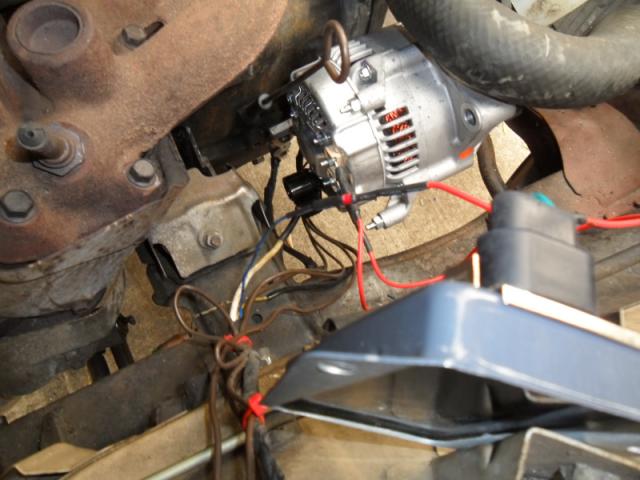

    Still waiting for the pulley. I tore open the wiring harness and pulled the blue wire out of it and retaped the rest. It seems way too small to handle 90 amps. Anyway the heavy white wire runs to the + battery and the blue wire goes into the firewall on the driver side. It is spliced to power the reverse lights. Now if there is a problem I only have to chase it inside the cab and put in a heavier wire.
    I saw something on the pulley site. They sell kits for dodge external regulators. Theirs has a clip set up on the pigtail they supply as apparently there is an issue with the plug falling out. So I made one with tie wire.

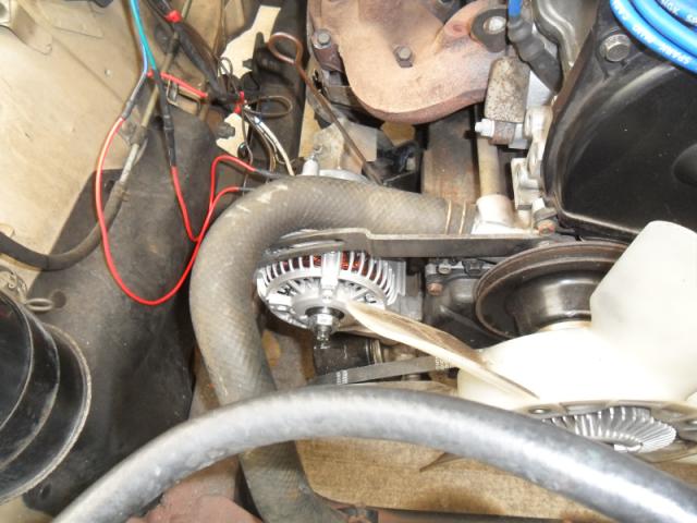

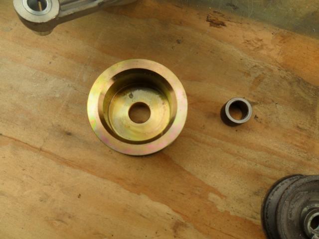

    OK the pulley I ordered did not work. I started looking again resentful as hell about the first guy and a wasted days waiting then I just went out there took the pulley from the new alt and cut it up leaving behind the piece that slips over the shaft which was long enough to give me clearance to put the original 45 amp two piece pulley on it with the new nut that came with the alt. I had to pull the alt tighter after the first try as revving it gave belt squeals. I tested the bat before starting 11.99. Then when I had it running and tight 14.90 to 15.03 on the DCV scale of the multi meter. All the dash stuff looked good, radio came right on.

    On my first gen D50 the pivot bolt is 8mm. If you go with an alternator for a Dakota which I did purchased new, that hole is much bigger. I used a home made solution in a previous post of a 1/2" copper pipe cut to act as a slotted spacer. Had to cut down the width of the slotted spacer it comes with. It feels loose but tightens up nicely when you bolt it down.
    The other problem is the pulley on the OE alternator cannot mount directly to the new one for a Dakota. Check the bore sizes and clearances before you decide what you are going to do. Some pulleys have shoulders and the Pure Energy alt I got has an indent that will make the body rub on most pulleys. I ended up cutting the pulley off the new one down to just the part that fit on the shaft. It acted as a 3/8"thick washer and I was able to use the two halves of the OE pulley with the new nut. I also had to get a larger longer bolt and nut for the adjustment arm.
    On the wiring I had to take the tape off the harness along the wheel well so that the large white charging wire could move about and bolt up. I had to bolt it up before mounting the alternator.
