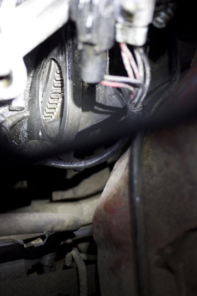

    Heyo,
    In the last month or so when starting, sometimes I'll get a GRIND and no start.(maybe 1 in 20) Usually will fire up next try with a little nudge to the truck. Pulled the starter, teeth look fine to me and should be getting full power.
    Trying to look at the flywheel but it's a little hard to see...But also doesn't look significantly worn down or messed up. The inner wheel does show some sign of wear, and there was some buildup of metal shards in the housing.
    Thoughts?

    Have You examined the complete Flywheel Ring Gear ???
    Not saying the starter (or starter sub parts) are not the issue,
    Looks to Me, from the second pic as there is significant wear
    on the ring gear & a broken tooth !!!
    I (mho) would use whatever method works for You & examine the complete
    ring gear.
    Edit,
    Yep blew the pic up to the max, & most certainly a broken tooth !
    Hopefully the ring gear can be replaced ---

    Took starter down to local shop and tested it there. The gear flew out and spun like it should...and teeth were fine.
    Yeah claych, I think you're right about the gear wear and broken tooth.(By ring gear do you mean the inner ring?) Figure that must be the problem. According to some, the flywheel stops in 4 different spots, so there must be a bad spot that it sometimes lands on.
    Hopefully it doesn't get too much worse cause I can't really afford to drop my tranny just to replace it.
    Cheers, and thanks for the feedback!
