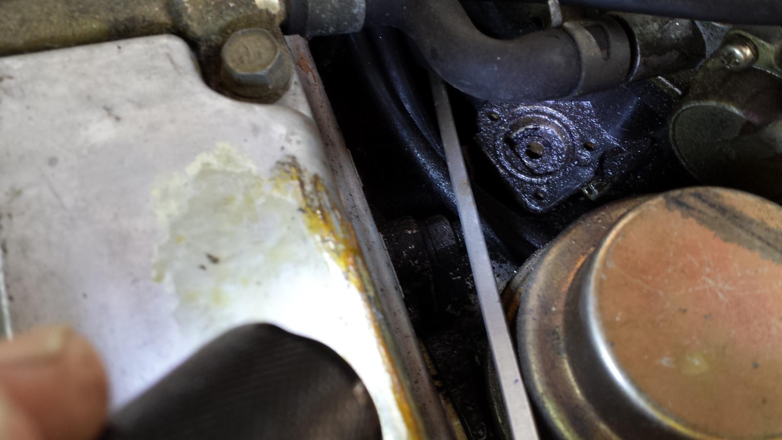

    I cannot determine what part is missing between carb and manifold. I have attaached image
