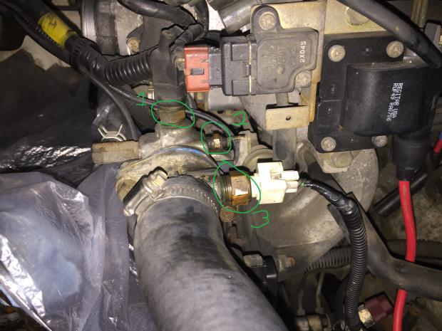

    While we are talking about coolant sensors, do I have these right?
    1. ECU
    2. Cluster gauge
    3. A/C
