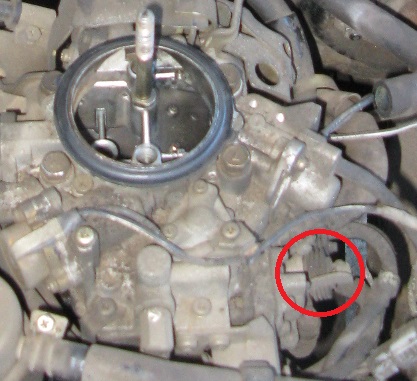

I don't think I touched anything else other than taking off the air filter housing and the heater hose. When I first was looking around to see where the steam was coming from everything looked GREAT. No oil leaking, no obvious signs of overheating or leaks anywhere, until I found the heater hose had exploded. I didn't mess with a anything else just replaced that hose section.
Wondering if the pressure of the fluid when the hose exploded could have damaged something around the carb (under the air filter area), or what in the hell probably happened.
How would loss of some coolant cause a super rich condition? Or is that even possible? Makes no sense so hoping for any ideas.
The truck was running fantastically wonderful before this happened so no idea what I could have done wrong/vacuum lines accidentally bumped by me or ruined when the hose let go?
Is there an electronic anything that could have been damaged by the sudden burst of coolant in the wrong direction?
Will look for signs of vacuum hoses being damaged, re-do that kinked heater hose, Maybe try to run it & see if there's air in the cooling system to be burped out? maybe check the plugs??? but they're likely to be filthy with it running so rich anyway so I don't know if that would be useful to see anyway.
Does coolant actually run through the carb??? If so, what sort of damage to the carb happens when it runs without coolant at 35mph for simply just 2 minutes to coast into a parking lot? Heck, I don't know if it actually ran without coolant anywhere because it only took about a gallon & I'm pretty sure the capacity is much higher than that.
