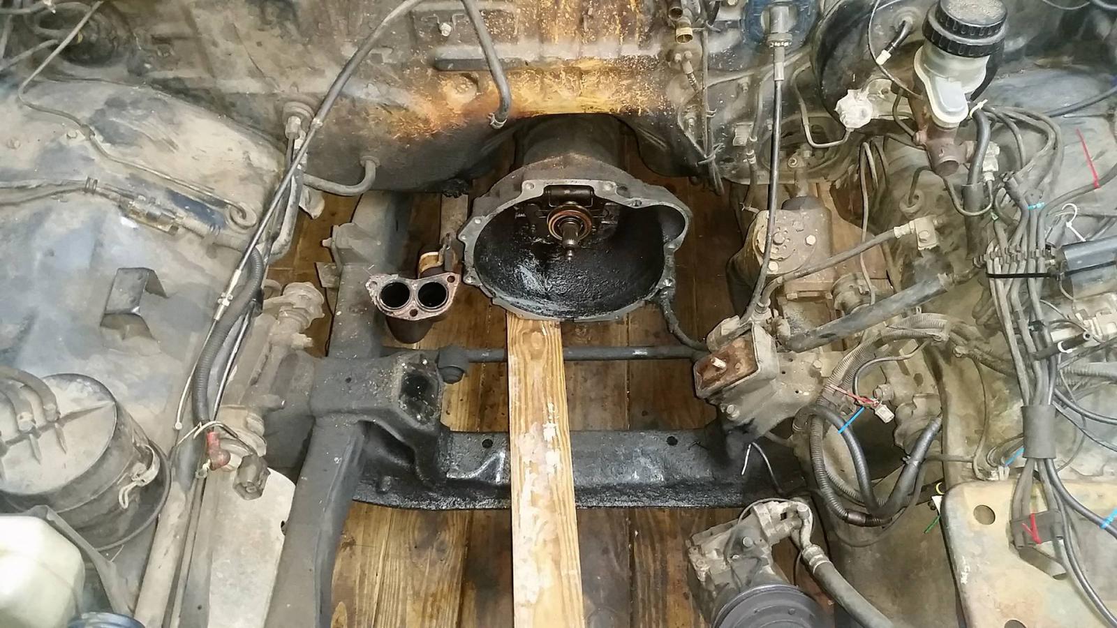

I started pulling the motor out of my truck today. Once I got to the disconnecting vacuum lines part I just left it alone until I can figure out what all I can throw in the trash since I'm going weber. Another thing I want to know about is what are my options on cylinder heads with the weber and weber intake. For instance if my cylinder head is cracked is it to much to ask for a head swap that makes good power and works with the weber intake. It also needs to not break the bank and get good gas mileage. hahathe truck is mainly for gas mileage anyway not a hot rod. Is 30mpg to out of the park for a weber swapped 2.0L that's 5 speed manual? Some say they run on hopes and dreams anyway others tell me out of a carb no way. Just in search of the best way to spend my money.
