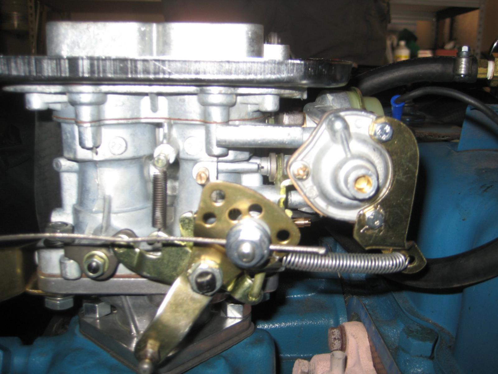

    Something like this ???
  19. #69
    I like the return spring bracket - never seen that one before...
  20. #70
    11-23-2013
    426
    pa
    The only problem is trying to fit the throttle cable through the hole in the linkage it just seems to be to big to fish through it. That return linkage above has to be fab. I've never seen that as well but looks like it would work .
  21. #71
    it is tight - the cable has to be cut with a needle file, not cutters to get a clean cut that doesn't flatten the cable. Geronimo has that cable clamp, but I used a ring terminal, looped it around the post, then fed it back through and crimped it. Never had an issue with it since.
  22. #72
    11-23-2013
    426
    pa
    I'll do that thanks as always pennyman.
  23. #73
    Having a look at the pics you've posted I'm thinking you should be able to use a stock Mikuni throttle linkage with a few washers to space it out on the throttle shaft (there should even be a spacer on the Mikuni that will do the job). You'll need to cut a few redundant parts off the linkage but it'll simplify the set up. It'll look weird with the back of the Mikuni linkage facing outwards but as long as it does it's funky thing, that's all that matters.
