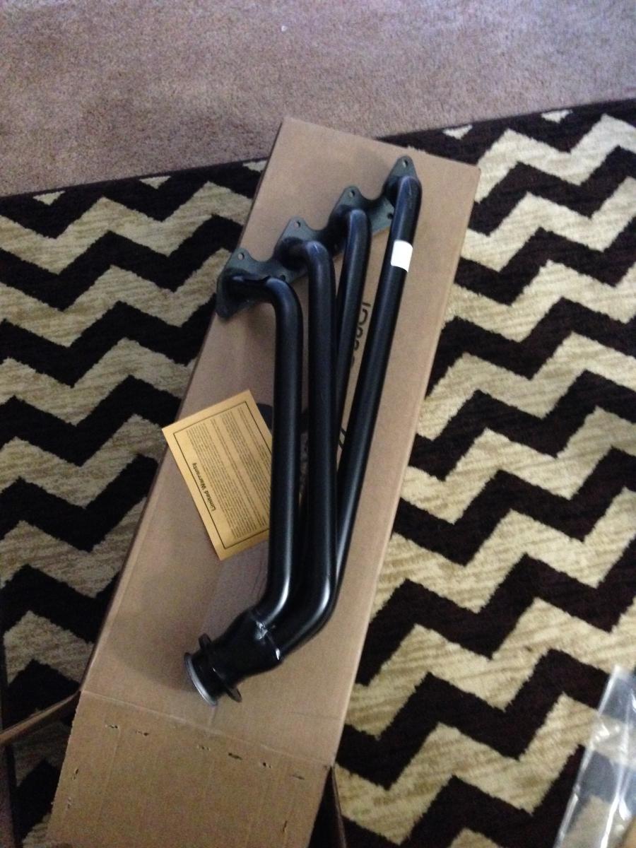

    Picked up the headers today from summit they look like a decent quality. I'm gonna strip off the paint and repaint them with high temp paint. the collector is bigger than stock exhaust so I'm gonna chop it all off.
    Is it safe to run these trucks without a cat or will it drop low end torque.?
    Im thinking 2-2.25 inch pipe off the headers ( I'm gonna just match it) back to a flow master or thrush welded. then 90 it in front of the tire.
    or would it be better for the truck to use a glass pack in place of the cat then a muffler?

    These are the pacesetter 70-1020 headers. I thought the quality would be much lower for 150$ but I'm happy with them its a 2.5 inch collector that connects to a 2 inch reducer
    2,801
    These headers will more than make up for any possible loss of torque. I would run a hot dog in the centre of the exhaust to act as a resonator and a glass pack at the rear end of system. 2.25" diameter set up will be near optimal for the 4G54. The catalytic converter should only offer 3-4% restriction on gas flow and have beans all impact on torque. This should be worth about 8-9 HP and some useful extra torque.
