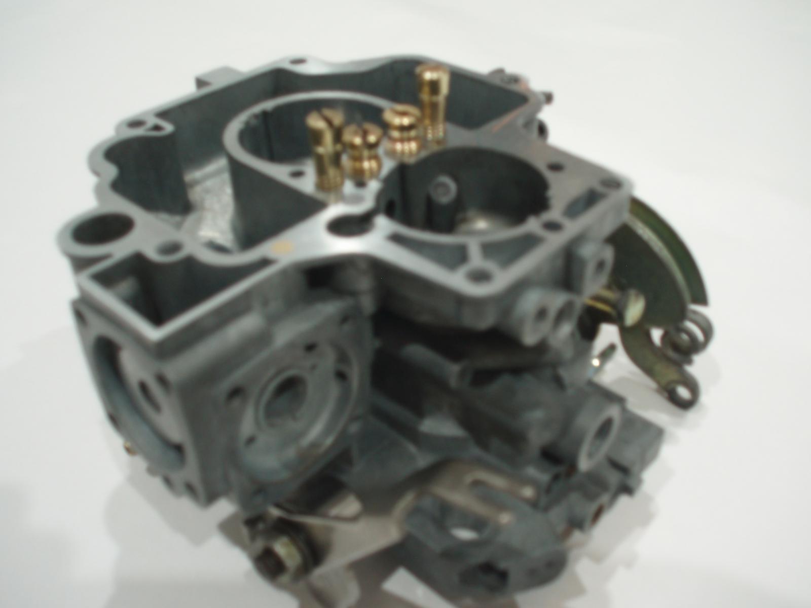

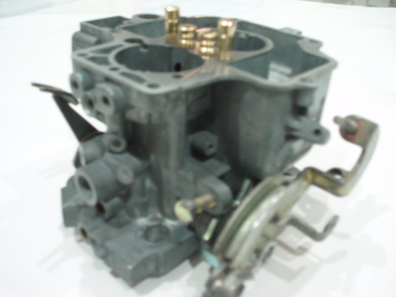

    So this is where I'm at on this thing. The top of the carb body showed signs of pitting and some distortion so I've refaced it using 400 grit paper wet on a sheet of glass. The emulsion tubes and main jets have been soaked in a citric acid bath and polished up. The throttle shafts aren't assembled completely at this point as I think I want to spend more time prepping it (the venturis have been smoothed out a little and the throats polished up) The original Mikuni throttle linkage works OEM. This carb was a mess - lots of gunk had gummed up the galleries and shafts, the auto choke was laggy but the fuel bowl was free of corrosion.
    The rebuild kit I bought for it is a good quality kit that has all the diaphragms and seals etc. I found this mysterious 'power valve' unit on the opposite side of the throttle linkages that I have no idea how it works, but it was clogged up pretty badly (there's a ball bearing check valve inside of it). No doubt that if the engine this Weber came off of was still running, it would've been running awful...
