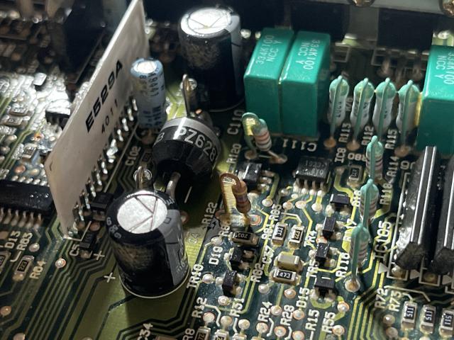

    Hi so I tore the Ecu out and after inspecting the circuit board I’ve notice a crusty yellowish film along the edges of the circuit board and around the capacitors just wondering if there’s a way to clean it or see if it’s still good and this is actually my issue.

    See photo post above, was caught in auto-moderation filter, just approved it now.
    The staining would indicate the caps have leaked. Luckily it hasn't eaten into the board yet...
