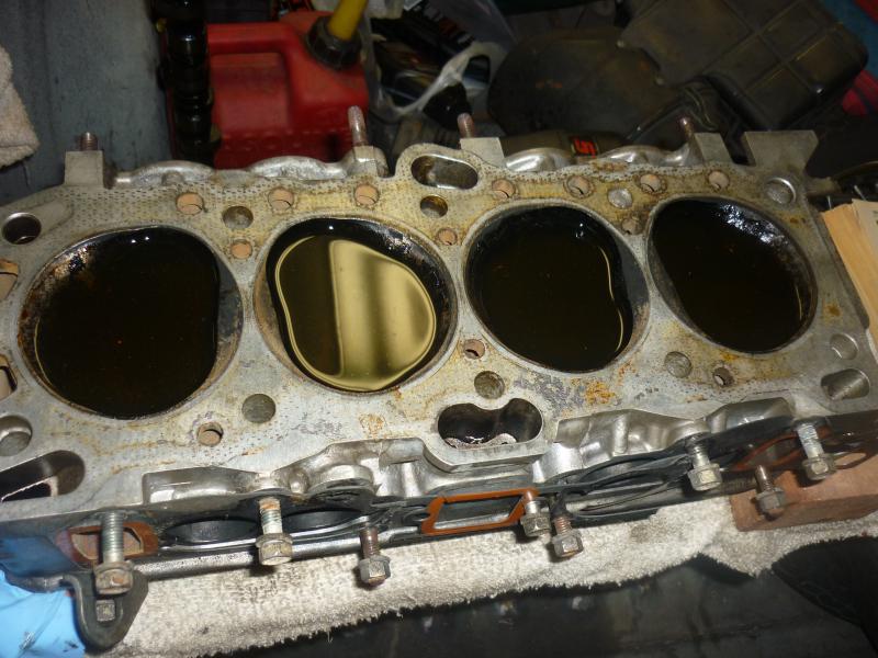

    Sooo. that's where I am at, at the moment. Engine out on a stand, head and everyTeardown Phase (25).jpgTeardown Phase (24).jpgTeardown Phase (23).jpgTeardown Phase (22).jpgTeardown Phase (21).jpgTeardown Phase (20).jpgTeardown Phase (19).jpgTeardown Phase (18).jpgTeardown Phase (17).jpgTeardown Phase (16).jpgTeardown Phase (14).jpgTeardown Phase (13).jpgTeardown Phase (12).jpgTeardown Phase (11).jpgTeardown Phase (10).jpgthing else removed. And I don't have a clue where to go next. Well, I do, but, lack of funds has put a stop to things right now. The head seems to need work, and looking at the pistons and cylinder walls, I don't know if I really need to mess with them or not.
    So if anyone can make sense of these pictures what do y'all think.
    1,270
    Hi Mitchi - we have the same year and engine, so I hope to be of some help.
    I doubt you need rings. Cross-hatching is obvious on the cylinder walls. Next post, please mention the mileage on the engine/truck.
    I noticed with #2 or # 3 on the cylinder head the carbon deposit that was prominent on mine, too. Turns out is was the passageway for the EGR valve, and it was completely packed with carbon. It runs through the cylindr head, and also through the plenum (air intake manifold) and the intake manifold as well.
    The gutlessness was likely in the various timing things, but since you have it torn down, give it all a good cleaning. Take the EGR off the plenum and clean out that carbon, too. Clean out the EGR valve, itself, and once clean, give it (the moving valve stem) a drop of oil. Give the device some mouth vacuum and see if it works properly.
    It's best to wait for other members to chime in, but likely several small problems have added up to one disappointment. That seems to be the way of these trucks, particularly when they're new to us. Many times, the previous owner drove the last few thousand miles with no service or care.
    I have a build thread, it might have some insights you can use, it's called "Roy's Garage" and it will help you with some photos and pointers. There's a lot of non-mechanical stuff, so you'll likely have to scroll through a lot of it to get where you want to go.
    This forum is a great life-line for just the kind of thing you're doing. Keep us posted on your findings and actions, and asking questions doesn't mean you're dumb: that simply means you need to know. Many here can help. I hope to be one of them.

    Man royster, thanks.................mileage I'll check and post when I get home from work tonight
    I was figuring on the cylinders looking ok. So pulling the oil pan was a little premature too i guess. Lesson learned.
    I did do the test on the head, taking the cam out and having all the valves closed, and turned up. Filled the cavities with brake clean first and within a few hours all the cavities were empty, someone, I think my brother told me that was too thin of liquid, so I used 5w motor oil and that took several days and the #1 cavity was the one that leaked out.
    So I'm guessing I may have some valve issues, but, the stealership told me it was #2 cylinder that failed the leak down test, and I did have to pull #2 plug and clean it on occasion, to get it to run a very minute little bit better.
    Thanks for the advise, and I will pull that plenun out tonight and start cleaning it and the EGR valve.

    If #1 is leaking, you might do well to remove the valves and see if one is warped. They're dirt cheap to replace, though I don't recommend replacing all of them. Increasing the compression with a tighter head will put pressure on the old block components...so don't do a valve job, per se, just replace any valves that are warperd or bent.
    Valve spring compressors are $20 at any auto parts store.
    Once you have the valve springs off, see if you can spin the valves in their guides. Probably not, but they're supposed to spin freely during normal use. A little cleaning gets them so thay'll spin, and you can watch closely to see if th edge appears to go up and down as you spin.
    Replacing the valve seals is a must, since you've gone this far, and from experience I'll tell you: do that on the bench while the head's out. Doing it with the head bolted to the engine is cumbersome.
    Clean out that whole EGR passage, through the head and manifolds. I used Seafoam spray, and let it set overnight. I used some wire to plunge the passageways, sprayed them with brake cleaner to really douche them out.
    Spend a couple bucks more and get the good head casket set: it will have additional gaskets and seal you will appreciate. Save the ones you don't use, like the water pump gasket and the silent shaft seal@ the oil pump.
    Out of necessity, I kept the hydrolic lifters in place with mechanic's gloves fingers when re-installing the rockerarm assembly: it kept them from falling out and dropping down the oil passages. I highly recommend stuffing rags or otherwise blocking the oil passages while working on the head, to prevent bolts and stuff from accidentally dropping down. http://www.mightyram50.net/vbulletin...ll=1#post26624
    And BradMPH recommends re-torquing the head bolts after 300-500 miles. I did this, and it allows you to also check on all the other components/bolts for good repair. Brad says the re-toques assures no blown head gaskets later on. I went with that suggestion.

    Nuttin wrong with using thin fluid to do a check. Water is used and I think some even used fuel. If it takes several days to leak through I wouldn't freak out on it. The oil is a little thick for testing IMO.
    I would suggest a valve guide seal replacement if you want something to do and dig into it. You'll need a spring compressor and get a valve grinder tool and some lapping stuff and the correct seals, and have some fun. You can check then if a valve is bent by the wear on the stems and the entire job is actually very easy to do.
    Leak down testing the pistons will pretty much test your oil ring seals though the ole compression test is the way to test compression rings and tells the story on the rating of each cylinder. This will help you to start your search on what place to look first.
    Nasty EGR valves get carbonized so bad with soot and un burnt fuel residue. You probably need a coat hanger or like a rifle barrel cleaner rod tool with the wire brush tips to clean the tube through the head. Depending on last time cleaned I'm sure you will get a pretty significant amount of black garbage.
    Check your cylinder walls for wobble scuffing. IN the photos It looks like I see some or it's the photo. Sometimes older engine will start to wobble the pistons a bit because of worn wrist pins. Though your head looks pretty decent and all look close to the same. Piston top edges look decent also, nothing too terribly different from others I have senn.

    Thank for the comments Brad........I actually did a compression check b4 the stealership visit,, and got:
    #1 = 150, 150, #2 = 150, 150, #3 = 150, 150, #4 = 160, 162.
    7 revolutions each.
    Tested twice.

    That's about the right price range. It should actually come with a set of valve seals. The ones I got were two different seals: one kind for intake, and another for exhaust. I found that the ones for intake (rubber) still allowed leaking, so I got another set (plastic). An additional $20 but worth the piece of mind, and also I haven't had smoke on start-up since.
    I don't think you need to send the head out for anything. I'm prone to tell you just reassemble a really clean engine and get what miles are left on it.

    I took pictures of the head with the cam out, and of the hole i think y'alls are talking about for the EGR valve.
    Man is that hole plugged. When I get to work tomorrow I'll post pics.

    I would take the head to a machine shop and have them check it out and magnaflux it to check for any cracks they will also clean it
    1,270
    RNMM makes a good point, there. Perhaps look into resurfacing, though if there was no problem with head gasket leaks, it might be more than necessary. I've heard the resurfacing isn't expensive, but can also be done on the shop bench, using a sheet of sturdy glass and some sand paper.
    When you get the valves off you can check to see if any of the valve guides have slipped down...I had two do that, and did have to send the head to a shop. Guy did a great repair.

    Here's the head, that hole in the 3rd one looks blocked for sure.

    The work looks terrific, nice clean up on the valve cover. Glad to see the rockerarm condoms are of use to you.
    The Coors can next to the car keys is a bit omenous: watch out for that. The laws for DWI get stricter every year.
    Your intake (not of beer, but manifold) is very different from my 4G64, as it appears to be four individual pieces. But the rest is quite familiar. It also seems your EGR goes into cylinder #2, whereas mine is in #3. But there is no question a good part of Jimmy Hoffa is wedged in there...not that Jimmy Hoffa HAD any good parts, I'm jus' sayin'. I have to suppose there were, after all, some differences in the Dodge and Mitsubishi models.
    All loking good, Mitchi, and thanks for taking the time to post pictures.
