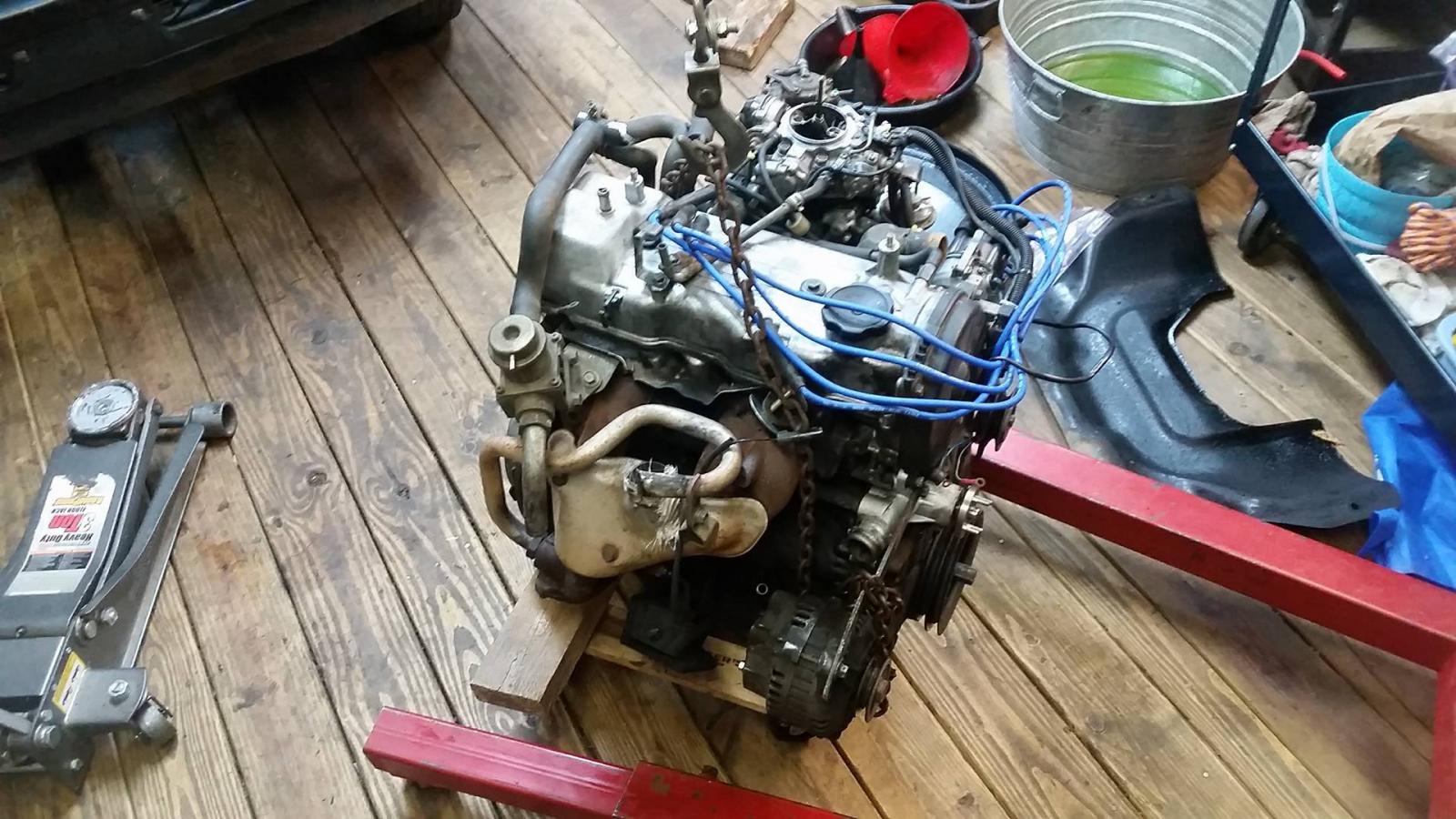

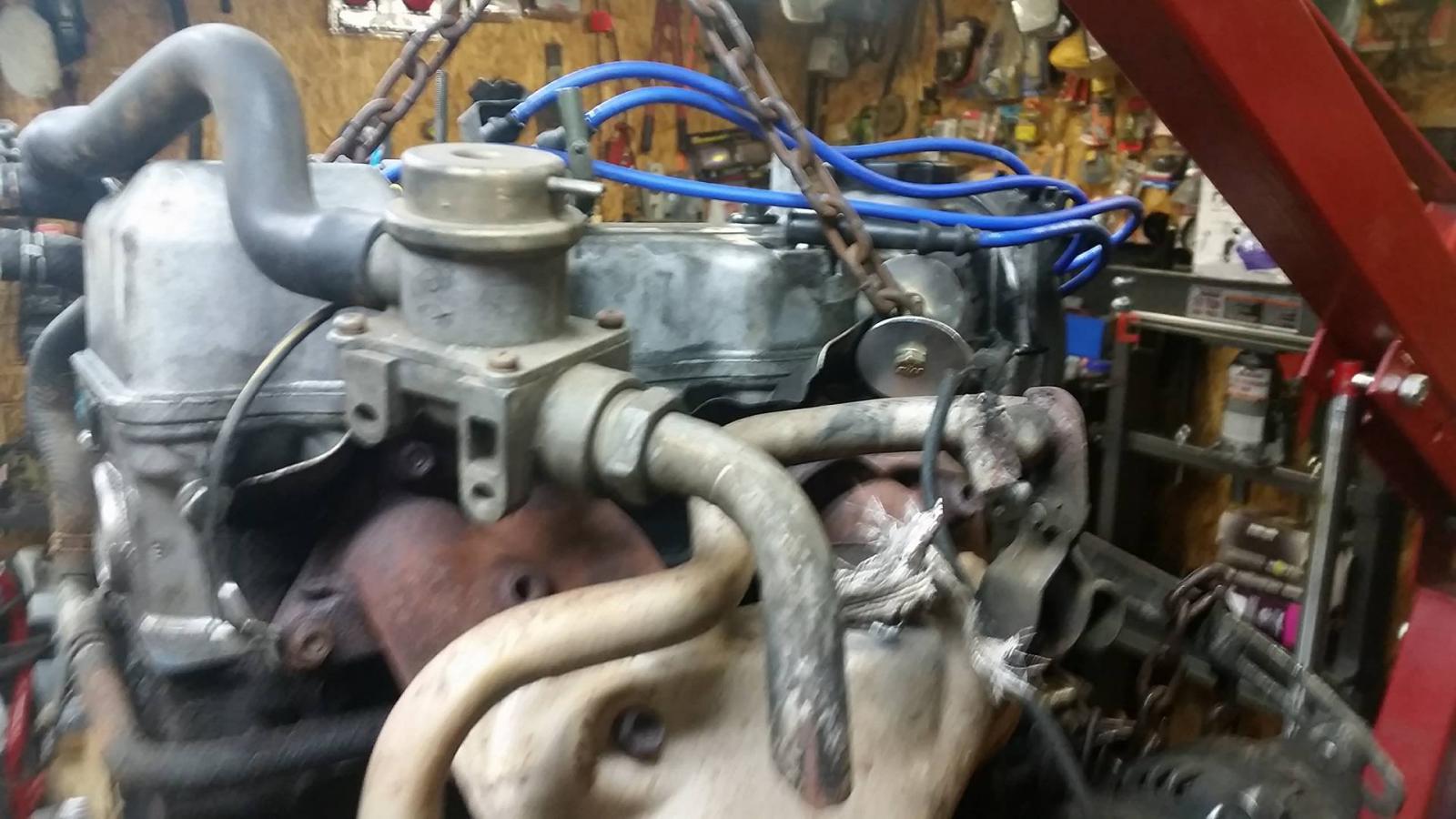

    I took the head to the machine shop today. The news was like taking a arrow to the knee. It is cracked between the valves on cylinder #3. In search of another head if anyone has one for somewhat cheap or where to buy one that would be a big help. Going to pull a part next weekend. These trucks seem rare around here. I got some pictures from the tear down if anyone is interested to see.
