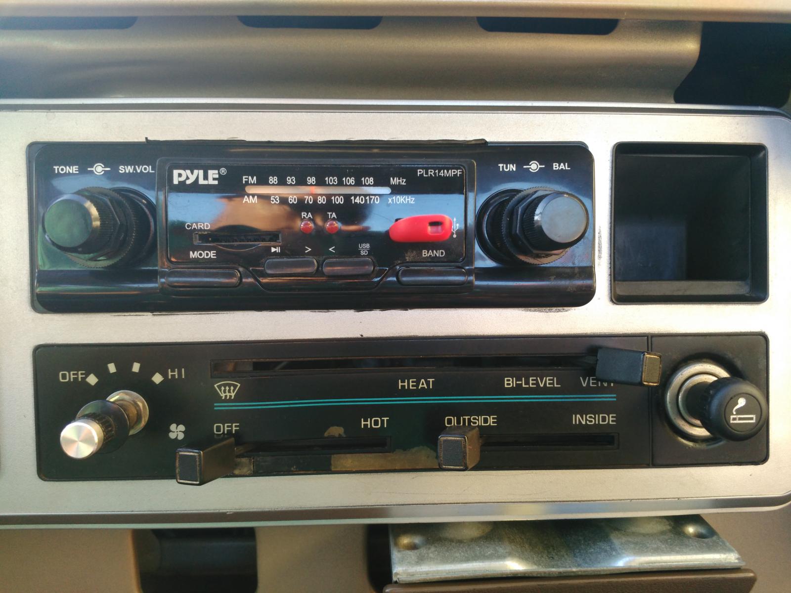

    First thing I did was pull off the rear bumper as I don't want one and well this one was damaged. I began working on the interior...pulled off the damaged dash pad, put in a new Pyle retro style radio, made new door & kick panels, redid the bench seat and got rid of the headrests, replaced most of the ignition system, plastidip the wheels and some other odds an ends.

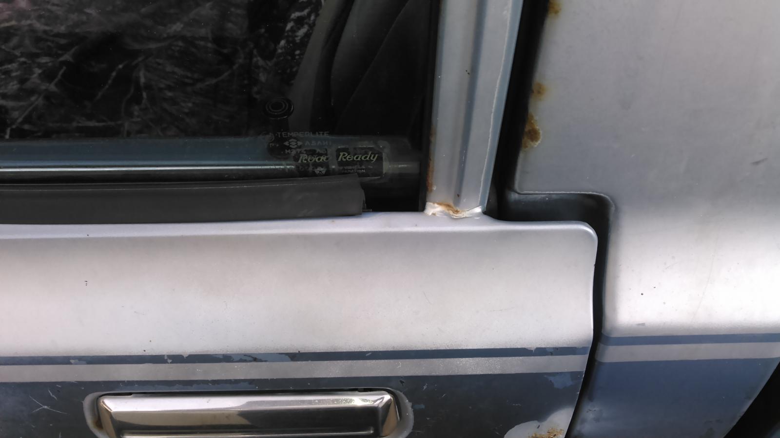

    Water is getting into my doors through the gaps between the door and the moulding that spans from the front to the back of the door. Then it trickles into the door she'll and into the cab. For the inner part I'm doing new moisture sheilds and lining the back of the new door panels with the same plastic material. However I need to do something about that moulding. Idk if that's how it's been from factory or the what but there's a good size gap between that and the front and rear of where the moulding goes.
    2,810
    I'm trying to figure out how the water is getting past the door seal and trim weatherstripping. You got a pic of the location?

    I'll take a pic tomorrow and post it.

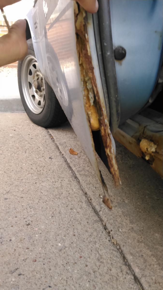

    I see your logic dna59. I can attest that those failed moldings will ruin doors. Not so sure on the cab though. Here's a picture of my window and then the results of gallons of water going through the door.

    if it is the window fuzzies you are missing, try Mike Warme on here, or get them from an 87 up Mazda pickup. If its the perimeter door gasket, steele rubber products reproduces them, or Mike may still have factory ones in stock
    2,810
    O.k. outer window seal is toast. Should be able to buy this stuff per foot/metre. Yeah, mine are as hard as a rock too and need replacing. I'm lucky enough to have a a few small suppliers around that should be able to help me out when I'm ready. btw Uncle Spence - that is one nasty door

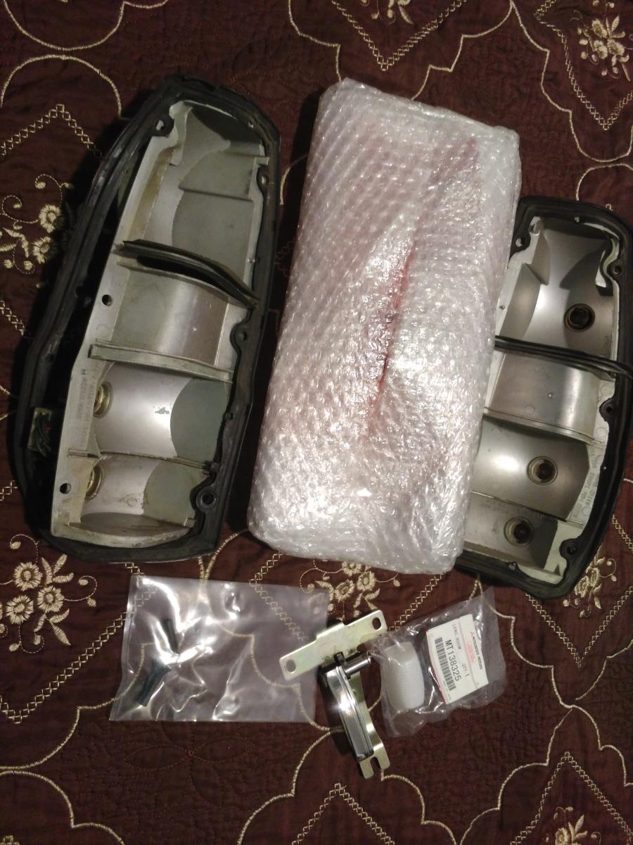

    Got my parts from Mike. Door handle, door knobs, lights and dome light cover.

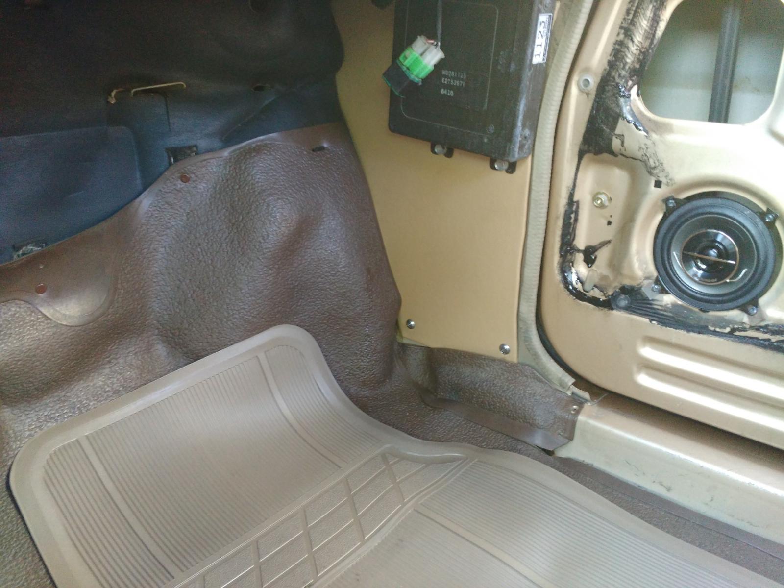

    Random pics of the H/U I put in, the speakers and kick panel. Now that I got the tail lights I can start doing some work on the bed until I can afford to get the other panels from Mike. Also think I'll put in some bigger door speakers.

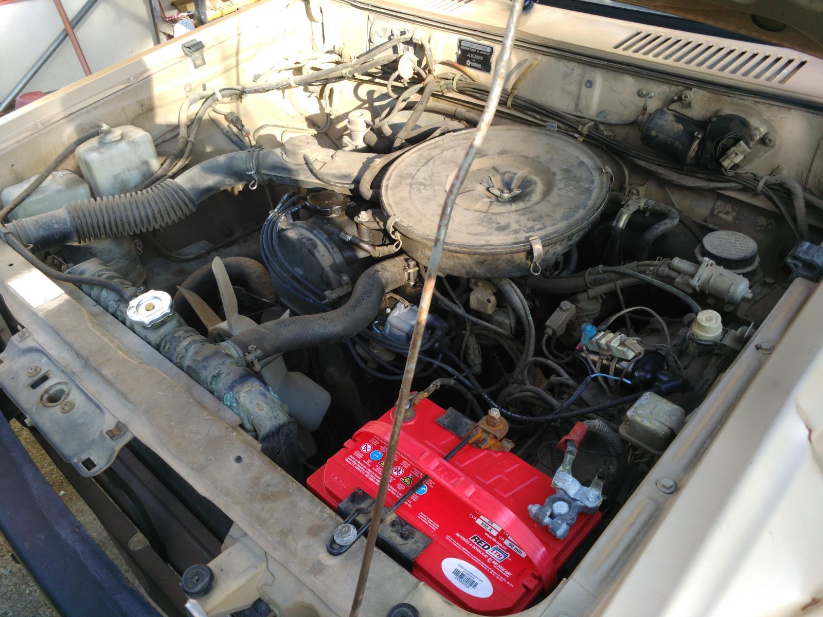

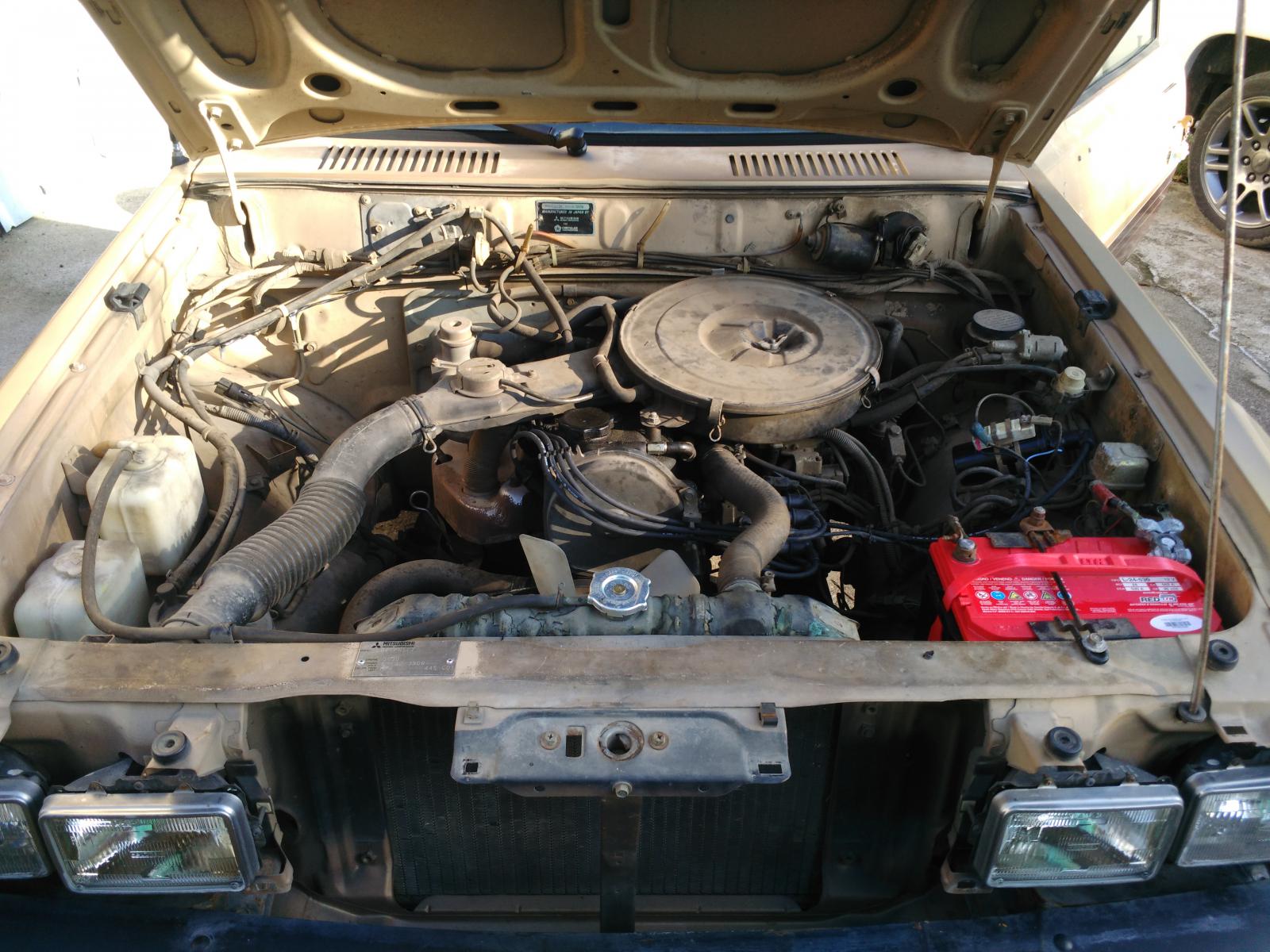

    ...and a shot of the dirty engine w/ new ignition parts and battery...she runs like a champ.

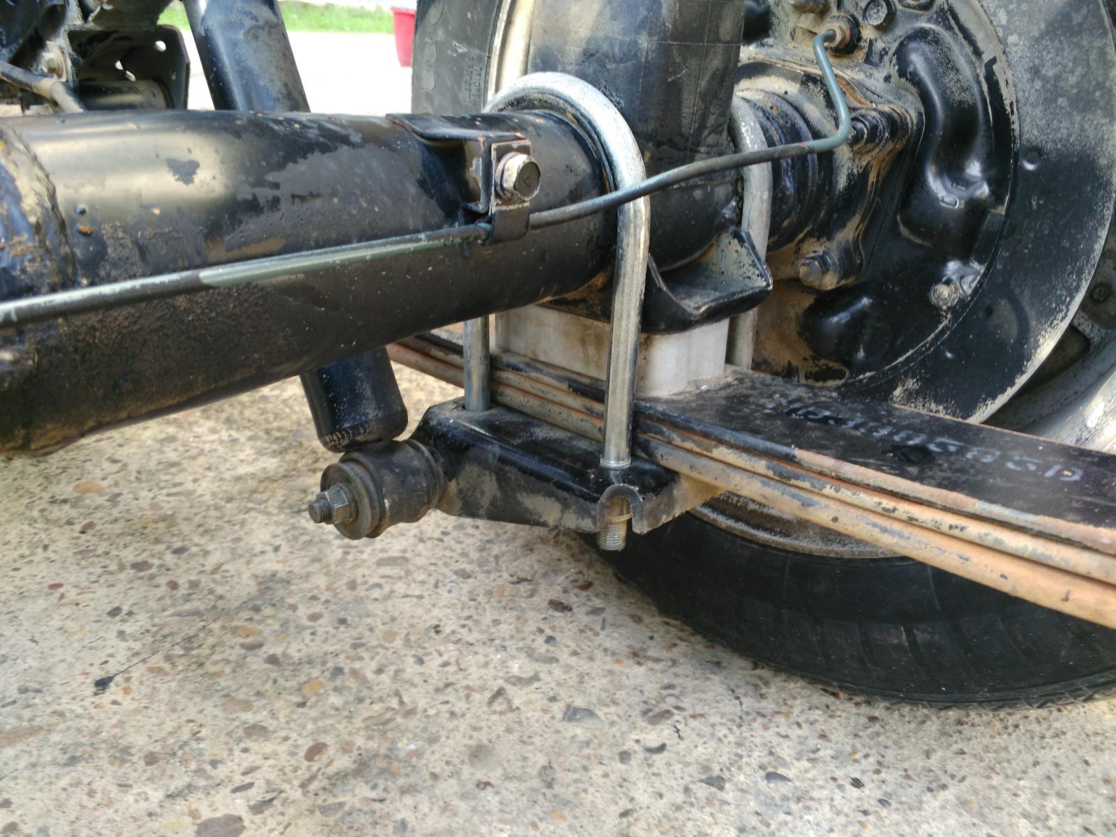

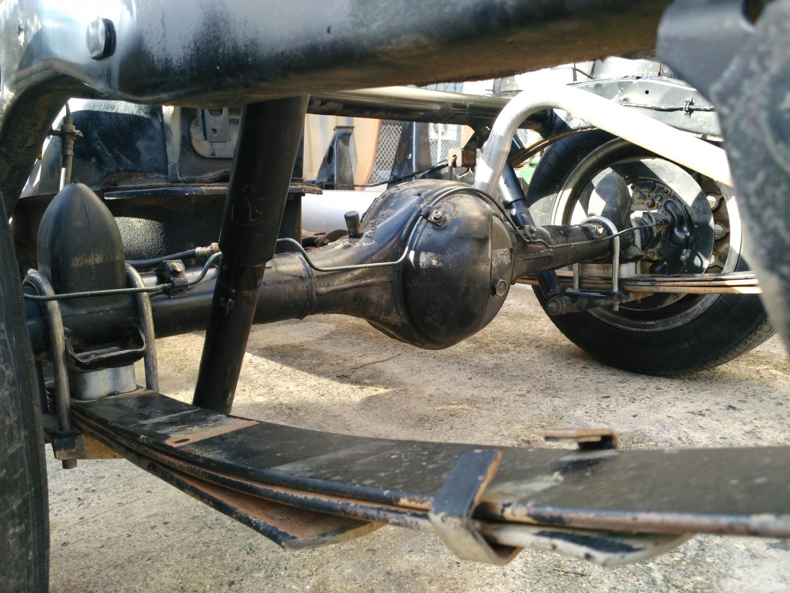

    Pulled out my 1" lowering blocks I had on my Colorado before I went to solid 2" billet blocks. I had to make the holes for the centering pin larger and I cut down the u bolts while I was at it. Got one side done and will finish up tomorrow and post some pics.
ID:	14909Click image for larger version.
