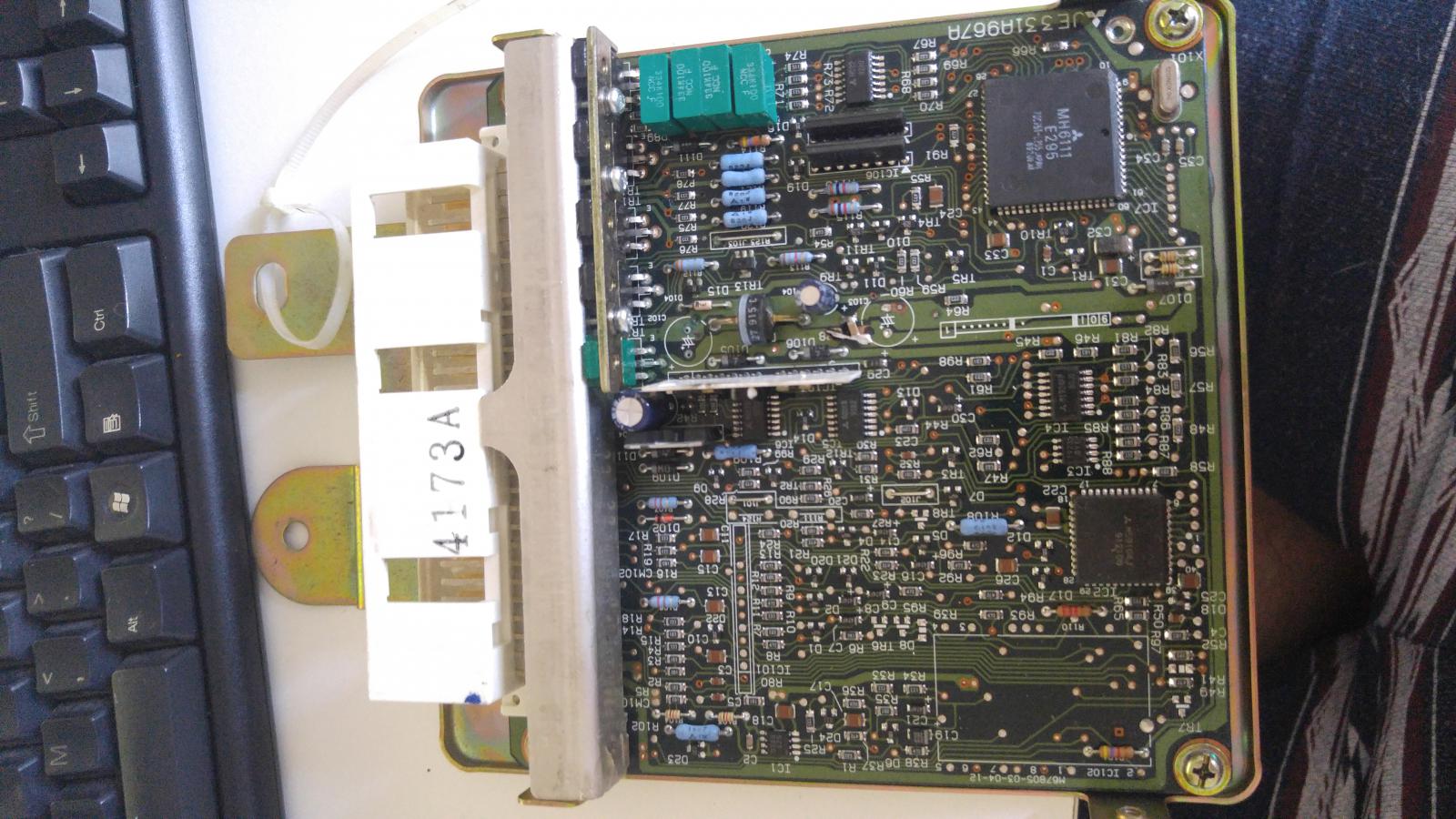

    Recently bought a beautiful 1990 Mitsu Mighty Max, shop said the ECU was bad but a visual inspection of the ECU board didn't show any scarring or anything concerning (def no popped caps). I went out to the truck with the ECU and plug it in and the truck cranks very well. I tested spark and I noticed I wasn't getting spark through the wires. So I replace the wires and plugs but still no success. Fuel gets to the cylinder as well as spark but I still dont have any kind of firing. Engine has low miles and its in pretty good shape but this issue is what parked it a couple years ago and it's been sitting in a yard since.
    The mechanic thought it was the ECU but I don't trust his opinion as he isn't a very successful mechanic. That being said after this most recent event I am suspect of the ECU again. Anyone whos had a ECU fail on these trucks, have you guys seen a similar issue? Crank but no fire? Everything appears to work and i've been slowing going through the ignition system and testing with a multimeter, it looks like most of the electronics are functioning. The only issue I found was a burnt out wiper blade so far. When I turn the key I get a click from the ECU (or that other control box down there) and it really wants to fire but something is just missing. Ive also check most of the fuses, the ones on the battery lead and in the cab for sure.

    ECU is probably the #1 thing to fail on the early FI trucks. Failure can be catastrophic, like melted circuit board or invisible like solder joints cracking and the electrolyte inside the caps degrading over time. I'd get it remanufactured. There are a few threads on where/how to do it.

    Here's some pictures of the ECU inside and a video to the no crank. The buzzer is loud AF and I have since ripped it out. 20150926_095050[1].jpg20150926_095101[1].jpg20150926_095130[1].jpg

    these ones.
    12-13-2014
    210
    redding ca
    your ecm is missing some caps, thast probably the problem.

    Thats crazy, no one had ever opened it before me and I didn't have any broken caps fall out. Ill have to look for a stock image but I dont know if im going to get one. I should plan for a new ECU either way.
    Oh craaaap. I have never heard of capacitors going AWOL. They should've been floating around inside the ECU casing doing even more damage, so there's something fishy going on with this ECU. My bet is those were the non-functioning capacitors and this thing was sitting on a bench waiting for new ones to be soldered in - and some tool forgot about it and sealed the case back up. If you can find the corresponding value caps this ought to be an easy fix.
