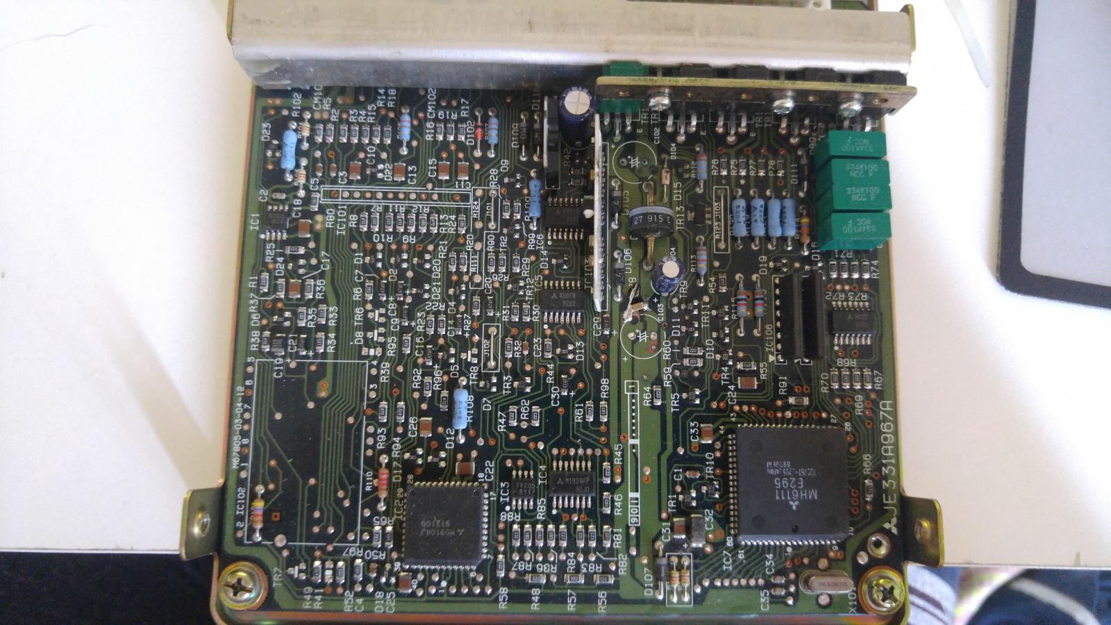

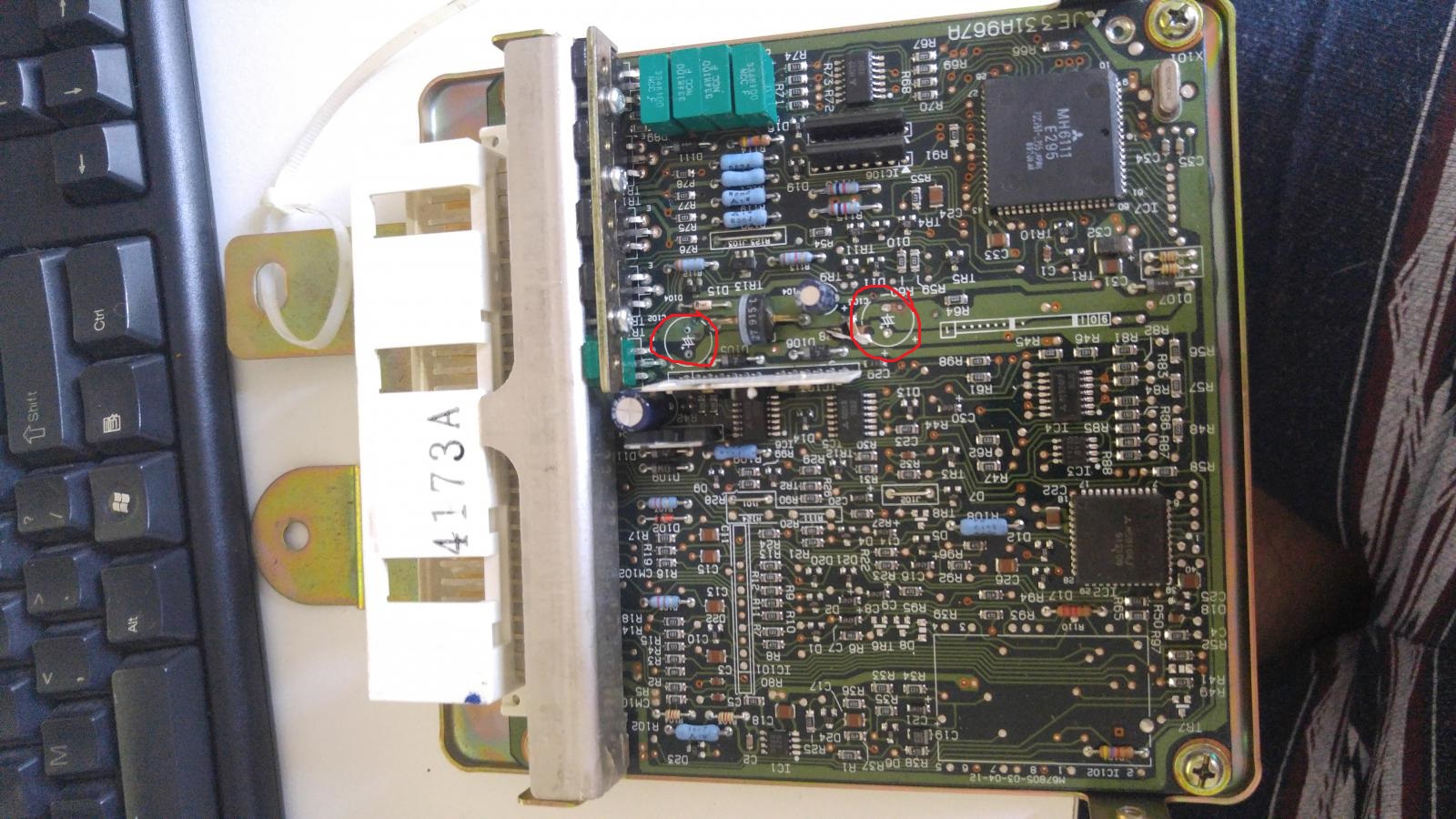

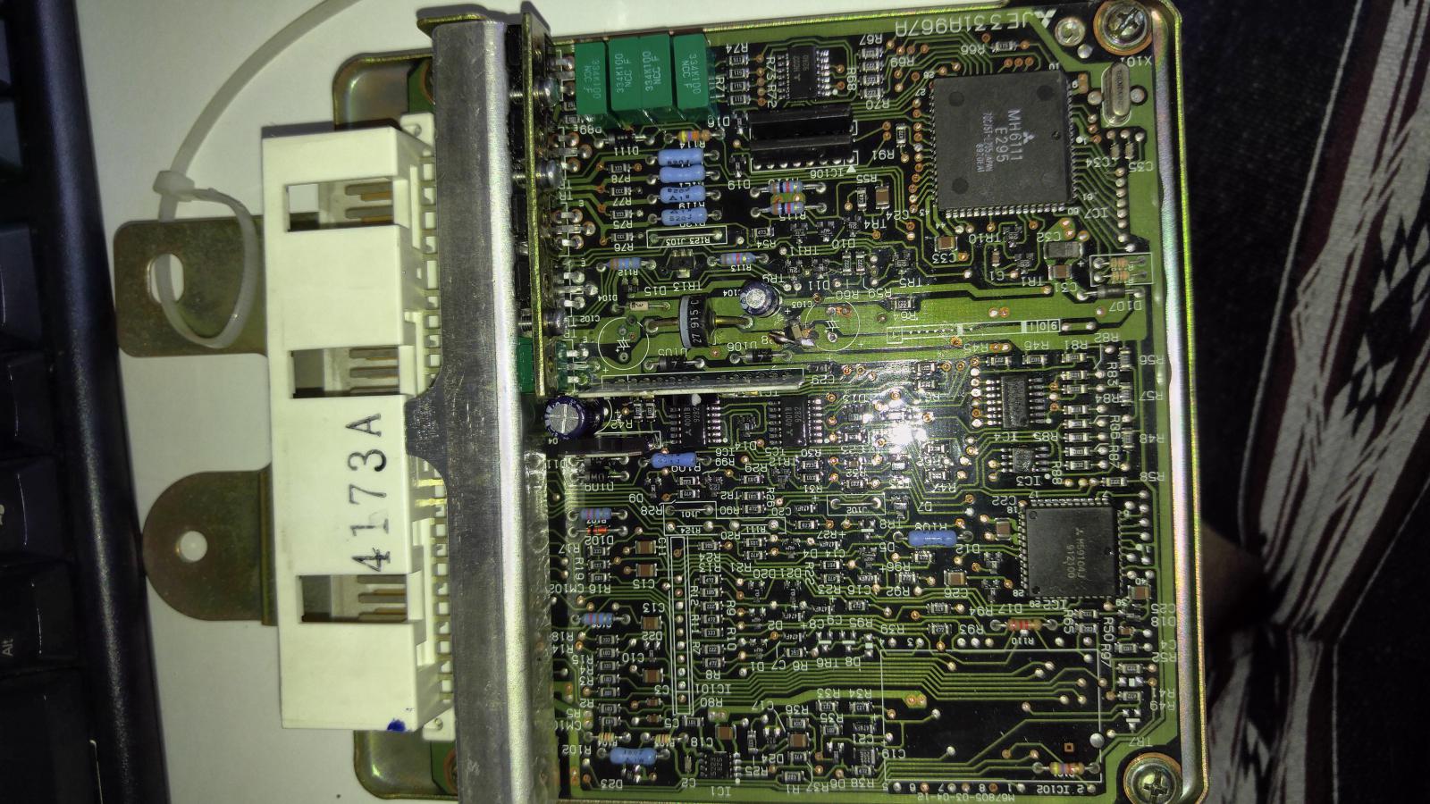

    Here's some pictures of the ECU inside and a video to the no crank. The buzzer is loud AF and I have since ripped it out. Click image for larger version.

    2,810
    If you are going to re-use a timing belt it has to have relatively low mileage on it and it has to be installed the same rotational direction from which it was removed. Belts are cheap enough and the only reason I could justify using an old belt is if you were in a jam and couldn't get your hands on one. And camoit is right about getting timing belt installs wrong. If someone thinks setting the timing up on it simply means having the alignment marks facing upward it's not going to turn over. I got caught on a 1.8 Family II engine where the bottom pulley alignment mark was this tiny pointer sticking out of timing case at 2 o'clock. Til I spotted it, this thing kept popping like a lawnmower with the spark plug out of it.

    your ecm is missing some caps, thast probably the problem.

    Thats crazy, no one had ever opened it before me and I didn't have any broken caps fall out. Ill have to look for a stock image but I dont know if im going to get one. I should plan for a new ECU either way.
    2,810
    Oh craaaap. I have never heard of capacitors going AWOL. They should've been floating around inside the ECU casing doing even more damage, so there's something fishy going on with this ECU. My bet is those were the non-functioning capacitors and this thing was sitting on a bench waiting for new ones to be soldered in - and some tool forgot about it and sealed the case back up. If you can find the corresponding value caps this ought to be an easy fix.
