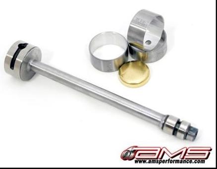

    4G63 High Performance Balance Shaft Eliminator Kit
    AMS 4G63 RACE BALANCE SHAFT ELIMINATOR KIT - NO CORE REQUIRED
    Features
    •Less rotational mass frees up horse power
    •CNC machined for precision
    •Added oil pump gear support
    •Proven performance
    •Core is Required
    Kit Includes
    •AMS spec CNC Machined Race balance shaft
    •Clevite Balance Shaft Bearing
    •Block Off Plug
    Specifications
    •CNC machined
    •Moly/Graphite treated TriArmor bearings
    Applications
    •Fits all 4G63, G4CS and 4G64 blocks.
    Core Info
    •These kits are sold on a core exchange basis, the kit can be bought outright for $349.95 but if you can send in your good condition stock balance shaft then the price for the kit is $199.95. We cannot send the kit until the core is received and inspected. If you order the shaft and will be sending in a core but we haven't received it yet, you will be charged the $170 core charge. Once we receive the core and it is inspected and deemed okay, we will refund the $170.
