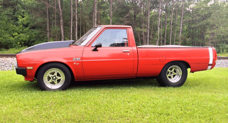

    I did the Toyota swap on the front and a 9 in. Ford rear end swap.
