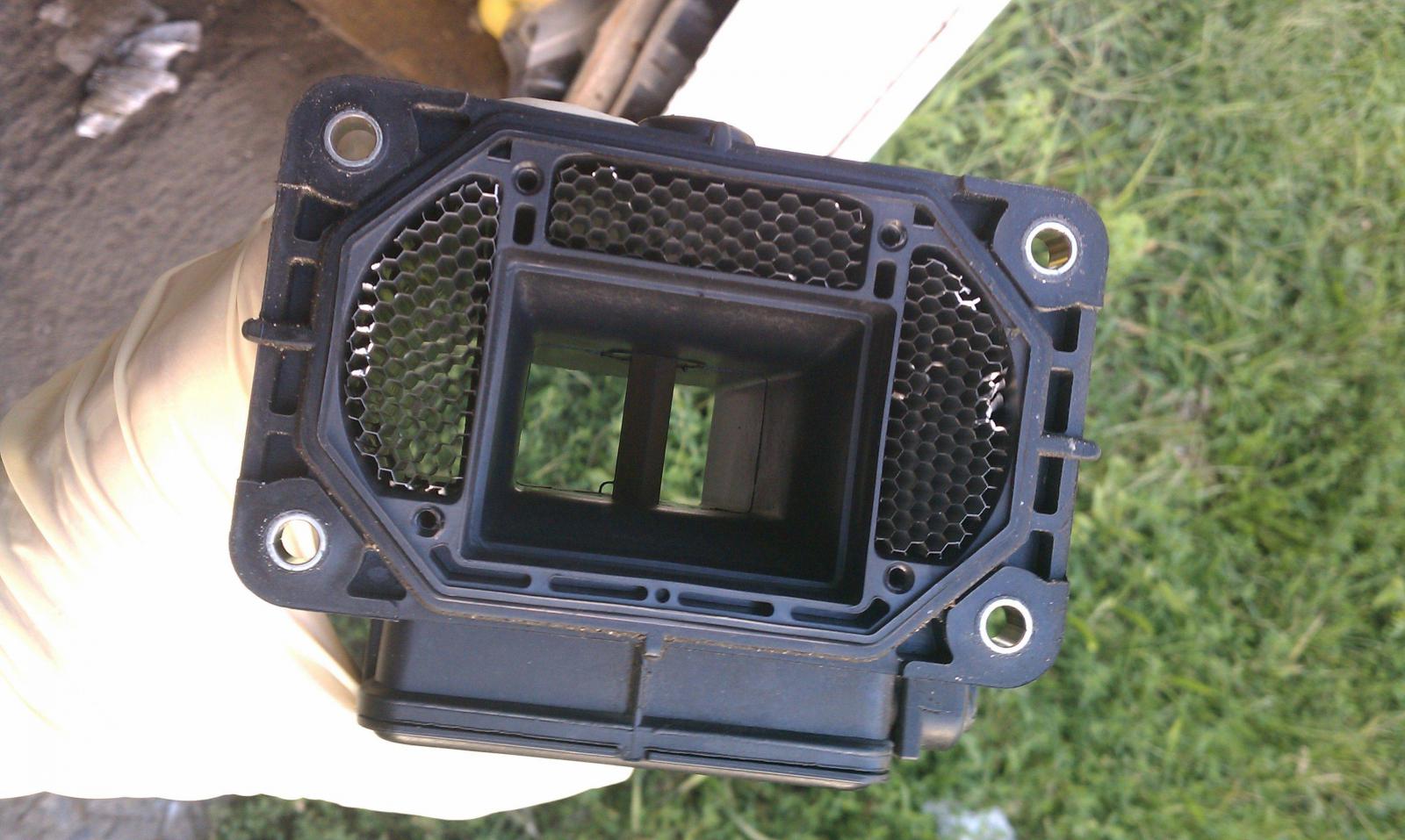

    My mass air glow sensor died on the way home from work. Can I get one off another mitshubushi car as there are no mm or ram 59 cars around here.
    06-27-2015
    424
    Bothwell,Ontario
    Dodge V8
    I stood on the gas then the engine quit. It would only run with the mass air sensor unplugged.
    I'm assuming that it has failed.
    What I don't understand is why it failed when I stood on the Gas...rge revs were down and not even a lot of air would have gone past the sensor.

    I just checked the air flow sensor on my truck and it is off of a mitsh expo with a 2.4 litre.
    Looks like mine has been replaced in the past.
    Would a 2.4 in an expo have different mapping than a ram 50.
    The replacement air flow sensor is really cheaper and still available.
    E5T05171
    06-27-2015
    424
    Bothwell,Ontario
    Dodge V8
    It even has a different cardone part number 746001 and the proper one for my truck is 746009...
    I'm really curious what the difference is.
    They are both vortex air flow sensors..mount the same and the same engine.

    I got the new sensor and immediately the truck drove better...it seems to have fixed the idle issue and now it makes sense that probably it was dumping fuel in every time it got a bad reading.
    cardone really butchers the case to get them apart to change the internals.
    The check engine went right off.
    I'm thinking off opening the old one to look inside if anyone is interested.
