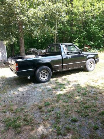

    just saying hi!! finally got my hands on one of these awesome trucks in a trade!! right now he runs rough and tires all ate up, but he is pretty clean. gonna make him a solid dd and possibly turbo head swap in the future...plans for now is a timing belt and reseal for most of the motor, energy suspension bushings and moog suspension parts, and maintenance stuff...i actually have my timing belts off and having a hard time getting the oil pump cover off. i have everything unbolted and it slides like it wants to come off, but it only slides about 1/4". does the oil pan need to come off all the way?
