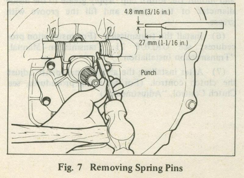

    Now what shaft are you talking about. The clutch arm? FIG # 7
    its number 1 on the trans side of things,but so theres no confusion its the red thing in the picture

    To remove the shsft that the "Big RED Thing" is part of, you drive out the 2 Roll Pins with a hammer and punch.
    They're located in the Center Section that attaches the throwout bearing fingers to the shaft

    thanks,i ended up getting it out,just hard to get a good look at it lol i got the new trans waiting to go in,and i pulled the pan on the old trans and found a couple chunks of senchronizer(sp?)
