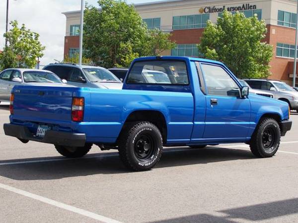

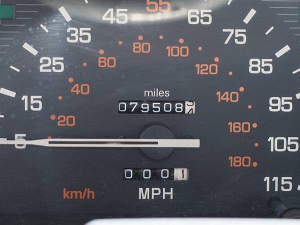

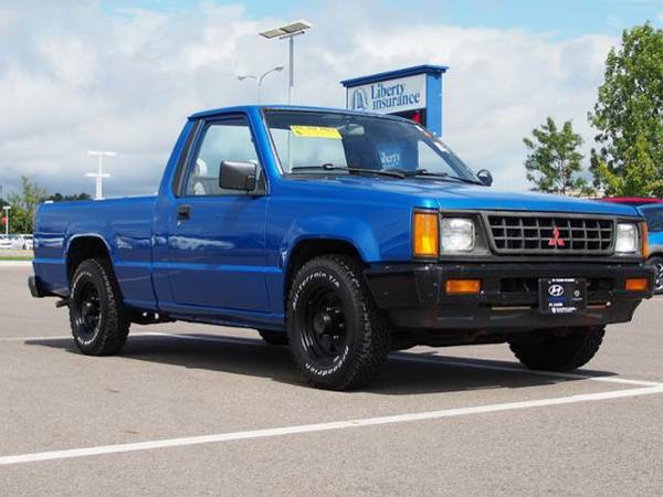

    Thought I'd introduce myself here. I just picked up a blue 1991 Mighty Max base 2.4 auto regular cab with 79K on the clock. From FL and made it's way up here and it's a beauty! I have a small shifting issue I hope to resolve soon, but I'm excited to continue to take care of it and have a blast!
