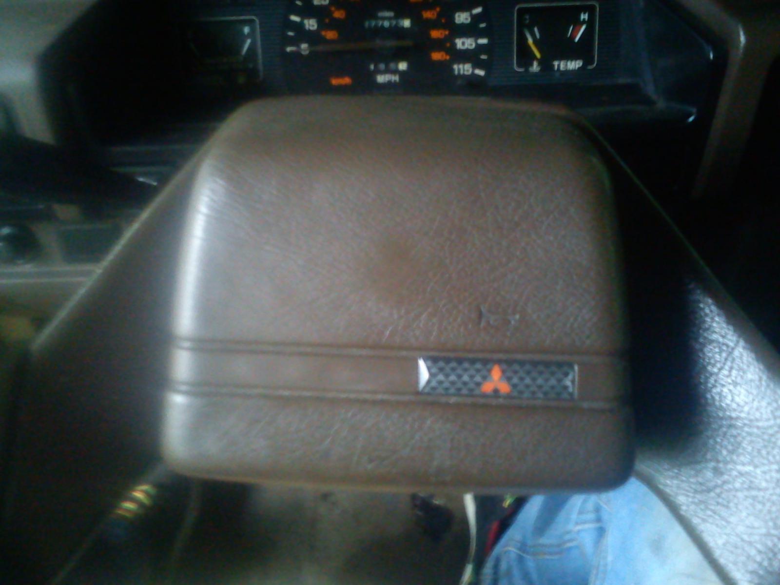

    hi... i have a 1988 mighty max.... i've dismounted the gauge panel, and for some reason the fuel and temp gauges doesn't work anymore... anybody has the wiring diagram of these components? please send me to my e-mail... thanks and greetings from costa rica
    PD: I haven't the stock engine (G54B)... my MM has a HYUNDAI D4BX DIESEL engineDSC01483.jpgDSC01484.jpgFB_IMG_1408823160845.jpgIMG_20140820_164527.jpg

    Make sure your gauges are grounded and that you didn't disconnect the connector for those gauges. Sounds like you bumped something and pulled a wire out. These trucks can have wiring issues, but yours happened after you removed the cluster. I hope your also saying it doesn't work since you put it back in, because if it is out, there is an obvious reason for not working, lol.
    Need to be careful when working on items like this because the parts and electrical on your truck is 27 years old. I have done things like that before, biggest problem is taken it all apart again to diagnose a possible disconnection.

    Not an expert in electrical but since it is not the stock motor could be phased / frequency problem of electronics from new motor. This is where you / I typically throw some one under the proverbial bus I.E.. Pennyman not to mention any names of course to chime in (cough! cough!)
    In this case, I would look for the obvious first - loose plug on back of cluster, cracked traces or cold solder joints, or loose ground to dash. Then check the plug itself for any wires coming out of the plug. Thanks for the tutb - I needed more tire tracks across my back...

    On the back side of the cluster there is a small metal box. Check for power going in on one side. On the other side it will be a lower voltage and it's pulsed. That is what makes the power for the temp and fuel gauge. Or at least that was on the back of mine.

    Fixed guys, the resistance (7 Volts converter) are broken.
    Diy fix with a new voltage converter.
