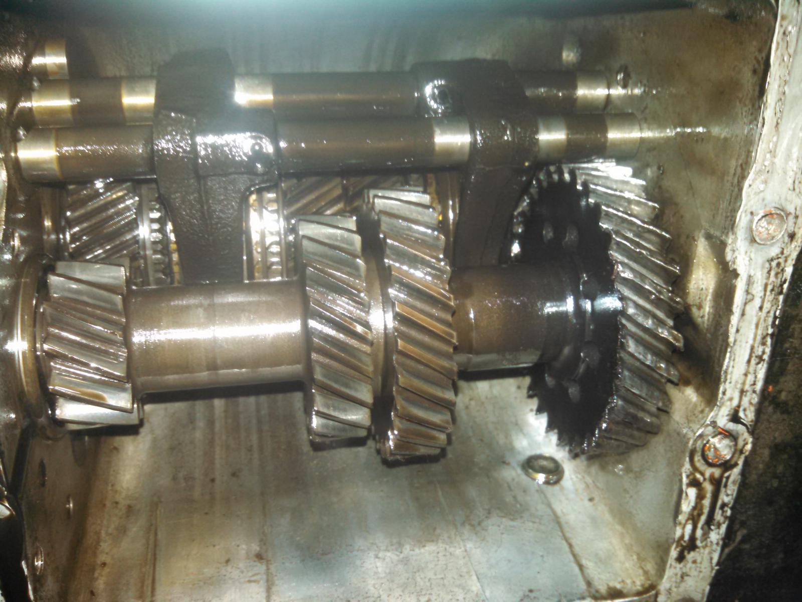

Name:	mitsu ram50 trans gears.jpg
    02-12-2015
    31
    Athens, Georgia, USA
    1984 Mitsubishi Mighty Max
    4D55
ID:	15425Just pulled the transmission out of my '84 KM-145. The trans actually locked up pulling out of the driveway. I got it out of gear but the damage was done. Turns out the PO had rebuilt the trans and forgot to put gear oil in it! When I drained it about 3 ounces came out with a lot of metal dust and broken pieces of gears. Any recommendations? Rebuild or replace with a used trans. I found a couple within a hundred miles for under 300. SWB Montero 2.6 has the hydraulic clutch that I need, right? Thanks for your time!
    2,812
    Quote Originally Posted by maxslack View Post
    ...Any recommendations? Rebuild or replace with a used trans.
    Your trans is trash. After new gear sets, synchros, bearings and seals it would be cheaper to buy a whole truck for parts. I'd honestly source another trans. Good thing is that these parts are available (obviously as they were installed by an idiot before you got it). Not what you want to find out. It must've sounded like driving a WW2 tank without any gear oil in it

    I just found a 1987 Montero sport 4X4 5speed trans and transfer case from a low (80K) mile rig for $250, and it was only 20 miles away! I'm going to put in in this afternoon. Yeah!!!
    02-12-2015
    31
    4D55
    Got it in and it works great . FYI: The transfer case shifters are NOT interchangeable. The 5 speed stick on the montero/raider works but is a couple inches taller.
