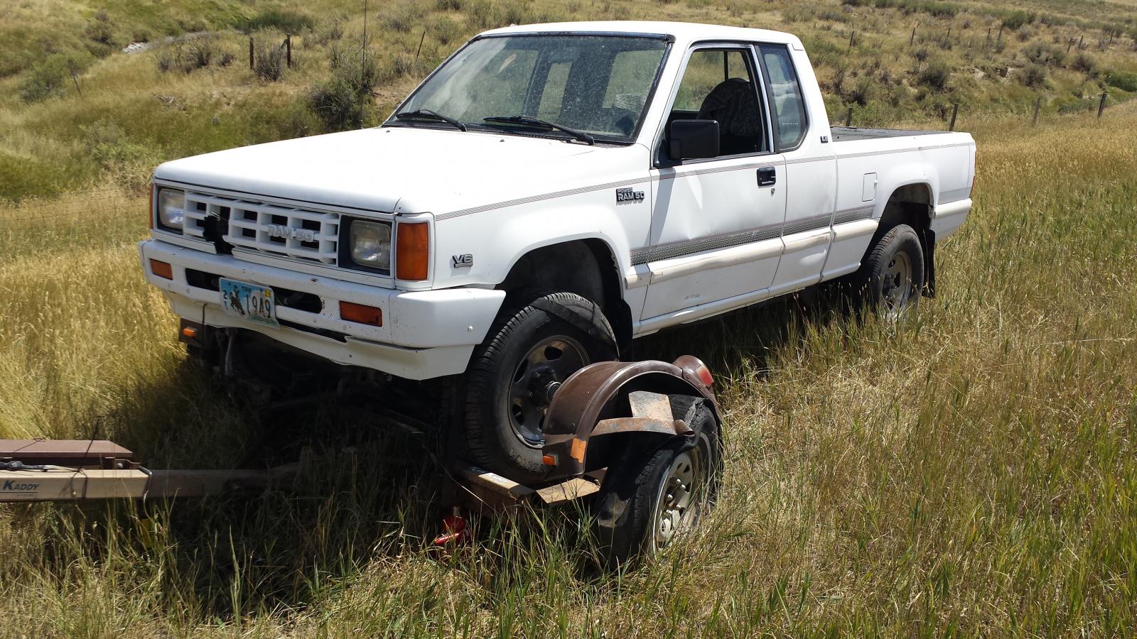

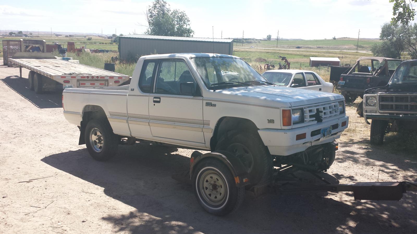

    The story on the survivor 1991 Power Ram 50 started as many other car purchases do… Craigslist. A gentleman who owns a scrap metal business in Douglas, Wyoming posted the truck online parting it out. It looked very sad in the add, because it sat on all 4 disk/drum brakes on the ground with no wheels. I immediately recognized the body color painted grill and bumper, and then knew it was an option loaded Ram 50. So I called the guy and was on my way with a tow dolly and 4 wheels to buy the pickup.
    When I arrived after the 200 mile trip, the yard owner told me that I was lucky I had called as he was about to crush the truck the day I called because no one had called or had interested in any parts. Yikes! The Ram50 was saved by the bell, literally!
    Upon further inspection I was immediately excited! Besides the remarkable good condition of the V6 truck and no rust, I noticed the orange sticker with the factory Limited Slip Differential, bucket seats, cruise control, ABS brakes and factory Power windows & Locks! (I did not even know that power windows/Locks were an option for USA import trucks). All other usual options were also present: AC, rear slider window, locked glove box, four speaker system, bed cargo lamp, center console, full cab plastic paneling, V6, 5 speed, and of coarse the Micro Cab.

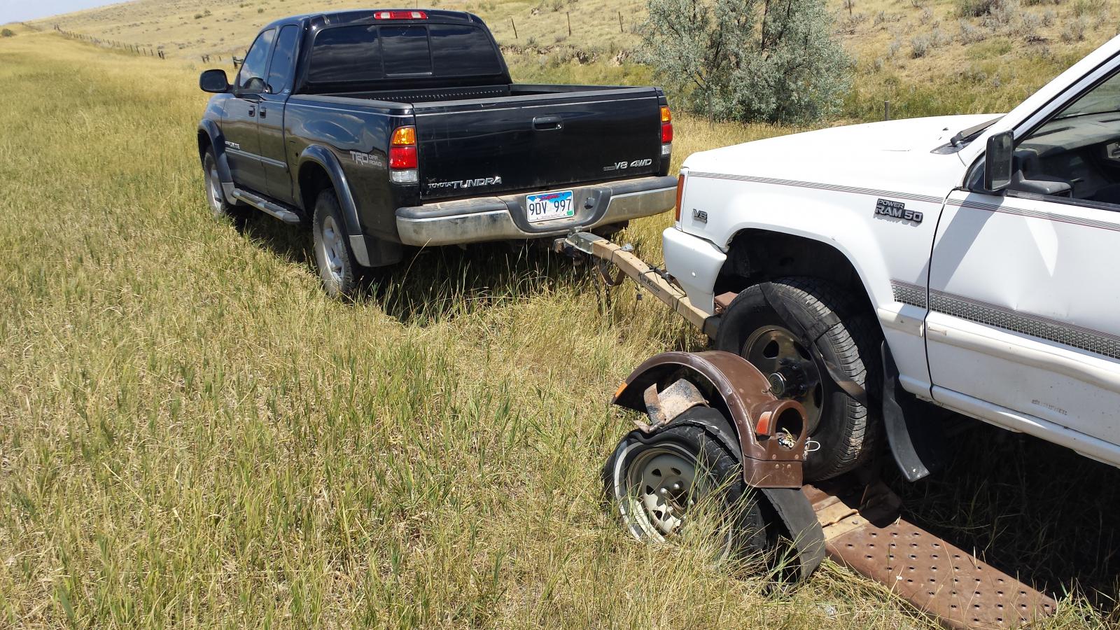

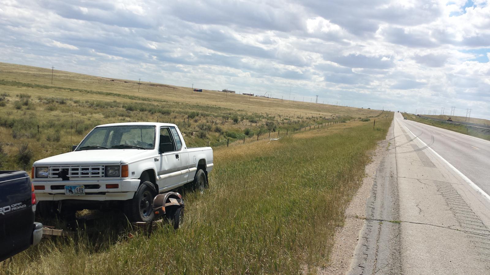

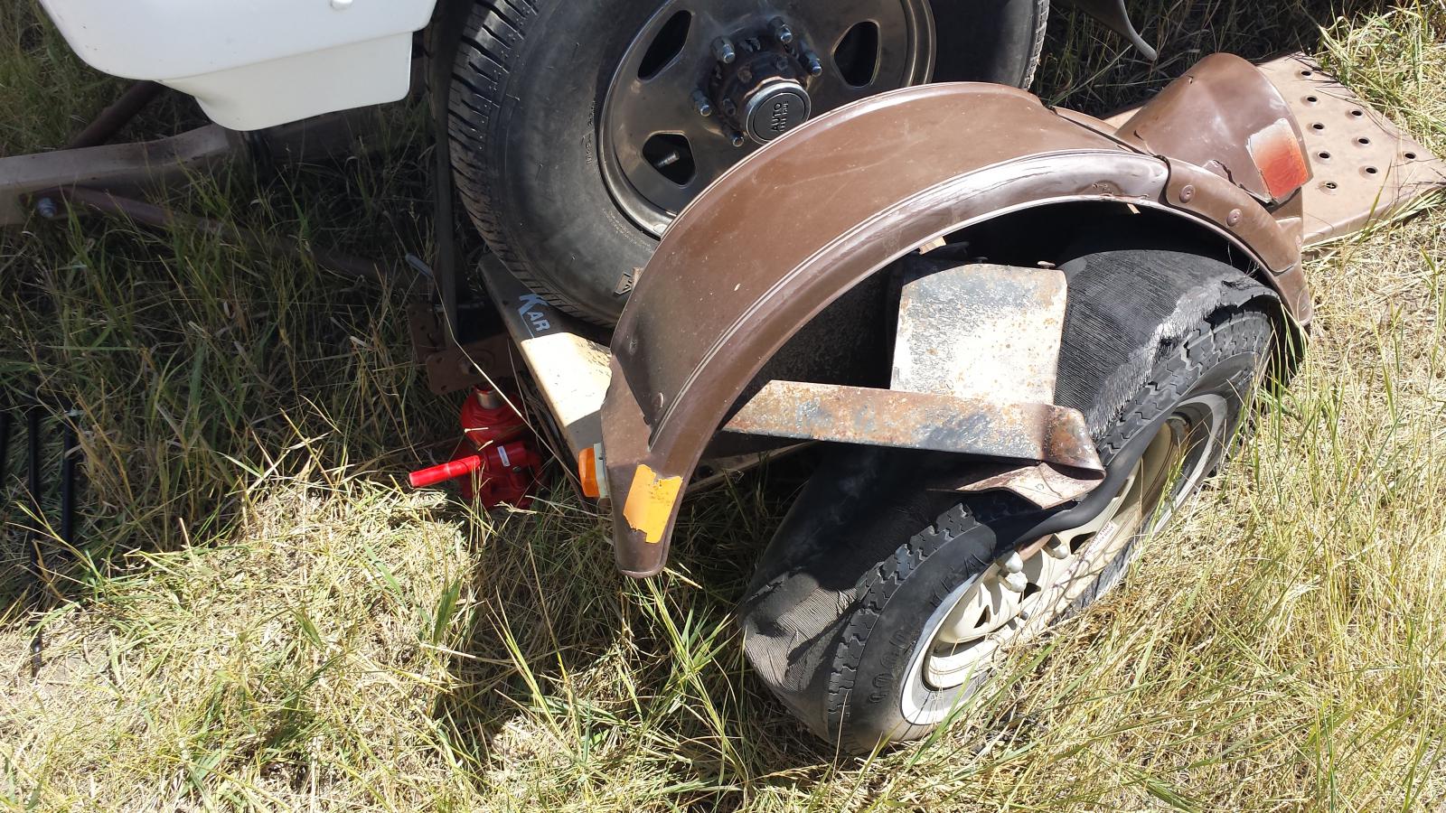

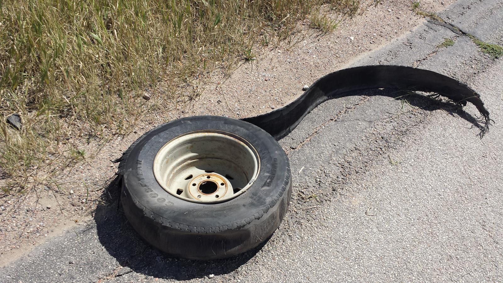

    I loaded the truck on the trailer and headed home from Wyoming to South Dakota. About 45 miles into the trip back, the tow dolly trailer blew out a tire at 75mph, and almost rolled the Ram 50 and my 2004 Toyota Tundra with it. With some skill, luck and thanks to the new tires on the Tundra, I managed to keep the rig under control and save the trucks. I then hacked the scrap fender off on the side of the road, changed the tire on the trailer and kept on trucking home. The RAM 50 once again escaped its demise.

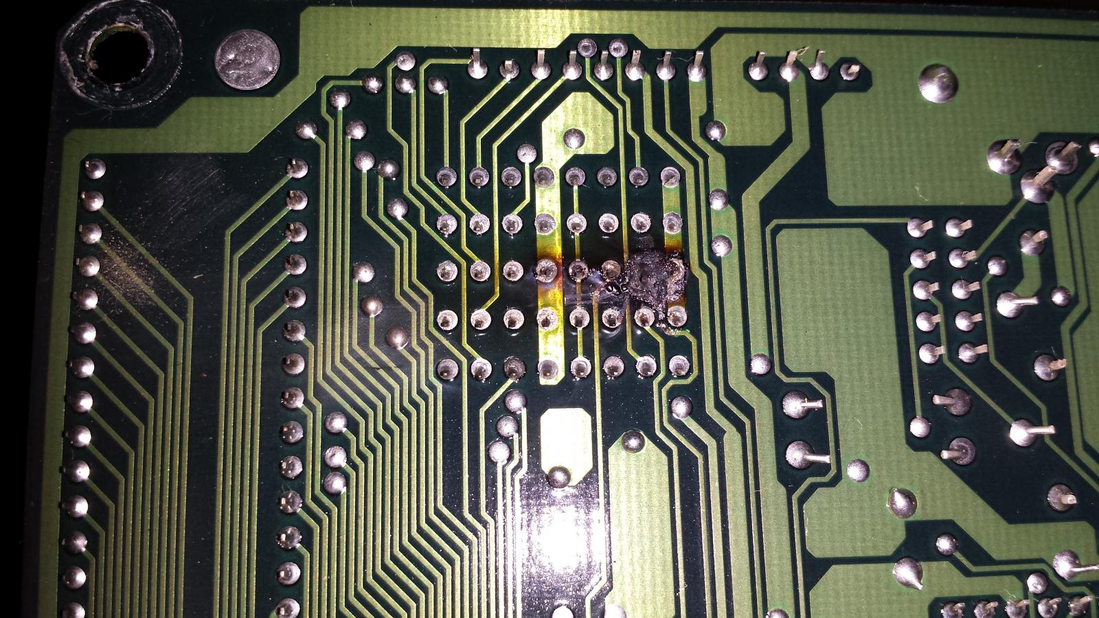

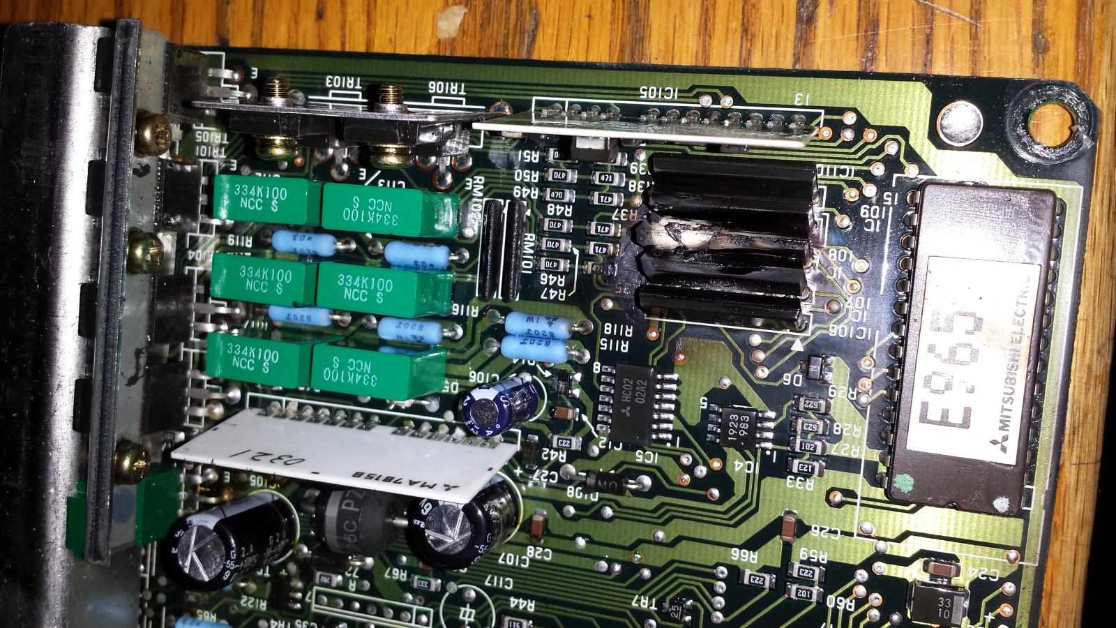

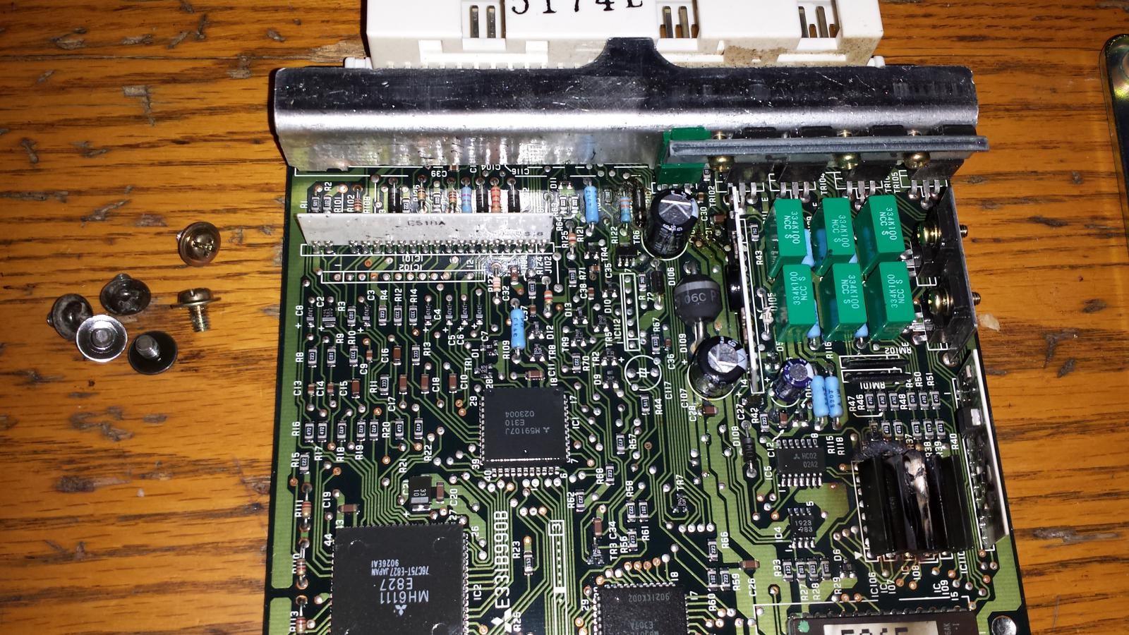

    When I got the truck home I suspected a bad ECU with Leaking capacitors and was correct. So I sent the ECU out for a rebuild, popped it back in and it started right up! I set the idle and timing, did a full tune up, changed all fluids, and it turned out to be the best running/driving truck in my Mitsubishi fleet ever since! This truck is very lucky to still be alive…

    (This damage was caused by a faulty AIC motor. The Idle Air Control servo)

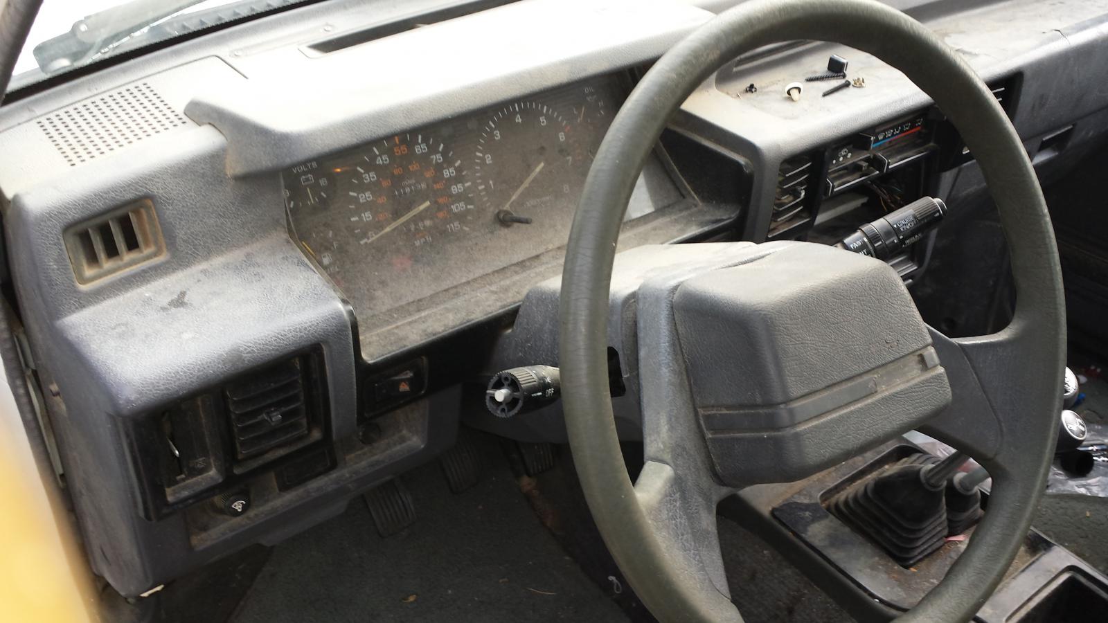

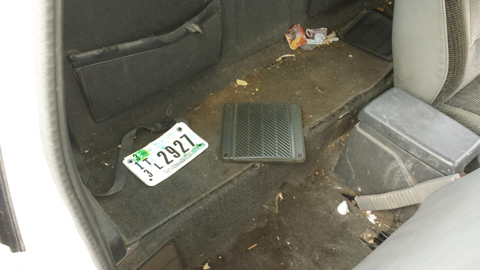

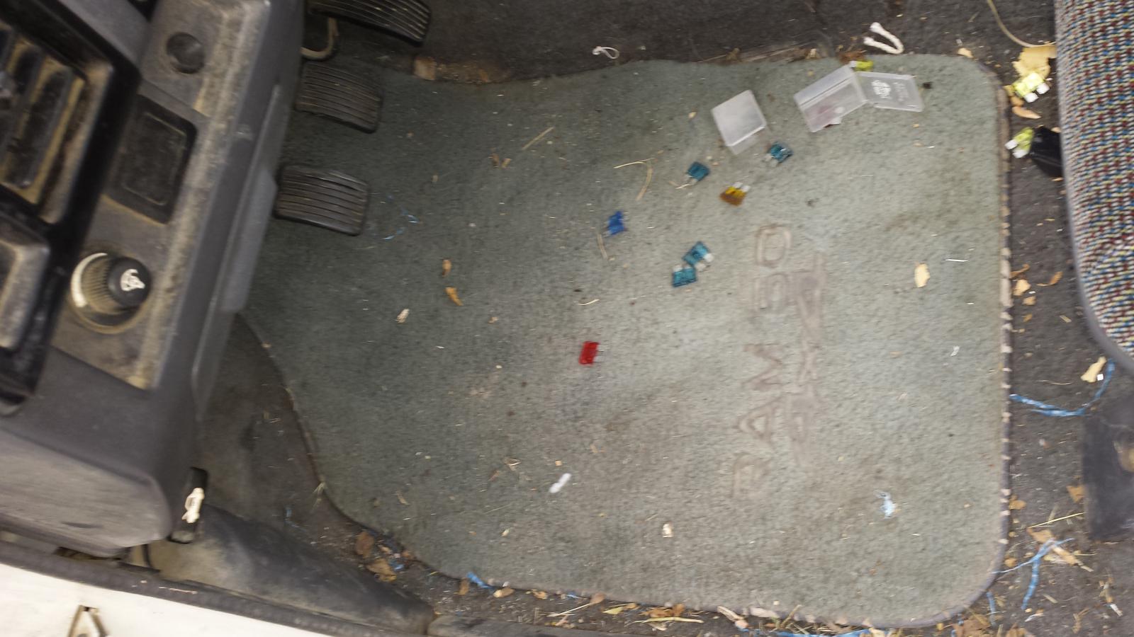

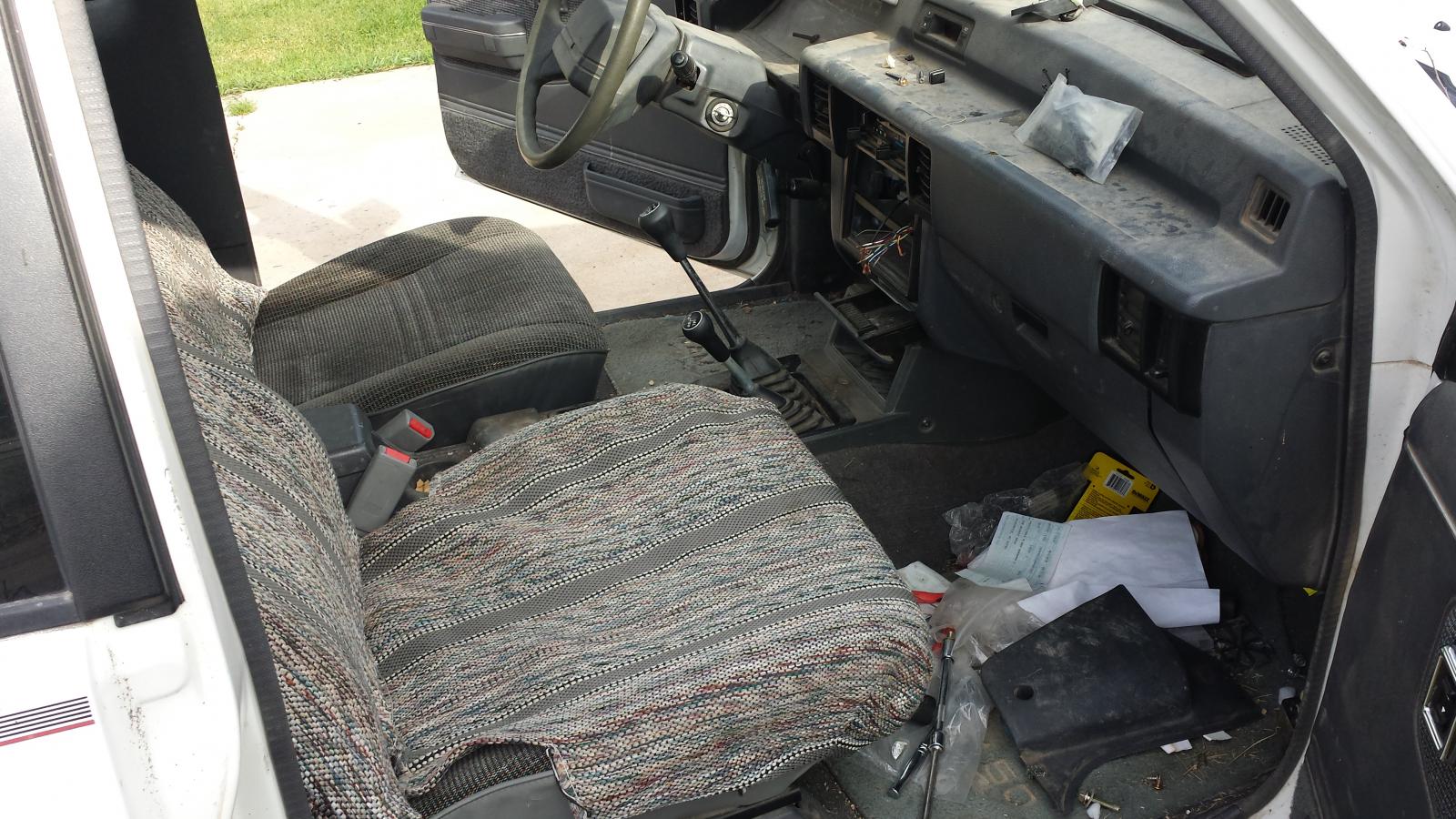

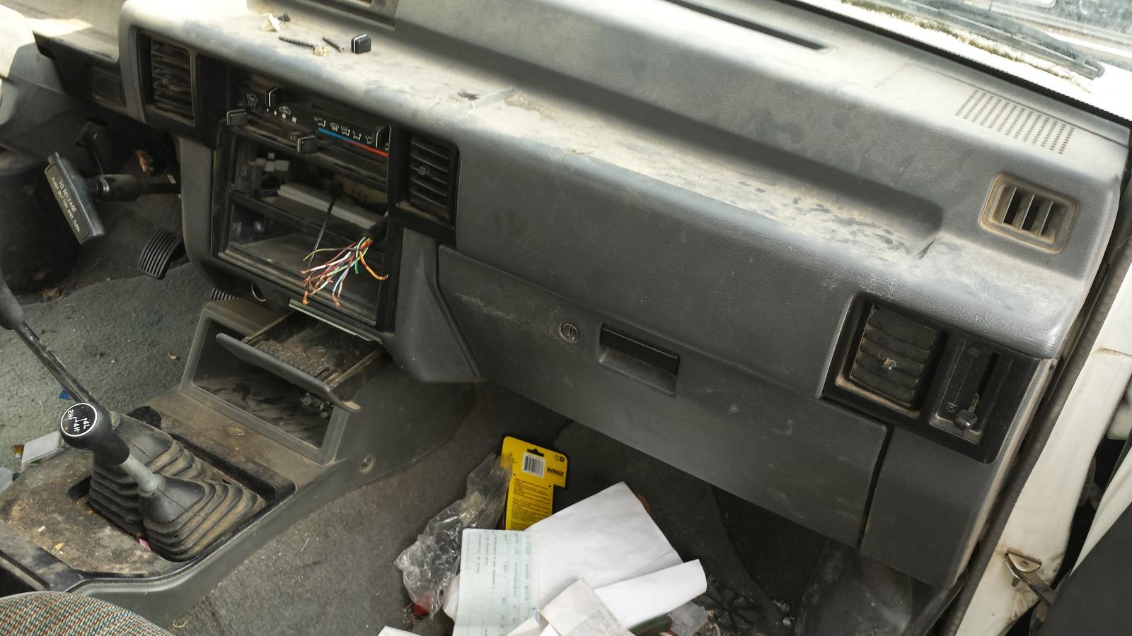

    So my first order of business was to CLEAN up the truck interior. She had sat for almost 10 years with one of the windows stuck half way down. I am thankful that the original owner threw a tarp over the cab, but still lots of garbage/dust made its way in:

    I am also glad that the original seat covers where still on the bucket seats. probably the only reason the seats are still in existence!

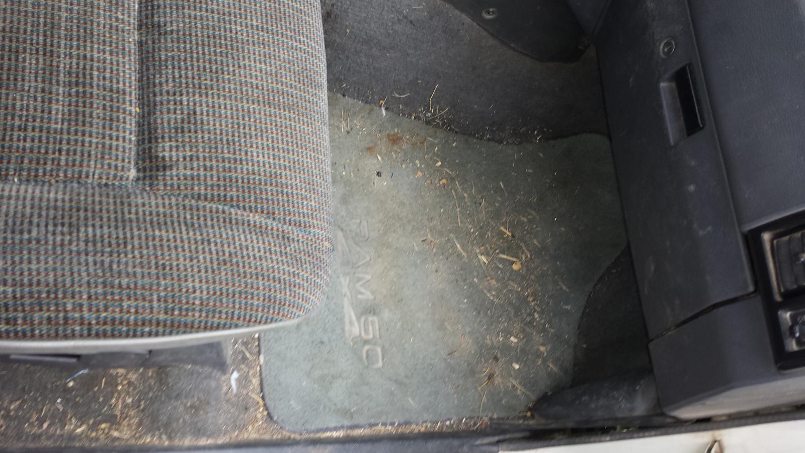

    Check out the Original OEM floor mats still in good shape after all these years.. Dirty but in good shape:

    I had never seen embossed factory floor mats before the ones in this pickup.

    2,952
    Oh man, there's not a lot of love going on in there. If you're game take the mats out and give them a hit with some spray on sugar soap and then...use a high pressure cleaner on them . Obviously don't have it on a single jet or it'll cut those mats into shreds - just on a wide fan and use a sweeping action to lift all the goodness out of them. Couple of rinses and leave them somewhere flat to dry and they'll come up nice and fresh. After giving all the interior trim a good wipe over break out a can of cheap@ss tyre shine and give everything a light spray and then rub the stuff into it with your bare hands (it will take a couple of goes before it comes back to life). It will go a long way into rejuvenating the plastic and vinyl back to its former glory (however don't use anything to restore the trim if you're planning on going all Mad Max and recolouring it with a vinyl/fabric spray - it will make it hell to remove the silicon spray and the new colour won't take to it very well) It's a shame the radio wiring loom got butchered - it is sooo unnecessary to cut them up Post up pics once your interior is clean!
