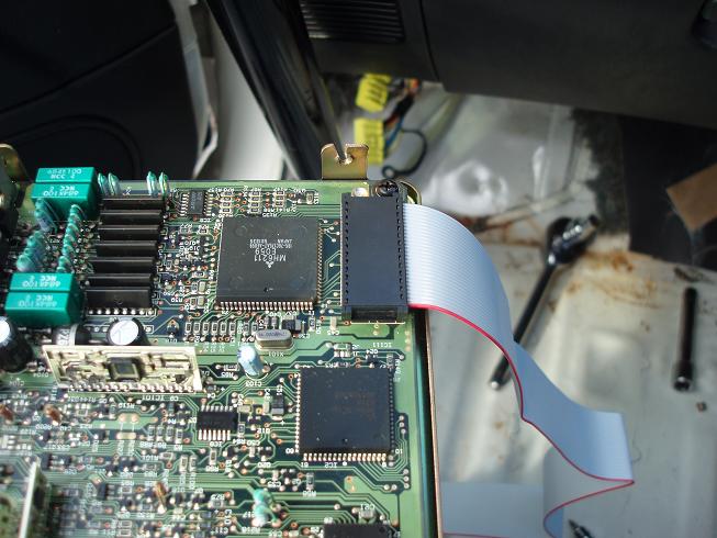

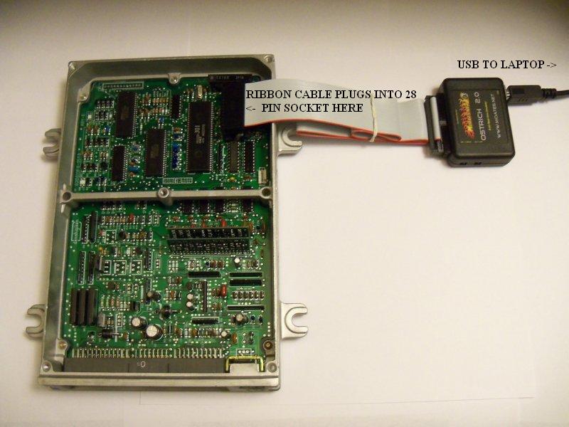

    the Ostrich plugs in to the mitsubishi eprom no need for maf translator unless you want to use one,

    here is it installed on a old evo 1 -3 ecu similiar to or truck and other mitsubishi vehicles until 97-98
    http://www.lancerregister.com/showthread.php?t=168143
    and pluged into a honda ecu below, it works on a lot of different vehicles
