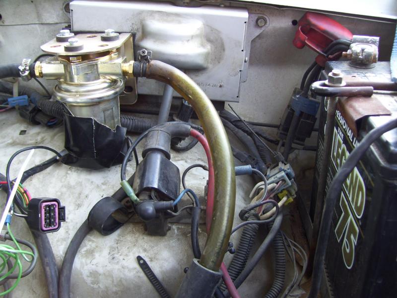

    Hi, The Redline weber tech support is impossible to reach so here goes. these attachments are my simple mods pics-100_1049.jpg100_1050.jpg100_1052.jpg so, I'm newbie amateur,(to my amazement) got my girlfriends 88 2.6 engine going. It has 72k miles and its running just ok. I have some beginner questions. I know it should be running a lot better. I hope with this 32/36 (progressive?) carburetor electric fuel pump I will soon get more power, torque & fuel economy The highly regarded Carter P4070 I think rated at 4-18lbs pressure? no specs with package, You can see I mounted it bright gold as big as your fist,,by the battery because I thought with that much power, maybe being far away from the fuel tank is good? The carburetor only needs 2-4 lbs pressure. I have the Mr. gasket pressure regulator set at 2.5, Is this gonna blow a seal or worse? I can see a fire issue. Does these rotary vane pumps run always? This carburetor has a large port on the bottom of the fuel in port, should/could put the fuel return hose on this port? Its running rich blue smoke. and barely idles when in gear sometimes dying

    I see a problem right off, it may not make a massive bit of difference, but the Carter P4070 instructions state the pump should be as close to the tank as possible. I think yer currently running it about as far away as you can get...
    I'm running mine with no regulator on it, everything functions fine. Caveat being, I'm running a 38/38 Synchro, not a progressive. Dunno if that matters or not, just threw it out there.

    Hey i agree the pump should before the fuel filter i believe and near the tank. my 5spd 2.6 used to die during idle at stop signs. you could be flooding the float bowl. i fixed mine by bending the float. BTW what kind of weber is that? Are you a manual or automatic trans? I want a weber that has uses the linkage near the firewall. What kind of weber is it? i have a manual and need electric choke.
    The weber with the rear linkage is a dfv; dgv are front linkage. A is automatic choke, e is electric; there is a water choke version and a manual one. All choke controls are interchangeable. The fuel filter goes before the pump as close to the tank as possible. The kick down cable for the automatic needs to be connected to get the tranny to shift correctly according to throttle position. It must be a solid connection (arm or bracket) to ensure proper cable movement. Set the timing to 10deg btdc for the best running motor. With the pump by the tank, you shouldn't need a reg.
