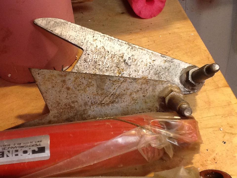

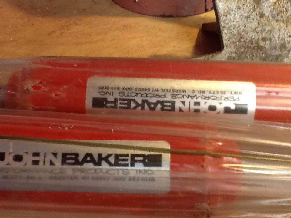

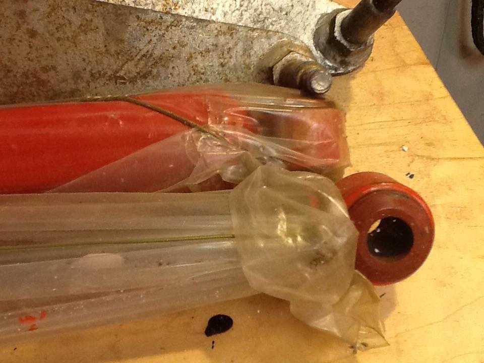

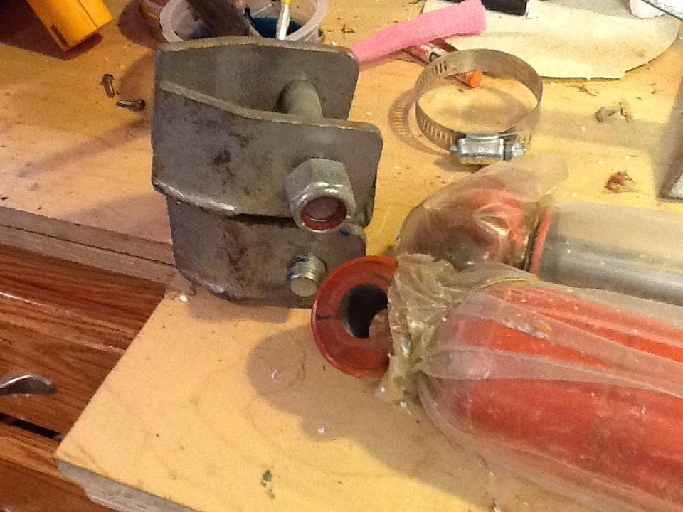

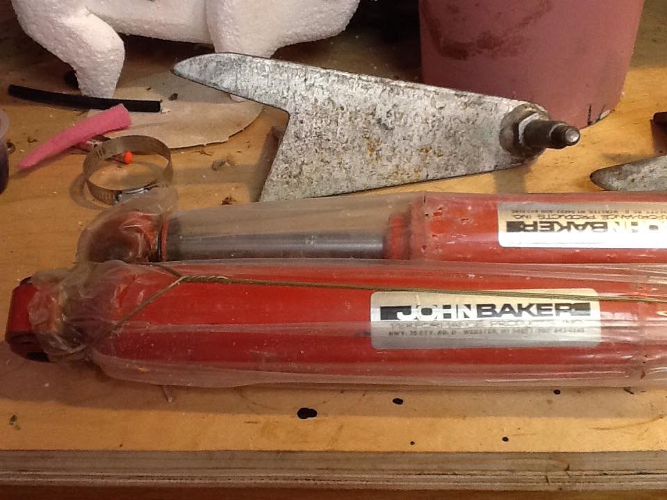

    I got the shocks and mounts in today. These are really well made.
    The codes stamped on the cylinder are:
    SPX-30
    COJ13E2A
    I did some Googling and it appears SPX-30 is a heavy duty twin tube truck shock made by Koni. I'm assuming the other numbers are the date of production and lot number (same code on both shocks). I know Pennyman said they were Monroe shocks but maybe he was mistaken? Today the SPX line is only made for Mercedes and Land Rover. Maybe that's why the ride was so good? These are absolute top of the line shocks.
    http://www.koni-na.com/HeavyTrack.cfm
    Maybe if I send the mounts up to Camoit and we can do some more sleuthing to see if these shocks are still made or there's a comparable one on the market, we can get reproductions made so everyone can enjoy their trucks more.
