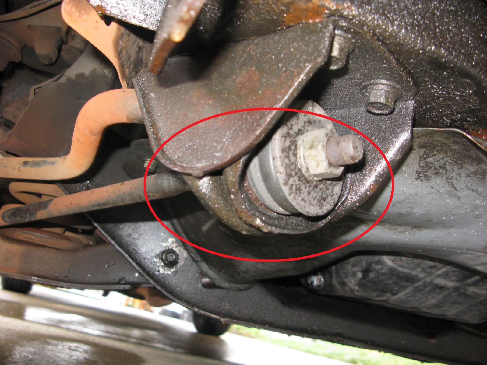

    What's this part called ... loose is bad
    Took the little truck in for a front end alignment this morning & 'they' said it couldn't be aligned because in part because of bad components, and even if they did realign it, it wouldn't stay aligned.
    So.. time to replace some parts. Having problems figuring out what they're called to order new ones so help appreciated please & thank you!!!
    01-16-2014
    469
    Las Vegas, NV
    1991 Mitsubishi Mighty Max
    Those are strut rod bushings.
    The long rod is called a strut rod.
