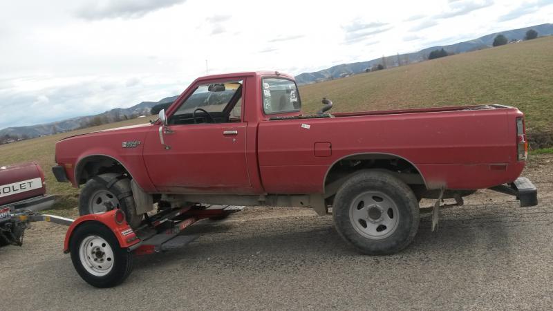

    I think I have a sickness. Either that or i really do have ShitferBrains. I've just purchased my 3rd Ram50 in a year. I simply couldn't turn it down. This is basically the same truck as my 1st gen, only 4wd.
    specs include 5 speed manual transmission, hi-low 4wd with auto locking hubs and factory bucket seats. Unloke my other two, this truck has been used and used well...
    The stock 2.6l went out on the previous owner and he tore it apart. Completely flabergasted by the jet valaves, balance shafts, 2 timing chains and such, he gave up with it in pieces. Now I took advantage and took hit off his hands for a whopping 200 bones.
    THE PLAN: Since I've hit a wall with my 1st gen 2wd build, and lost motivation for it, I've found a way to get it back. I'm going to take my rebuilt 2.6 pit of my 2wd and put it in the power ram. I'm going to get rid of the body blocks, sitting it back on the frame then suspension lift it to accomodate 35" mickey thompsons. Normal paint and interior rebuild included. Pictures to come.
    Now for the 2wd, I'm jumping straight to stage 2 motor... I want a v8 under the hood. I've seen a built 318 fit nicely I to one so that's my first look, but I'll likely talk mtself into the mods to accommodate a chevy 350/th350.
    Here are some teaser pics of the power ram... I've got a lot of work to do.

    PS, I'll give you $300 for the truck right now, lol. Oh ya, Ragtime he is going to need tail lights , look that that truck on that trailer ,

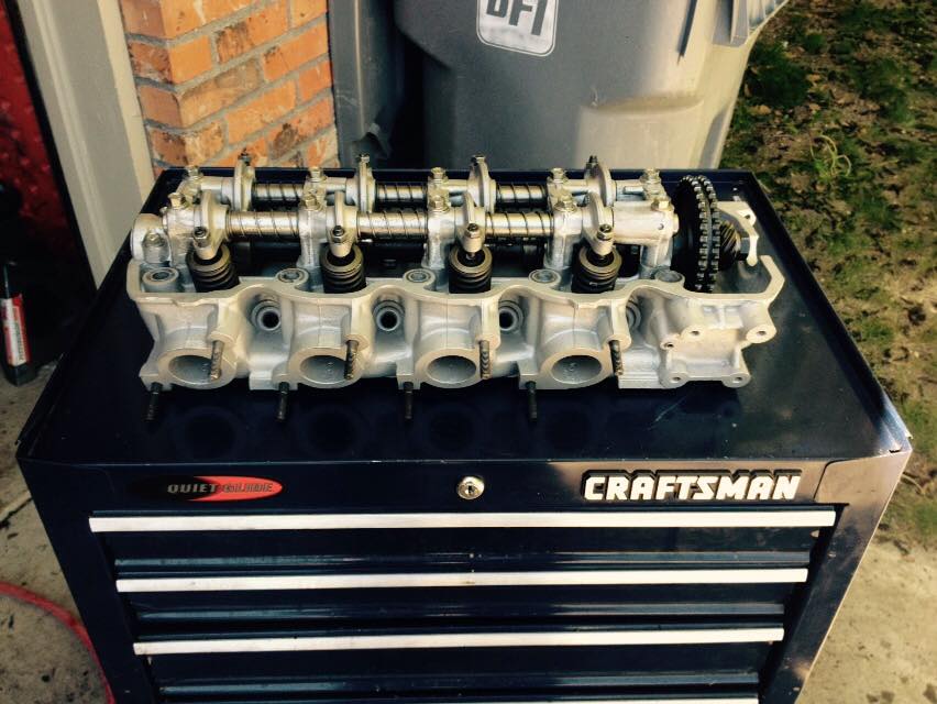

    Got the head back from the machinist. Just got the camshaft and rockers on, with the initial valve adjustment. Hoping to get the block back in the next couple of days so I can do the rebuild and start re-installation.

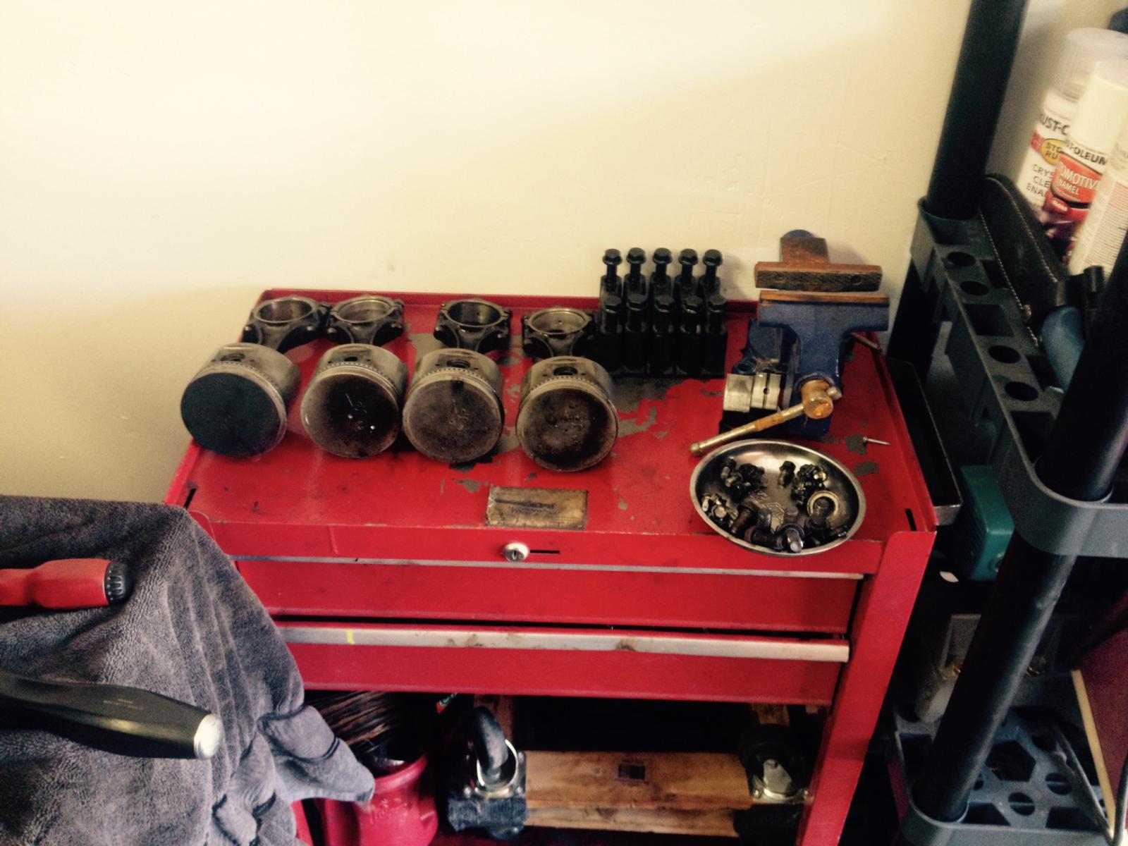

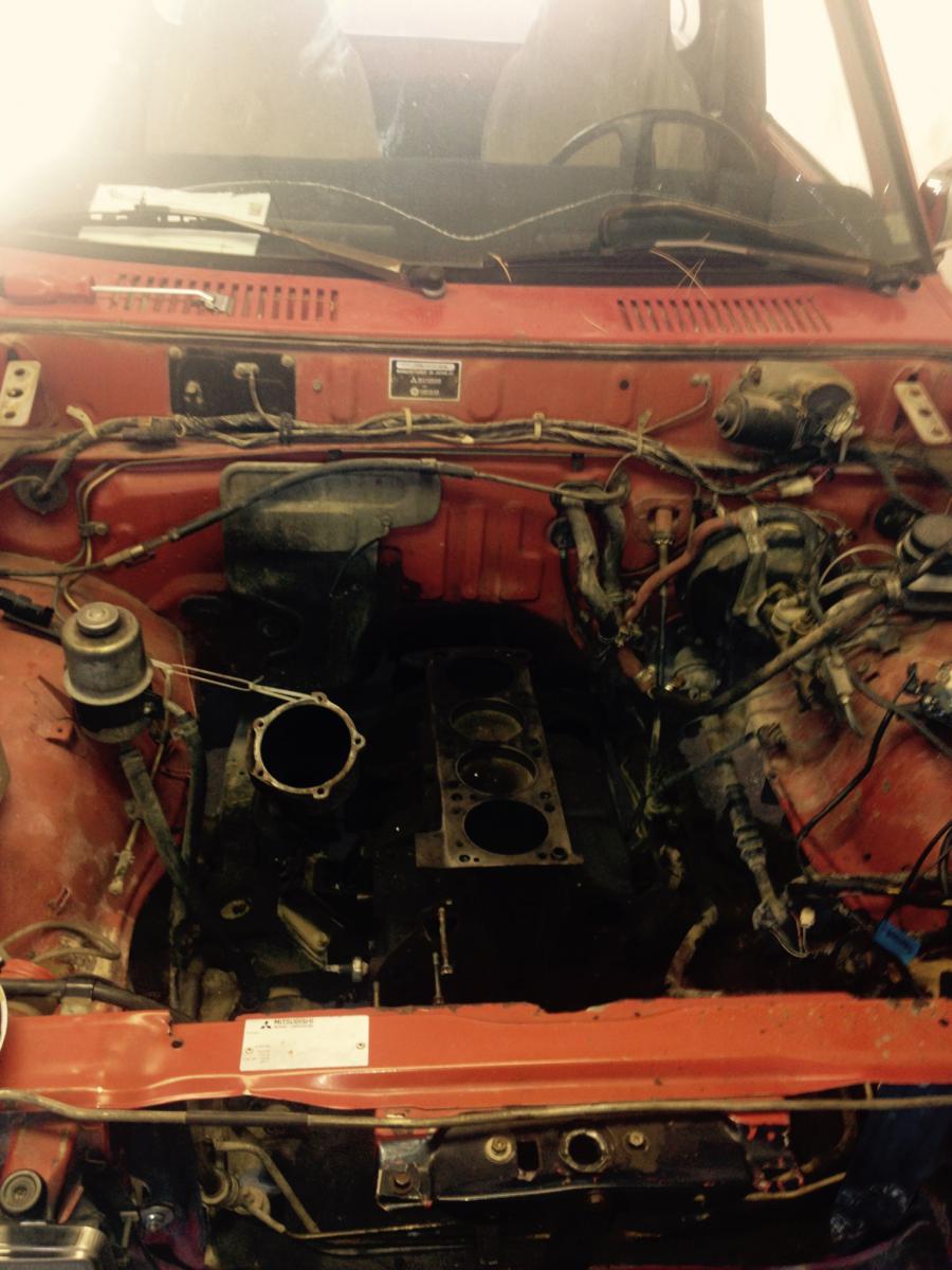

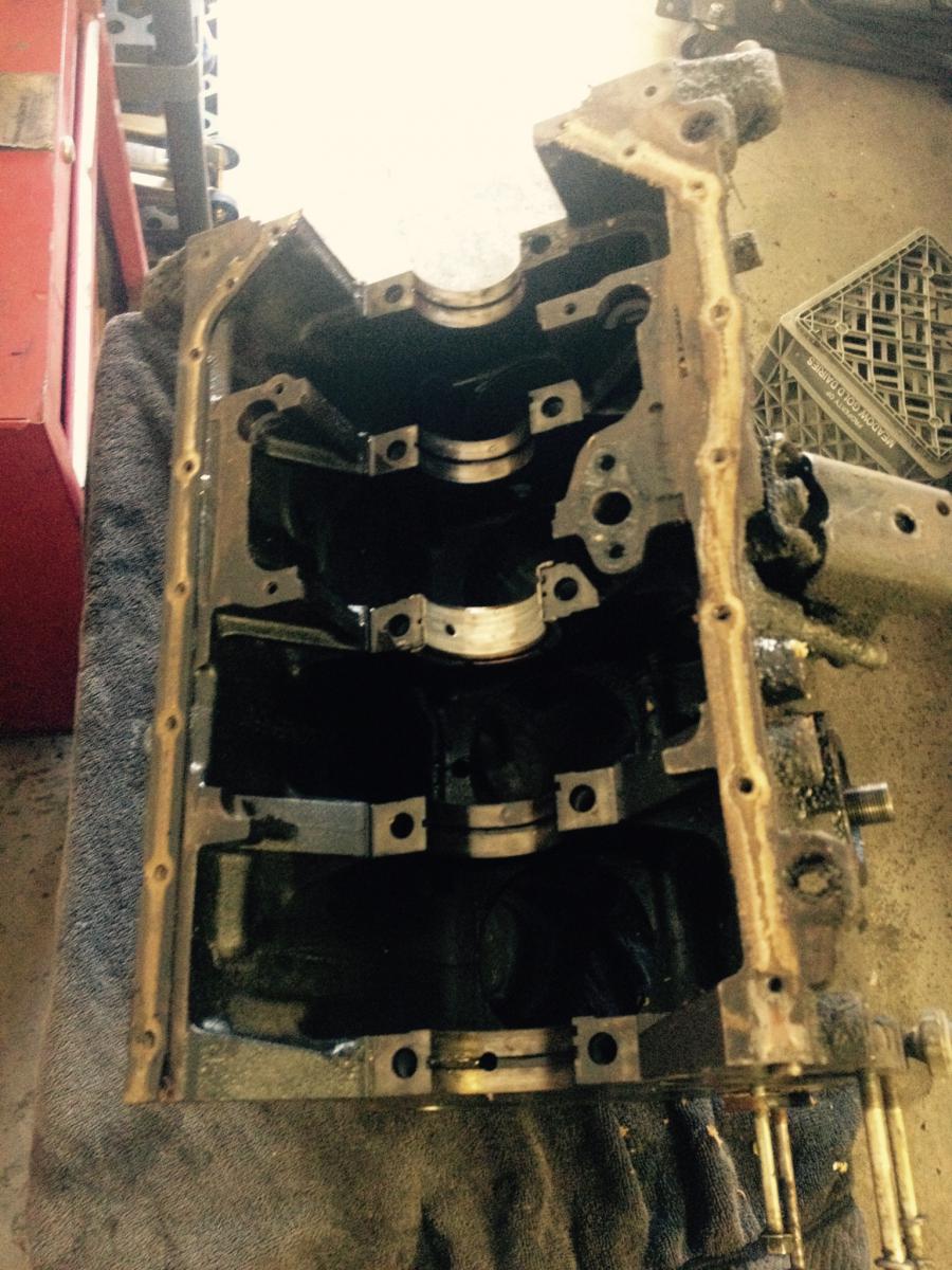

    Okay update time! I haven't done a whole lot on the 4x4 but I've definitely got a start and figured I should share. Been soooo busy lately that I haven't had time to be online much, nor in the shop for my own rigs.
    I pulled a front right fender from my ever expanding Ram 50 parts cache and installed it. I tore off the bent up front bumper and grill. I'm going to order or pull a stock grill from a yard and paint it myself, and I'm having a customer front winch bumper built, using the mounts from the original bumper as a platform.
    I've pulled the original 2.6 and decided to rebuild it. I have a spare head that is just waiting for a block, and this block wasn't in bad shape, so decided not to rob my 2wd 1st gen of its power plant just yet. Block parts ordered, just waiting for the machinist and the block now. I've included a couple of pictures. Excuse my dingy garage, shady camera, and messy organization.... My home garage is never as organized as my shop.
    I have a few other plans for the truck that I'll add some pics of. I bought a set of 12" wide wheels off a toyota buddy. I don't have any pictures yet because they're sitting at my machinist waiting to have the center bored out, but they'll come soon. Right now I'm thinking 35's, but I might just go with 31's... depends on the wheel offset and the fab I'd have to do to have full range of motion in steering.
    I've got some suspension metal ordered. Most of the lift will be fabricated, with the exception of the front springs and of course store bought shocks. Might weld a hoop for mounting above the tire. Tends to give a bit less body roll and then I completely control the height I want to go to, and don't have to depend on blocks or spacers to get there. Still deciding.
    Anywho I'm done typing for now. Here's some pictures.

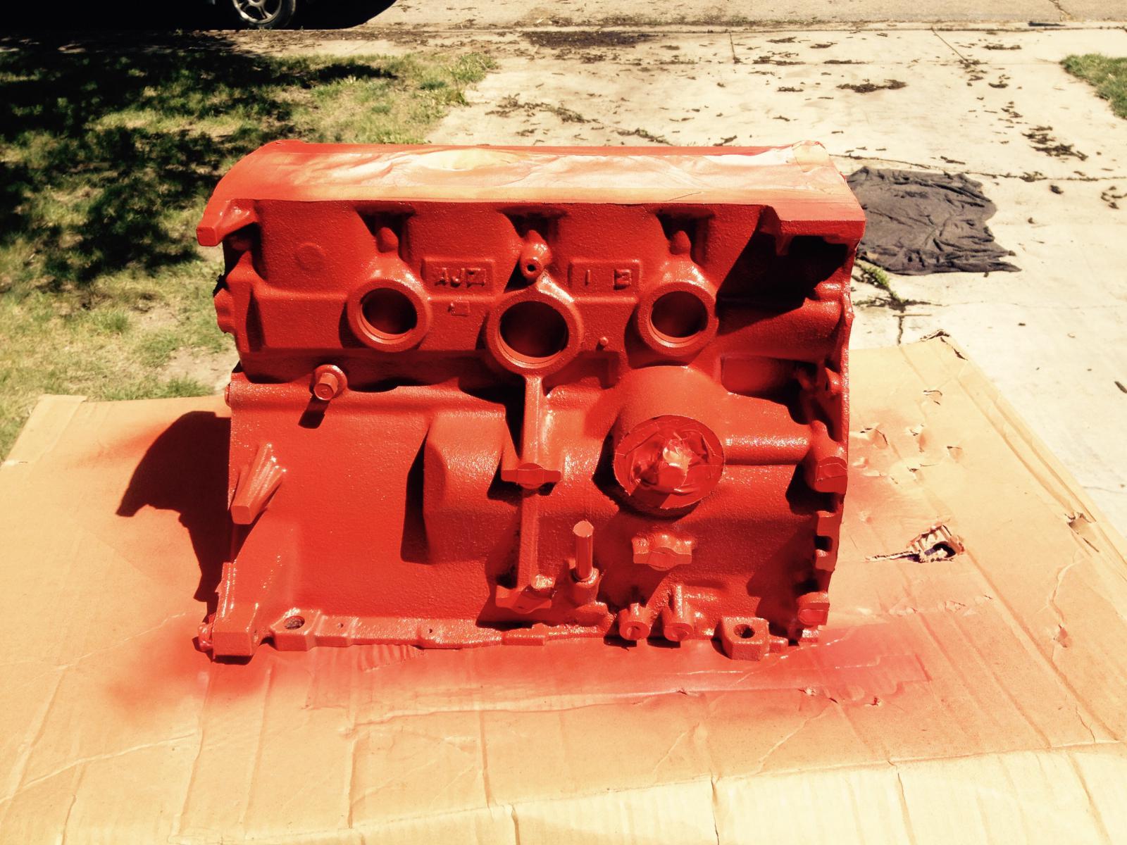

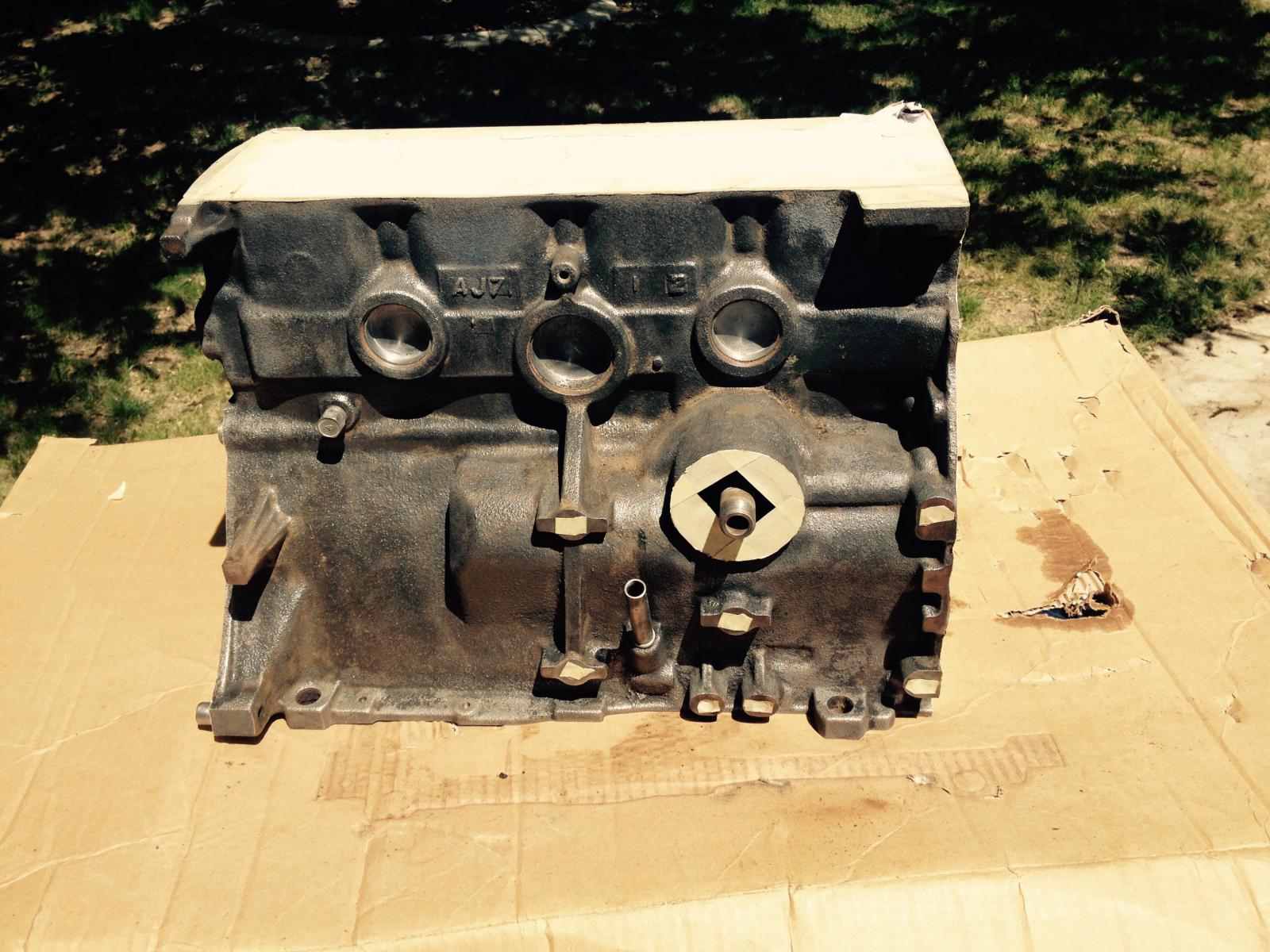

    Got my block back from the machinist, prepped and painted.

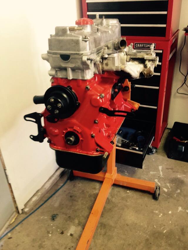

    I need some advice now guys. I like the red/black scheme. I just can't decide what to do with the remaining pieces? Should I paint the timing cover at all? The head? The valve cover? What colors on each? My header is black, my engine mounts are of course black, engine bay is stock red so.... i don't know what to do on the other pieces.

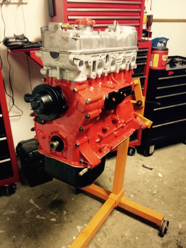

    Parts came in today! New bearings, seals, rings, rods, pistons, and the full gasket kit. Got my balance shaft elimination done, got the pistons installed, got my pan cleaned up. Cleaning and painting the timing cover tomorrow, installing the head, timing kit and the rest of the gaskets. Hoping to install it in the truck this weekend.

    Just the new clutch kit, the Alternator, Power Steering pump, crankshaft pulley, belts, carb and a few other odds and ends to go.

    lookn great!....nice engine stand
    10-10-2014
    136
    Meridian, Idaho
    1984 Dodge D-50
    haha looks familiar.
    Got mine at an estate sale for 3 bucks... haha
