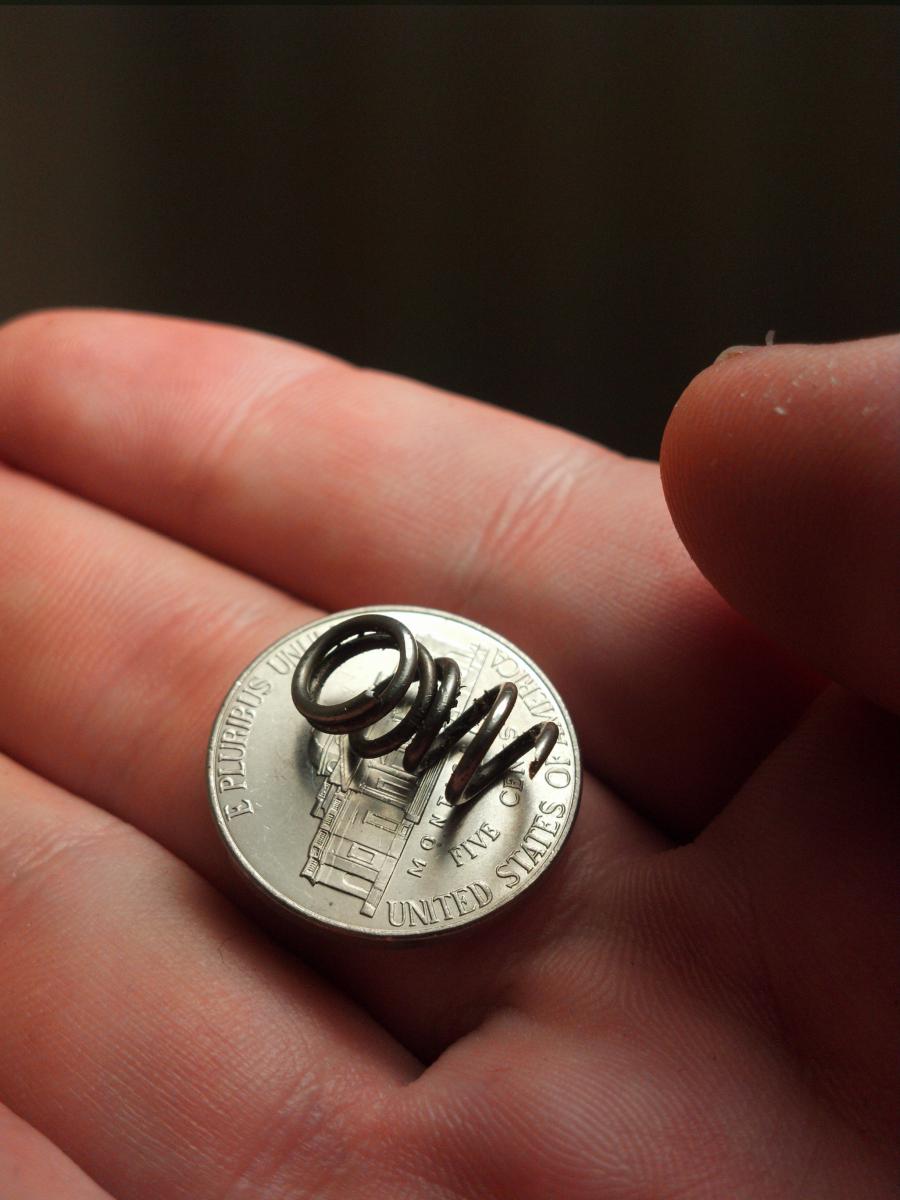

    Hi, I was pulling the oil pan on this truck to check the bearings, and I found a small spring in there.. Was wondering if anyone knows where it might have come from..? Someone told me it's an oil pressure relief spring, but I wanted to check here. I'm not having much luck searching. Thanks.

    Picture...

    I posted a picture. If I could find an edit button I'd fix it. I included it in an attachment this time. In case it doesn't show for some reason.
    Unless it's too big, if it is I'm sorry.

    Looks like something from a jet valve

    Quote Originally Posted by mikewarme View Post
    I thought so too at first, but I compared it to one and the jet valve spring is a bit bigger. Unless there are different sizes. It has had head work before.

    Looks like a helicoil to fix treads

    Thanks for the replies. I don't think it's a helicoil only because it's not tightly wound, and is perfectly round. I had someone else tell me it might be from the timing tensioner.. or something like that.. but it's a belt so, I dont know. I've only been this deep into the engine a few times before, and it was a ford every time.. So I really have no clue, lol.
    I also had someone tell me it could be from an oil filter, but every oil filter spring I've seen is more spaced out, has less coils, and is bigger over all. This one is small and fairly strong even though it's bent to hell. It's also broken in half, so who knows where the rest of it is..

    It's the fuel pump spring. Pull the valve cover and look at the fuel pump arm. There should be a spring.

    If you pull the valve cover, it would reveal if it's from a jet valve or not.
    Amazingly clear photo, BTW.

    Sorry for returning so late. And again, thanks for the replies. I never did find where that spring came from, but I still haven't messed around with the timing parts yet, so it may be from there maybe? The jet valve springs were also still good, and the spring in the fuel pump is also still intact and looks to be a different size anyway, so I'm still lost on that.

    Quick edit: My guess on the spring is the tensioner for either the timing chain or balance shaft chain (can't remember which it is) that sits in the side of the oil pump. Bet there's a piece of rubber in pieces floating around, too.

    I did see a hole in the pump that looked like it might be a spot for a relief spring or something, but no spring, and there are rubber chunks in the pan too, so you may be right.

    If the shaft has really eaten out the tunnel where the bearing is knocked in the only way I could suggest to block the oil gallery is to drill, tap and plug it up permanently. Other option is a one shot deal - weld it up (I'm not hot on suggesting that either) I'm not 100% sure of what the access is like to those oil galleries and if those ideas are feasible. And the spring? Is it out of the oil pressure regulator in the oil pump? To me it looks like it's too wider diameter for the fuel pump rocker arm and I'm not sure how a jet valve spring could've make it to the sump (I'd be more than happy to be proven wrong on that one). Funnily enough I found chunks of similar looking spring in my sump when I did an autopsy on my 4G63 - it suffered a catastrophic internal failure that pretty well wrecked most of the engines' internals. To be honest I think you're gonna have to pull the engine out and investigate further...
