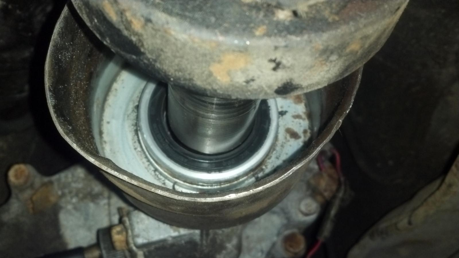

    I proceeded to take out the gearbox and install the spare. Encountered no issues at all until I went to install the rear drive shaft. The yoke is just a little bit smaller than the output shaft in the '88 trans. The front shaft slides in with no problem.

    If they are the same transmission they should have the exact same size output shaft. Only time they would be diff sizes from what I've seen is from Auto to manual driveshafts. Kind of odd.
    Josh
    09 BMW 335i E92 Twin turbo
    swap the transfer cases - they will interchange

    Yeah, that's what I'm thinking of doing if I can't get a yoke or find the driveshaft in the boneyard. Can I remove the transfer case with the tranny installed? I hate to pull that thing again! Here is a pic of the yoke that's too small.
