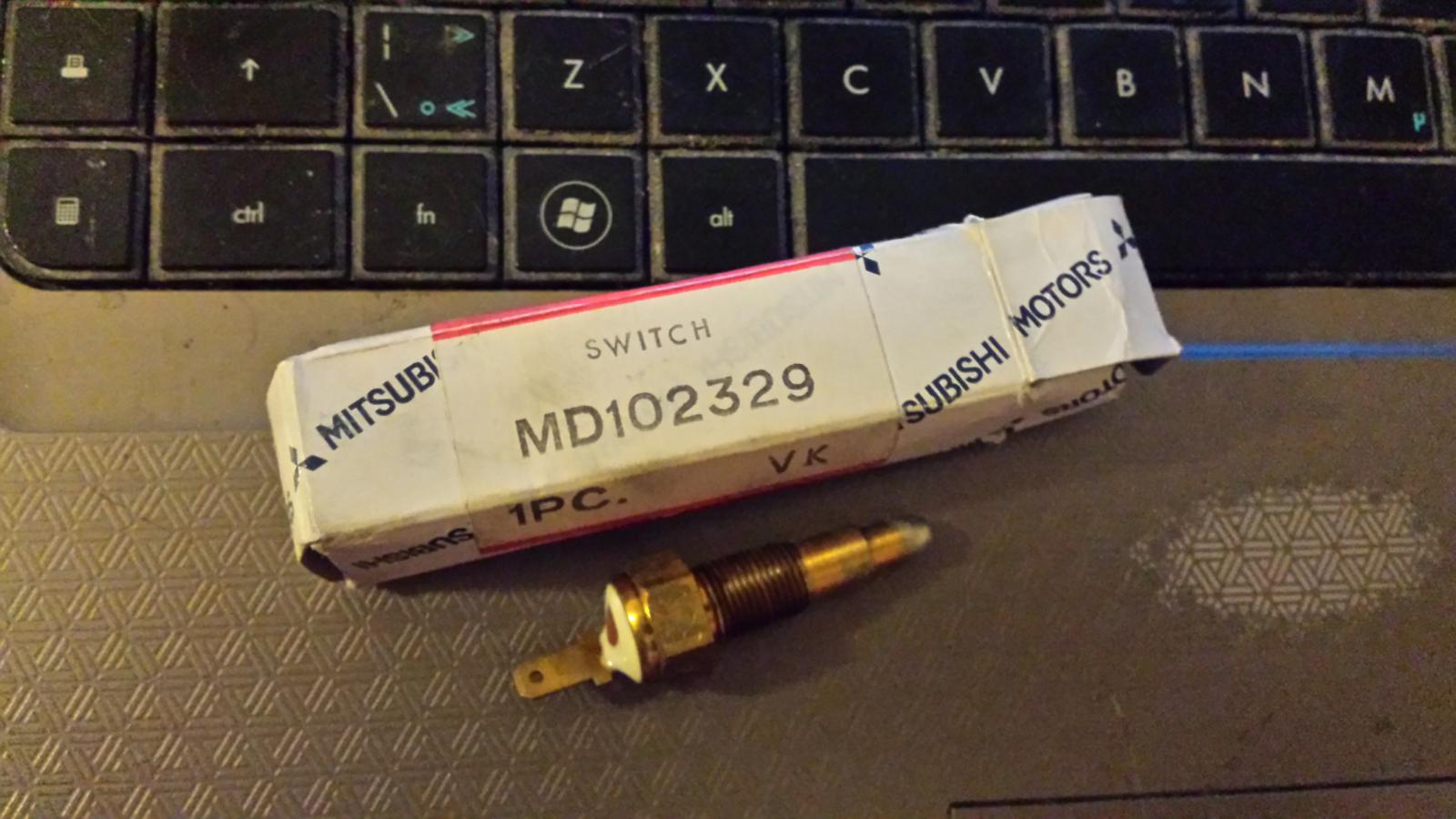

    Not that it makes any difference since I switch on the Overdrive with a switch.. but here is the temperature switch for my truck that just came in today..
