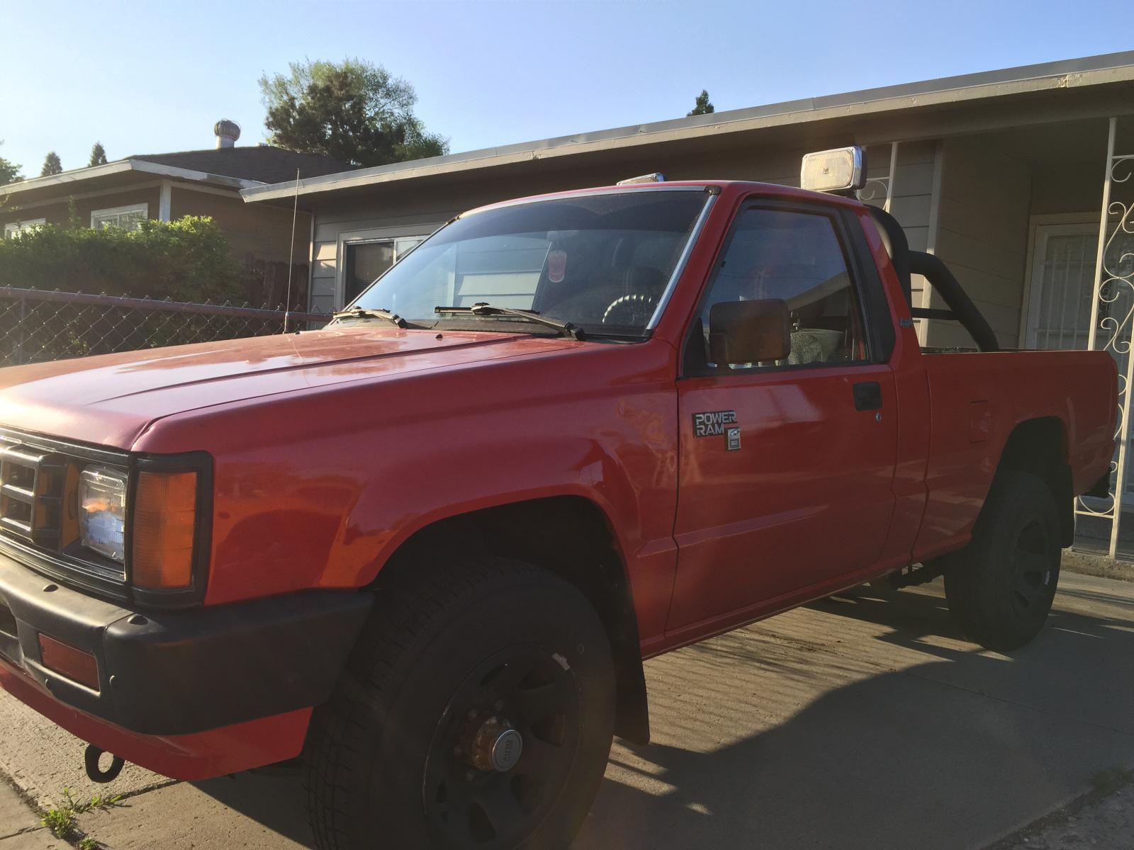

    Thank you all for the information needed to restore this little beast. Three more major projects but any ideas on how to installed lobar lights? The wiring diagram is blah.

    i drilled holes & ran the wires thru the inside of the bar. tack welded bottom of each thread so no-one could steal my lights easily. as for wiring you should use a heavy duty relay (i use a 100 amp)...a search online should produce a diagram...concentrate on very good grounds...i ran an extra ground to the frame.

    use a fuse... :-)
    4,309
    look into putting a higher output alternator on if you are running halogen lights, or you will kill the battery quickly. Factory alternators are only 45 amps - get a 75 to 100 amp one from a starquest or expo van.

    Got some LED fog lights and was hoping to get an LED bar to avoid using more output than I should. Light bar will come last I far the fog lights don't look bad. Have to repair front end since it's a safety issue.
