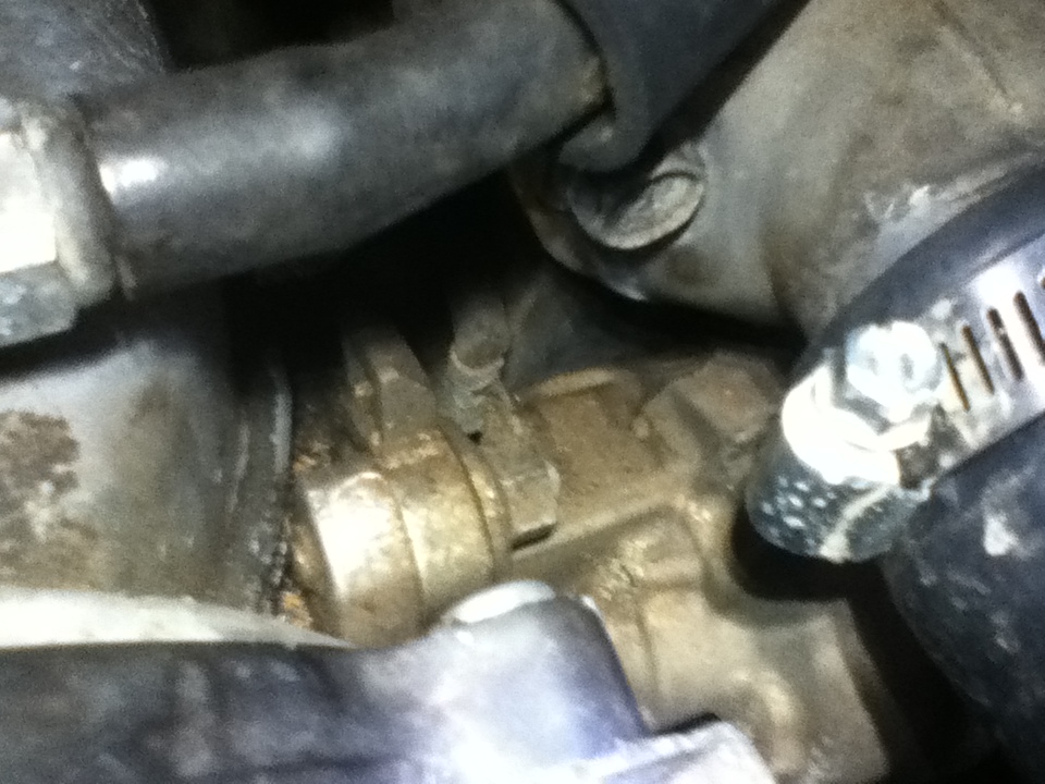

    I also tried checking the vacuum advance, but I didn't see anything that resembled the vacuum advance pictured by Haynes on the distributor. Is this particular model supposed to have a vacuum advance?
    Here are some pictures of my distributor in case that helps with the vacuum advance:
    From the top/front:
    From the bottom/front:
    From the top/left:
    3,846
    To much advance will make an engine run hot. So does a vacuum leak. The brake booster is notorious for hiding vacuum leaks. Sometimes are there sometimes they're not.
