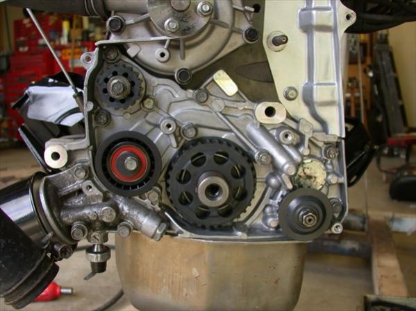

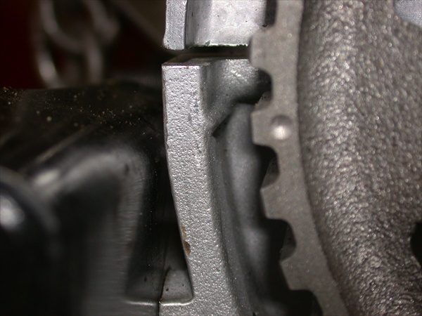

    I second what pennyman says. He got it off 1 tooth. It's easy to do and EVERYBODY does the first time on these things. The rule of thumb is to line it up with the flat of the head, but that is retarded 1 tooth. It's most likely advanced at the crank by 1.
    He probably didn't think anything about it when he pulled the distributer out and moved it one tooth to retard it to make it come back into timing. after changing the belt. Or there is a vacuum leek and it's lean like a mother and turning the header red hot.
    The worst that can happen is you over heat it and crack the head or melt a piston or burn a valve.

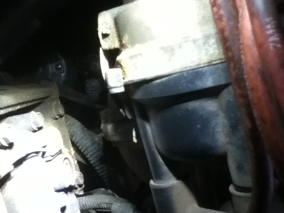

    Here are some pictures of my distributor in case that helps with the vacuum advance:
    From the top/front:
    From the bottom/front:
    From the top/left:
