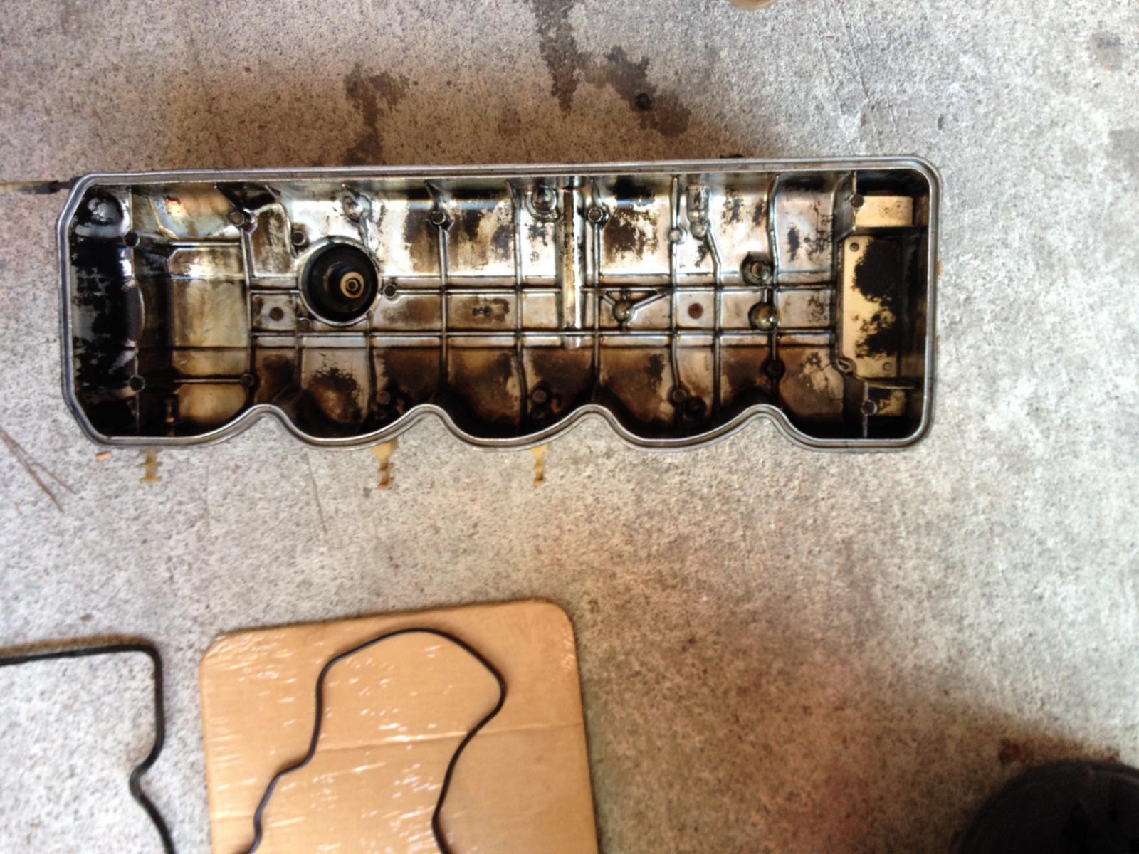

    - 2.0 engine Valve Cover Gasket with accompanying grommets.

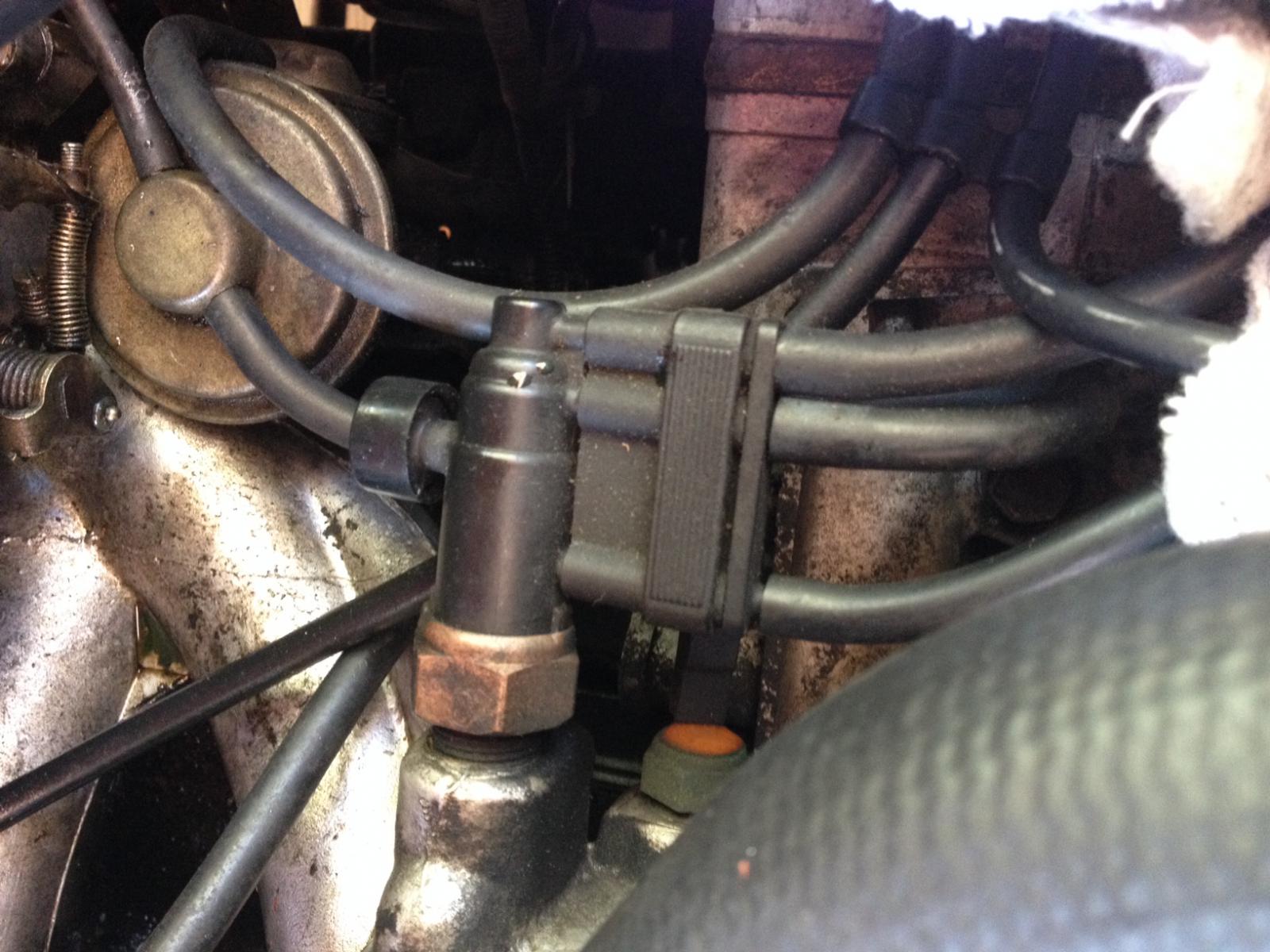

    - An emission related thermostat valve ( I have pics of the part )

    What do you mean by it does not fit? The pumps for the g52b and g54b are the same as long as it is for a 79 - 81 motor, as is the valve cover gasket. You can make a new carb gasket from gasket paper using the old gasket as a template. If the gasket doesn't fit, there is a problem with the valve cover, like the cover was switched with a different motor, maybe a 2.0 l Colt car motor. The A/C dryer should be a standard part - the dealer installed unit is most likely a lone star or frigette unit sold through the dealer. Post pics of all the parts you have issues with and we will help you figure it all out.

    Hi Pennyman1,
    Here are the pics. I dont think the engine has been switched.Fuel Pump.jpgEGR Thermal Control Valve.jpgV-cover gasket.jpgV-cover gasket.jpgV-cover.jpg
