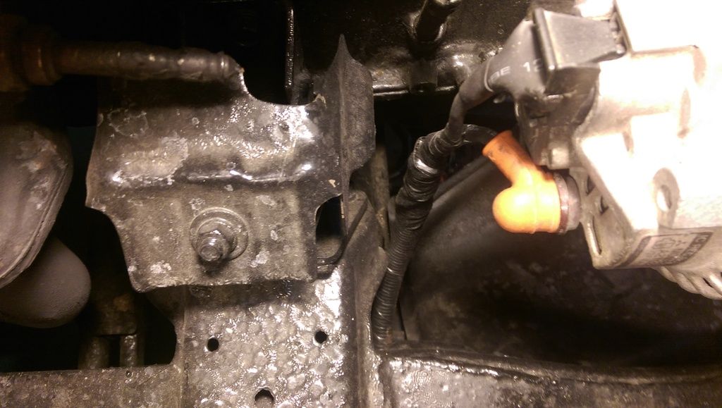

    alternator harness comes directly off the alternator, into the frame rail on passengers side.
    if you look close you can see the alternator harness going into frame in the passenger wheel well, headed to the front end.
