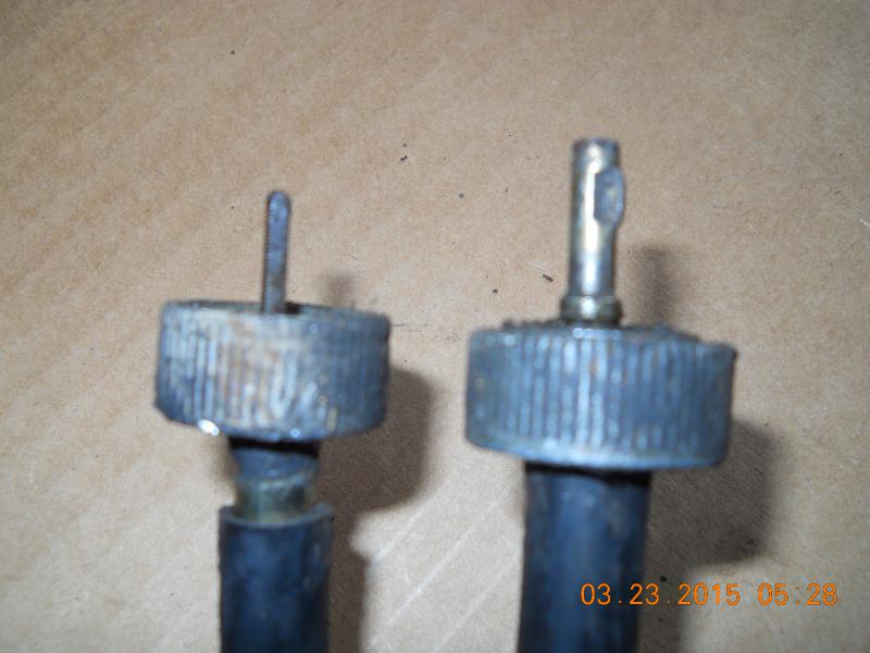

    Well I have got the speedometer cables figured out and mostly bad news Sorry.
    I have a manual trans cable and a automatic trans cable the two are completely different and as well of the transmission speedometer gear housing that is mounted on the side of the automatic trans and the manual trans.
    The cables are the same length and same connectors on the transmission side and same on the instrument cluster side as well.
    The internal cables are completely different.
    Manual trans cable has a large diameter rounded keyed way end that goes into the trans and a square small end going to the instrument cluster.
    Automatic trans cable has a small diameter square end that goes into the trans and a square small end going to the instrument cluster.
    The trans input speedo gear housing is smaller in diameter than the automatic trans does it is a large diameter housing so can't interchange them.
    I will have pics posted underneath comparing the cables sorry for the damaged cables all I had to work with.
    DSCN0749.jpgDSCN0750.jpgDSCN0751.jpgDSCN0752.jpgDSCN0753.jpgDSCN0754.jpgDSCN0755.jpgDSCN0757.jpgDSCN0758.jpg
    thats what I was talking about - the pics says it all.
