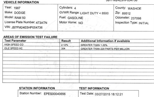

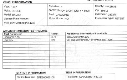

    Two smog checks all failed. First one I had oil change filters changed spark plugs changed, no luck. Second I had to drive around to flush out the bad fluids again and refill and failed by .02. Someone told me to put marvel mystery oil in gas and oil have it run for a while and do the rest to pass

    I got 12 days left and I'm desperate. Might switch out the catalytic converter. Was told it idles too low now lol. Don't want it to sound like its at 4K rpm constantly either.

    Don't throw parts at it.
    What are the numbers for the failed smogs?

    03-25-2015
    30
    Reno
