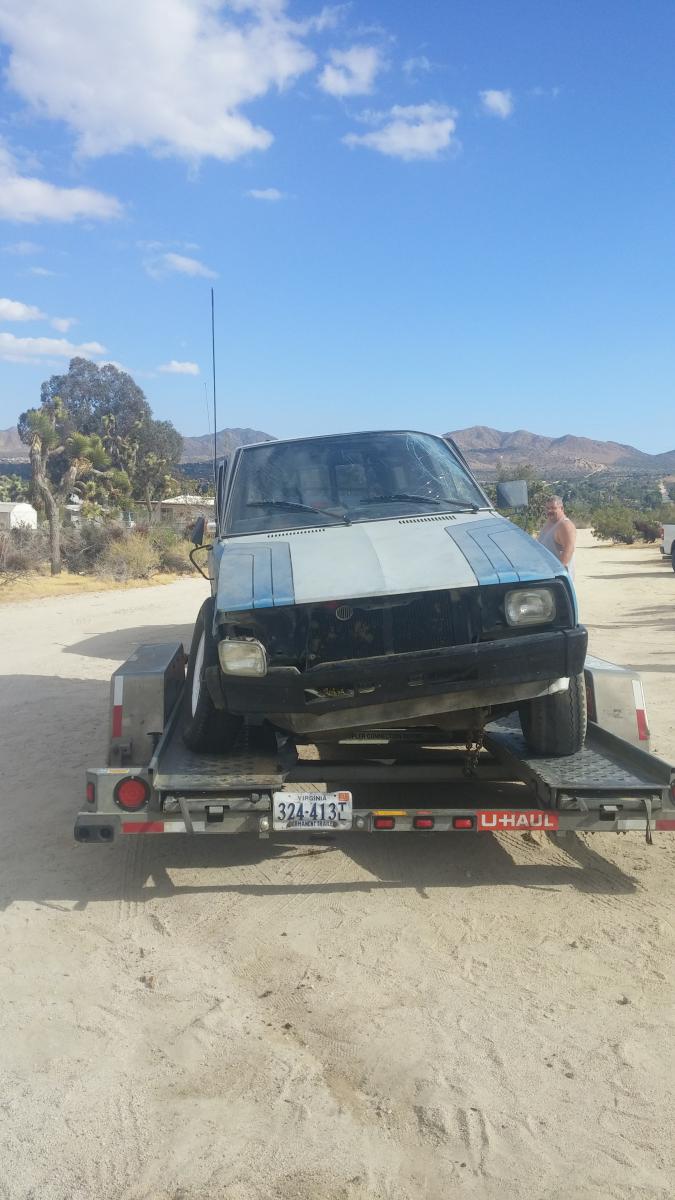

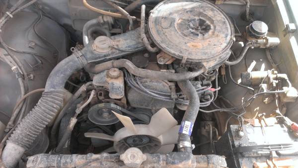

    So I found another 1983 4x4 Mighty Max for $350. It had a little accident with a telephone pole but it still runs no problem. It also supposedly has a Warren Locker? My plan is to pick it up and swap engines and possibly put the manual trans in my truck. Am I going to have a problem fitting the manual trans under the auto body? I've heard that the transmission tunnels are different. Anyways i'm going to pick it up on May 9th! Now here a some pics. I'm not sure what engine that is though.
    00909_lVSeNjwzxPX_600x450.jpg01111_gBOaWdNiv6J_600x450.jpgEngine.jpgWHHYYY.jpgBruh.jpgBruh 3.jpg
    engine is a 2.0 l - the tranny is not a problem, but the tunnel will be with a stick,as the gas pedal is offset to the left instead of the right and will end up under the brake pedal when you swap in the manual pedal set. you have to use the manual gas pedal and massage the tunnel to give you room to fit it in, or use the auto tranny on the 2.0 - it will bolt right up as it is a narrow block motor.

    How can the engine be a 2.0 if the trucks 4x4? I thought all 4x4 came with the 2.6. And I'm picking up the whole truck so I can swap the pedals. Will the transfer case on the transmission work no problem or will I have to swap them? And is the wiring for the 2.0 and 2.6 the same?
    the telltale signs of it being a 2.0 are the plastic timing cover and the p/s pump being high up on the exhaust side of the block. Since you would have both trucks, any differences in the harness can be swapped from one truck to the other. Why not fit the wreaked one instead - its already running - and use the other as the parts truck? BTW - in 83 MMM came with 2.0 in the base 4wd and 2.6 in the SPX model.If you do swap the motor to your truck, use all the parts from the donor truck to ensure a match.

    So I picked up the parts truck today. The frame is super bent but it still runs and drives after hitting a telephone pole. I'm planning on swapping the 2.0 with the 4 speed manual trans into my 4x4. I'll also swap whatever else I need to to get the 4x4 running. The parts truck is also a 4x4 just the base model. And now some pics
