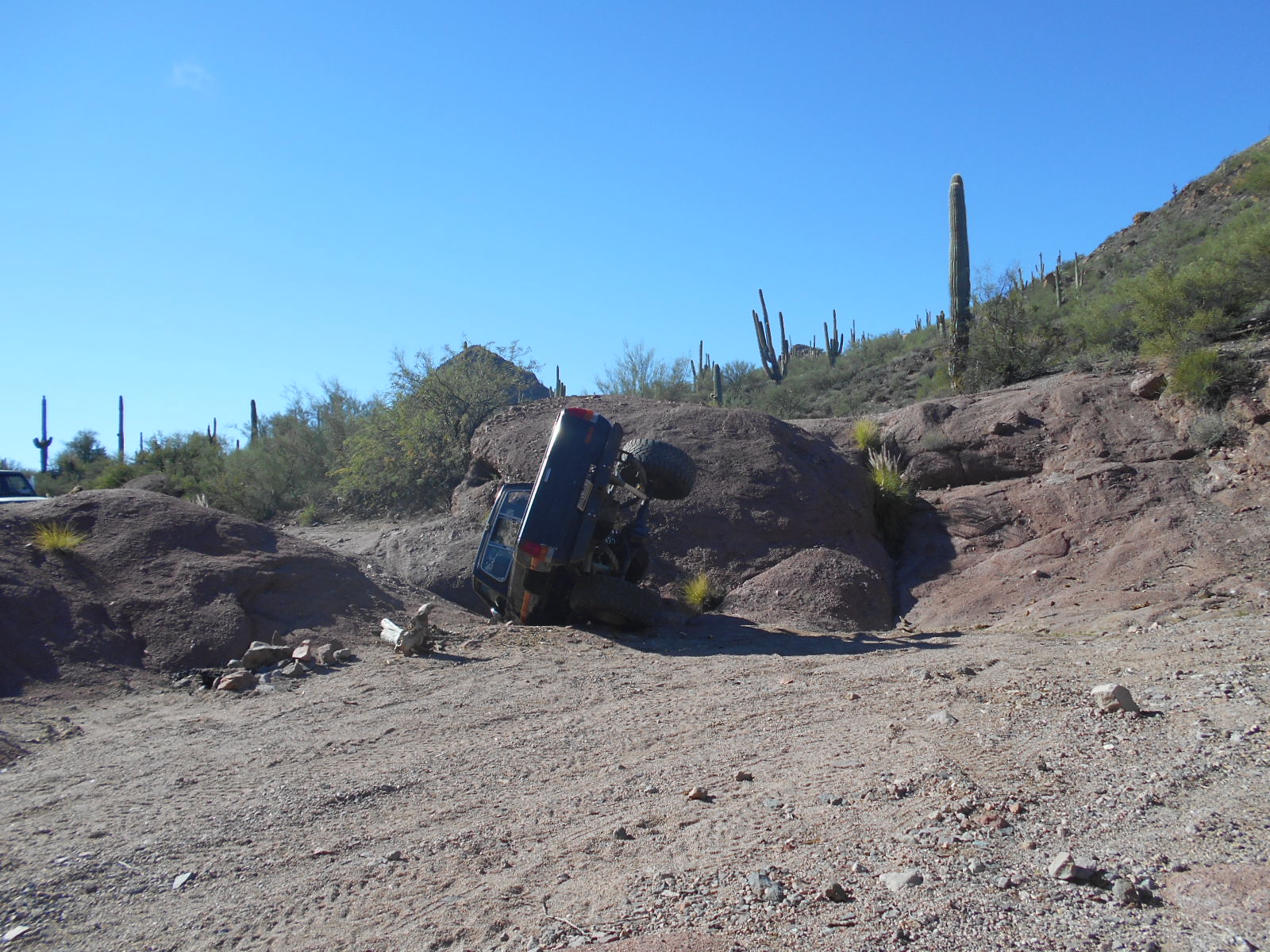

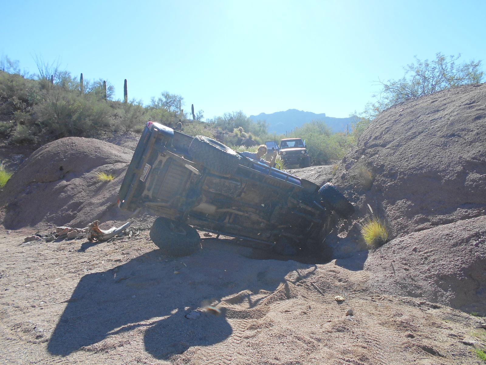

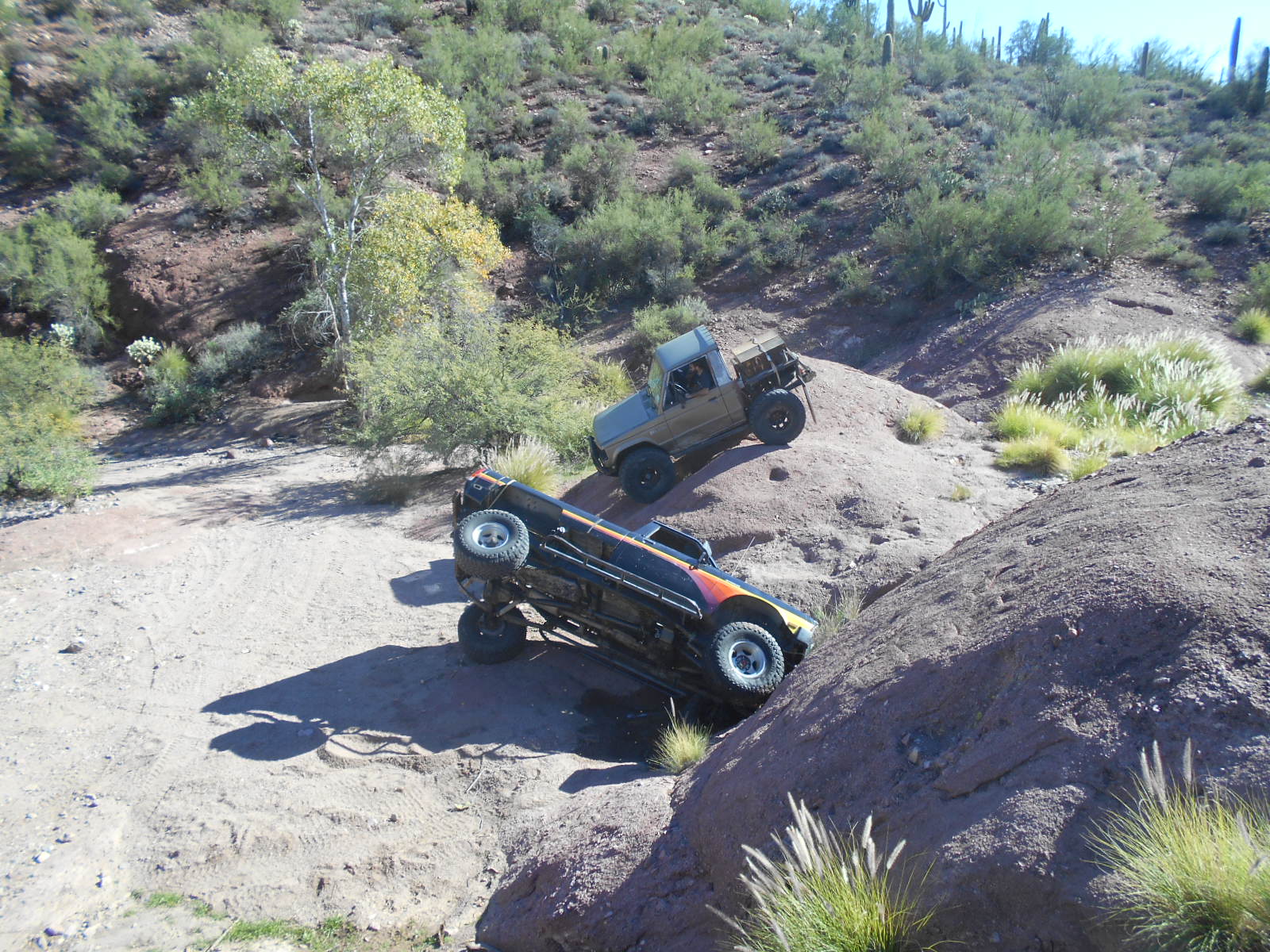

    So i finally got a chance to shake down the Mighty Max, got a little nutty but all in all a successful trip.
    Tipped it over but no real damage done, need to finish up the bed though. Anyone have a front bed skirt laying around? I need one (left or right) to extend my original ones to be reinstalled.

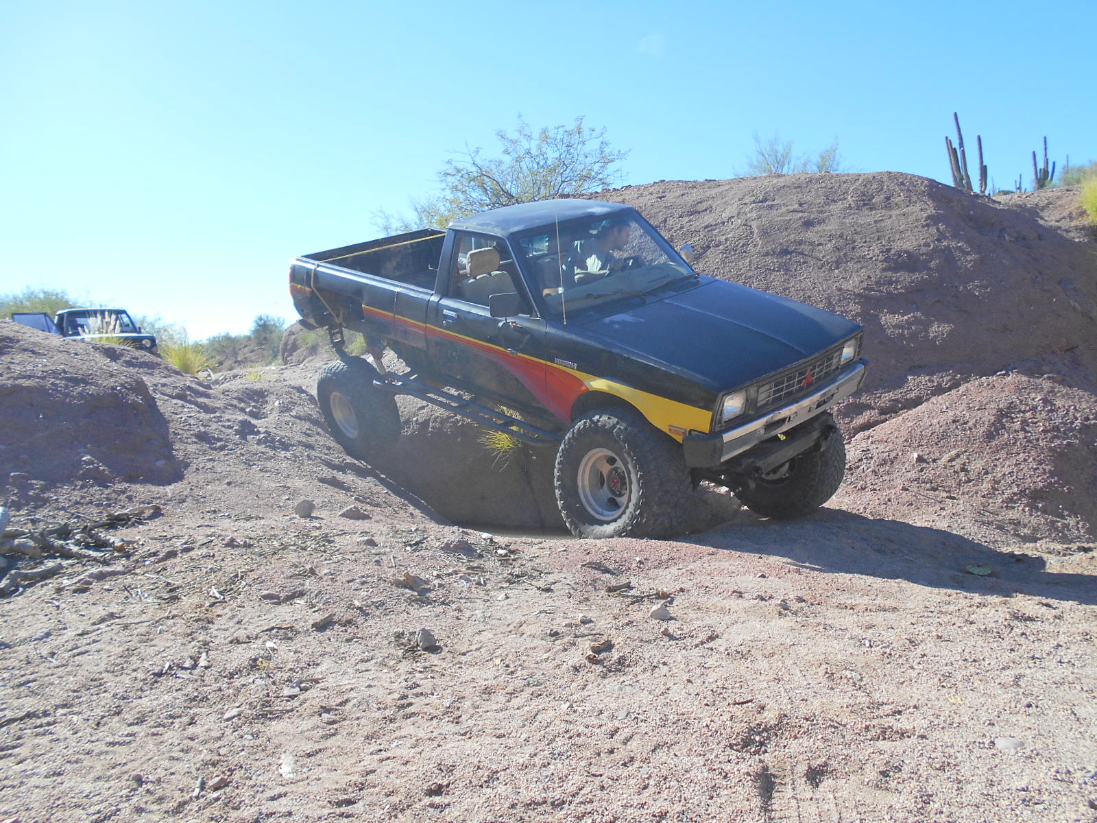

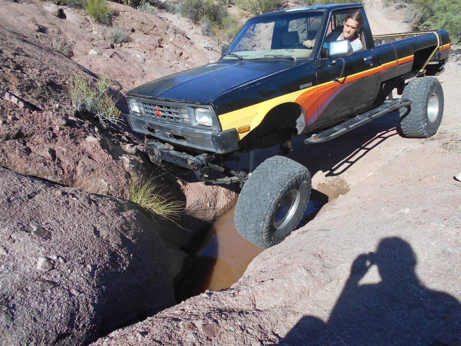

    Most excellent!!
    Looks like the beastie articulates pretty good.
    & an '82 ??? wow, I bet the 4 ?Toyo's? weigh

    Yeah this truck is probably the oldest Mitsubishi branded Mitsubishi I've ever owned. It has to be one of the first to be sold here in the states as a Mitsubishi. I think it's official model year is '83 but the truck itself is an '82 build date. Tires are really heavy, i think around 100lbs per corner. The truck is way light, i need to switch to some squishier shocks because it rides pretty firm and the springs are Alcans made for rock crawling so they are really soft.
