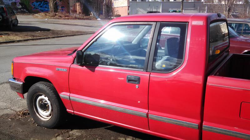

    Here is a link to 6 pics of the truck:
    http://s1063.photobucket.com/user/ma...?sort=2&page=1
    Very clean. One owner, 80K miles. New tires and brand new head. (Can this head be used on thee 2.4?)
    the 2.6 head will not fit the 2.4 - the 2.6 is an astron, the 2.4 a sirius motor - 2 different generations.
    2 different engine family's I think Pennyman meant to say. There are engines in different generations that are compatible, for example the G63B engine can interchange among 1st and 2nd generations.
    Why not buy that red truck and use it for your ride. Just using the head off it doesn't make sense to me, though I confuse easily.
