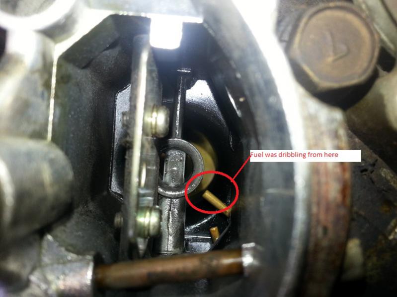

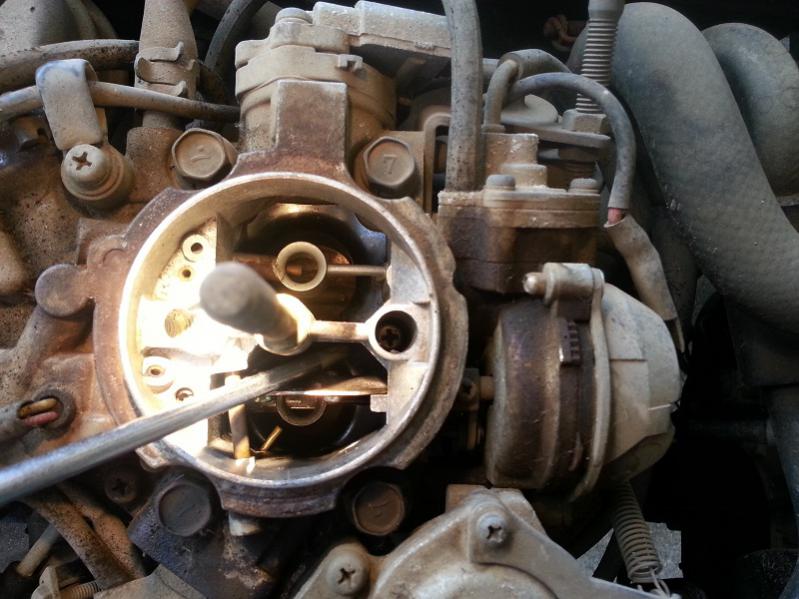

    Photos
ID:	13662Text in red says "fuel was dribbling from here"

    It cleared up on its own. I noticed that the fuel dribbling noted in the post above yours was gone as well. I think that I may have stirred up crud during the fuel filter replacement (now that's a PITA) which got to the carb and messed up the flow. It must have blown through. I haven't had an idle problem since.
