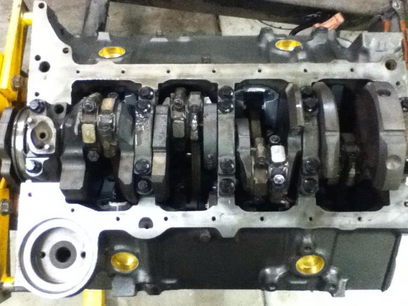

    '75 Chevy 350 -4 bolt
    WCT5 transmission

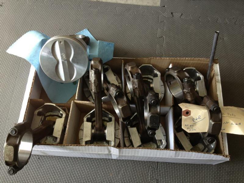

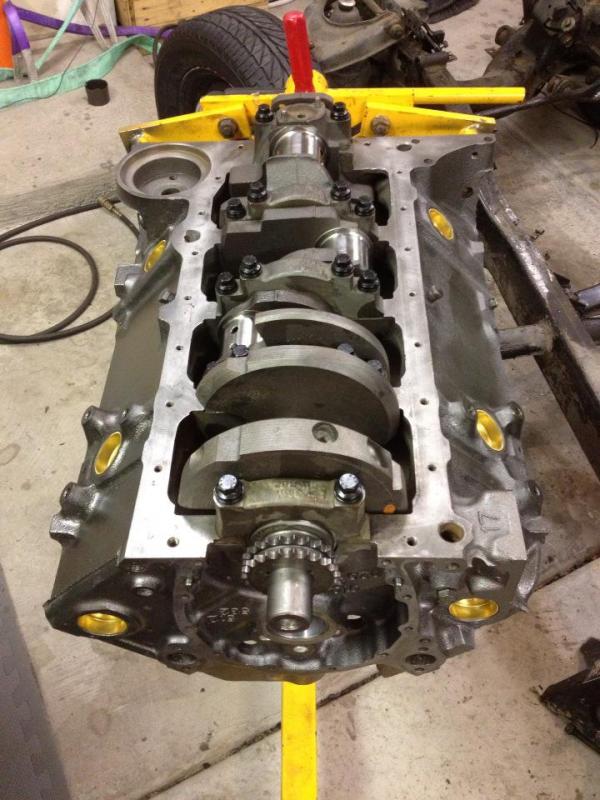

    Bottom End-
    Block- Bored .060
    -New pistons
    -Reconditioned rods
    Crank- 10-10 grind
    -ARP Main bolts
    Top end-
    Heads- Rebuilt stock.
    -All new parts (valves, seats, seals, guides, springs)
    -Magnafluxed and resurfaced
    Intake- Weiand power plus
    Camshaft- Comp Cams Extreme Energy XE262H (advertised I-262, E-270)
    -Comp roller tip rockers, lifters, push rods

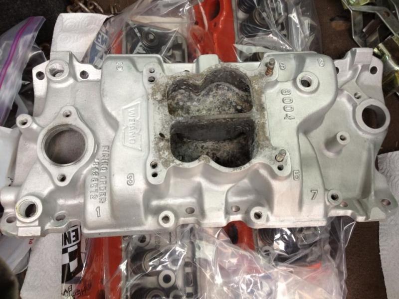

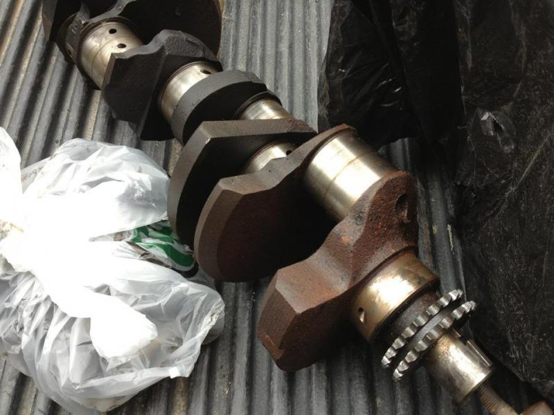

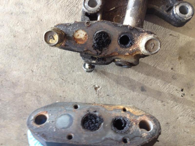

    545706_418512901510281_802566602_n.jpg 538524_418513044843600_173083646_n.jpg

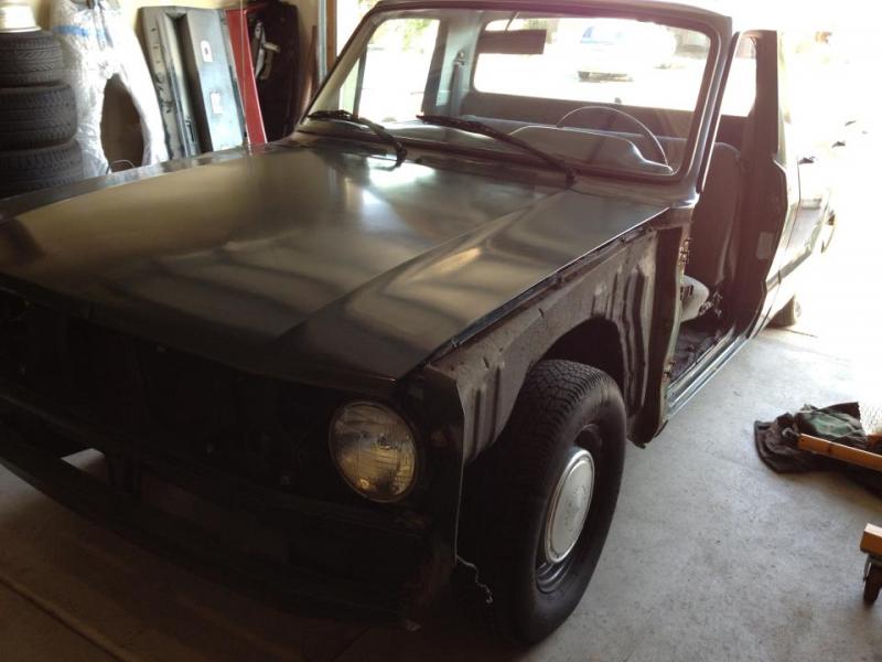

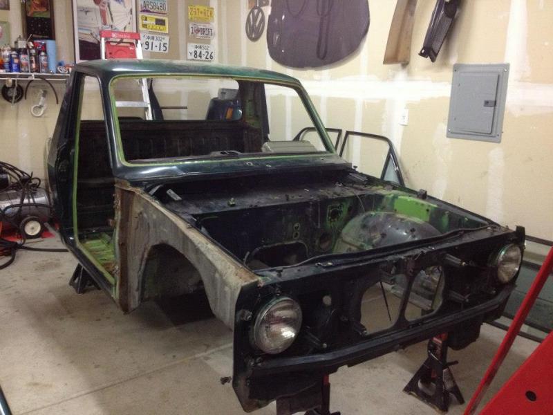

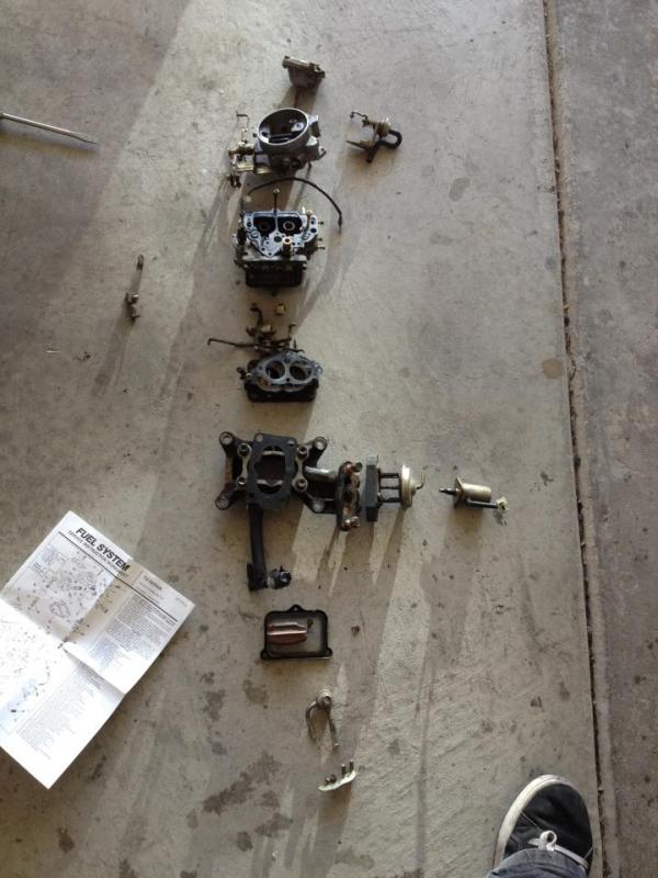

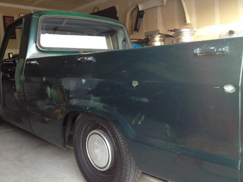

    Had to rebuild the carb and do some spring cleaning
    Started to do a little body work while it was still running.
    536801_433879693306935_1566446580_n.jpg 562204_433879879973583_165979311_n.jpg
    205240_458306950864209_82065080_n.jpg 295274_487014181326819_1242419519_n.jpg

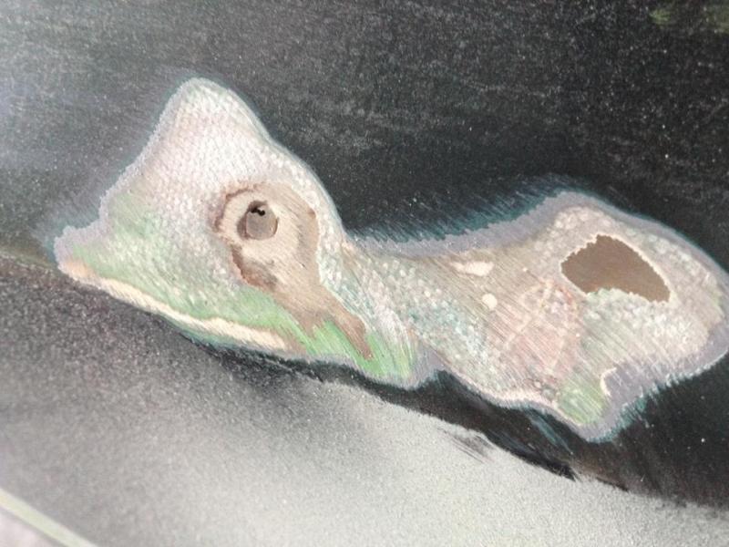

    welded all the trim holes
    uncovered the old mirror holes and welded them

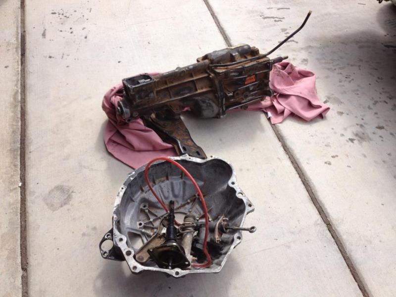

    Passed the final test in ALS today and rather than going home to sleep like I wanted, I decided instead to put some of the bottom end together.
    Still has a while to go, but it's getting there.

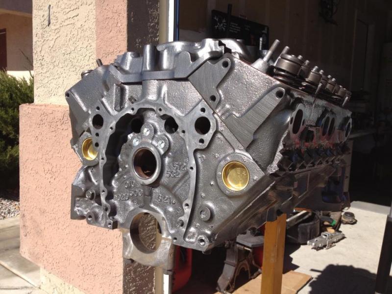

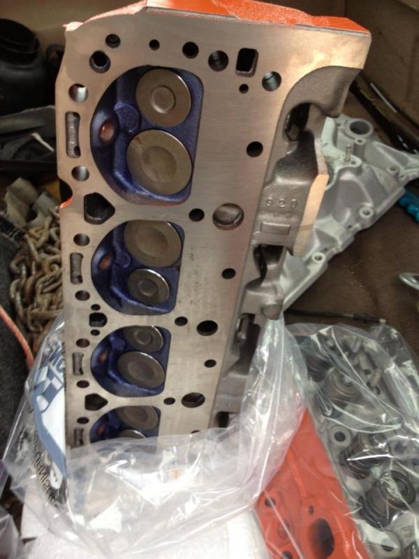

    Heads are on and intake is temp installed. Going to pull it off the stand and connect the trans to start mocking it up on the frame.

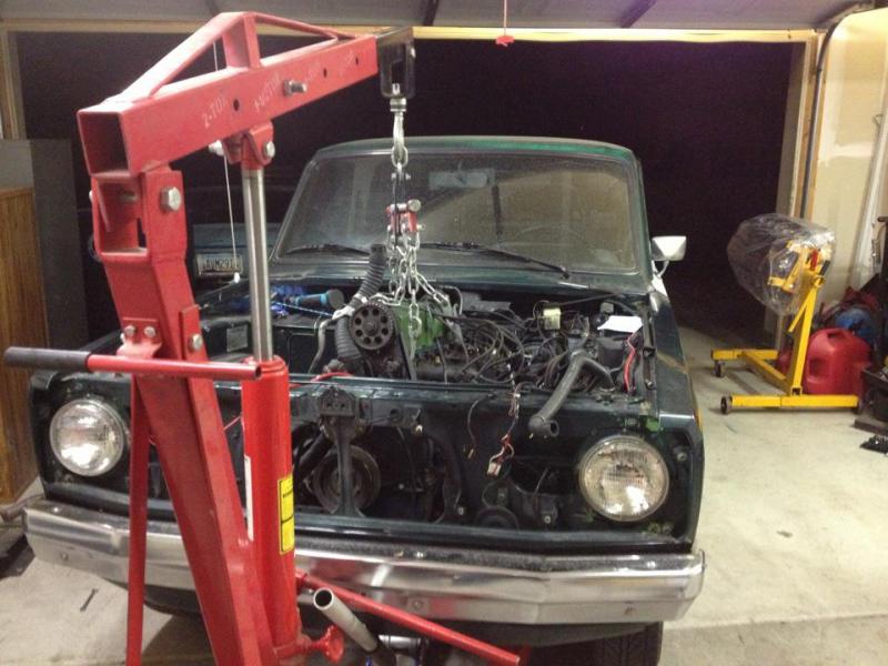

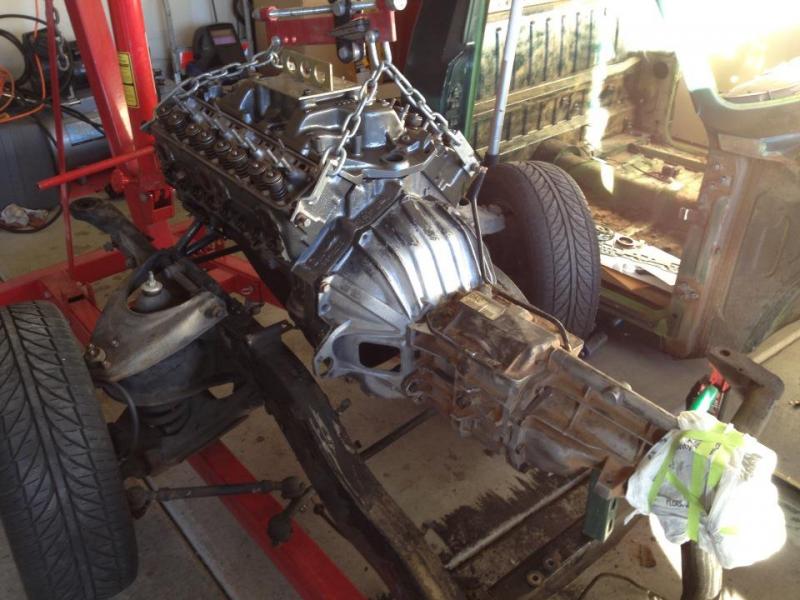

    ~And this is where I'm at as of today~
    Had the day off today, so I got back to work on the truck.
    Lined up the engine/trans to see how close it was. The pictures are after I lifted it back up a little. The oil pan set on the cross member and there was no way it would even come close to fitting.
    150902_542524012442502_110200066_n.jpg 382035_542524059109164_220065312_n.jpg

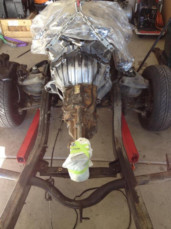

    Cut the center of the cross member out.
    524866_542589779102592_840599018_n.jpg 481439_542589812435922_1770970196_n.jpg

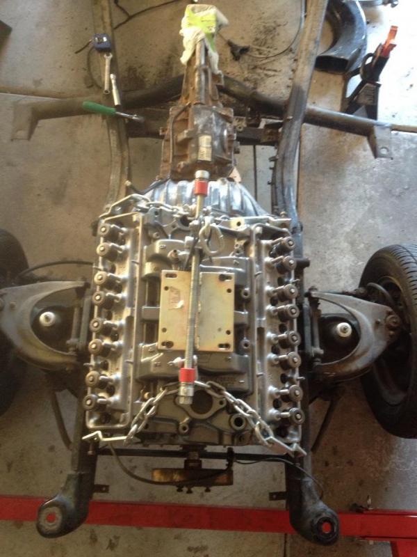

    Set the engine back in. Now I have to cut the frame around the bell housing. It's too wide to drop down in there. The starter hump and the slave bracket rest against the sides and won't let it go down.
    I'll also have to get different engine mounts. These are sitting on the frame right now, and I still want the engine to set about 4 inches lower than it is.
    It's going to be fun come time to do the exhaust. The frame rails are directly under where the exhaust would turn down.

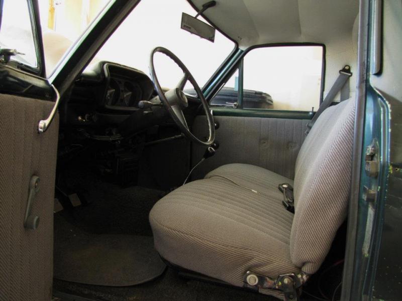

    You got some pics of the inside of the cab? Ie dash. Lol.

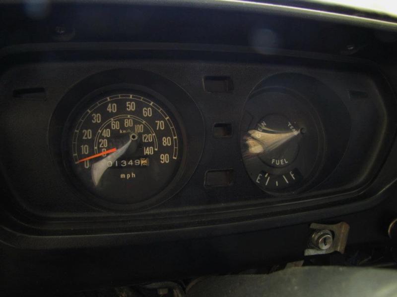

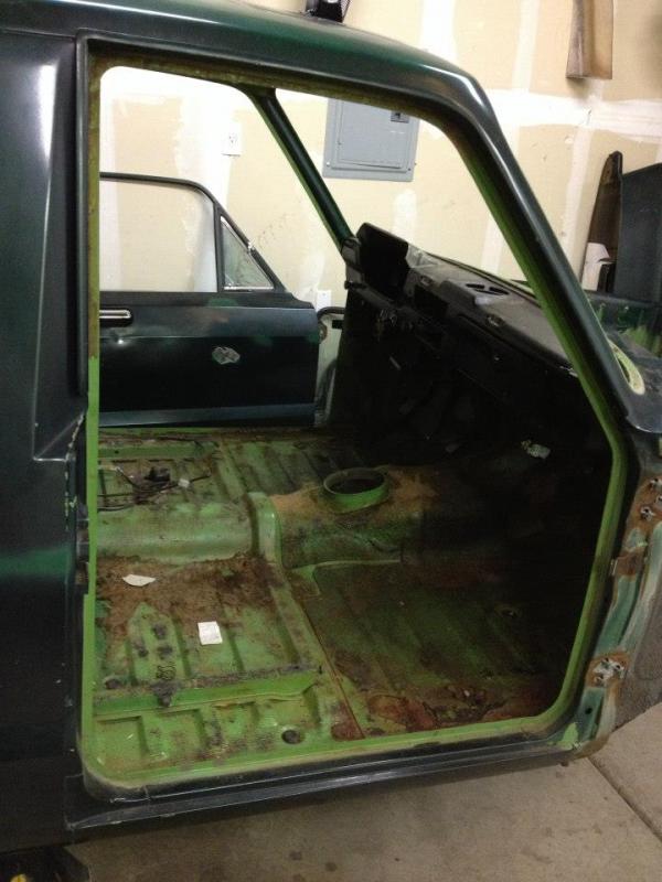

    My Christmas presents came in today. Now I can finish putting the valve train together and close up the front of the engine.
    These are the only shots of the interior I have
    538524_418513044843600_173083646_n.jpg 558699_418513138176924_1647811984_n.jpg 383403_418513198176918_1798637310_n.jpg 295081_418513268176911_1651073571_n.jpg

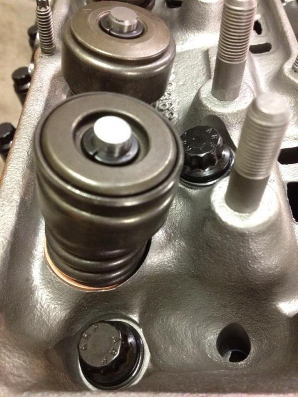

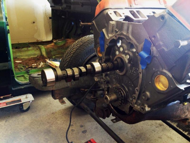

    I was feeling lazy today so I didn't get much done.
    Installed the cam, timing kit and cover, lifters, push rods and rockers. I still have to do the initial adjustment on the valves though.
    230256_543633598998210_490907950_n.jpg (I have a picture of the rockers installed, but it says the file is too big...)

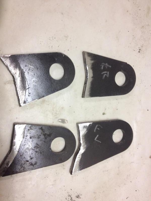

    For Christmas, I did some more work. Cut the sections out of the frame to fit the bell housing and got the engine mounted.
    Had to cut the mounts nearly all the way down to get them between the frame with enough room to mount the brackets.
    I'm going to start on the trans cross member/mount this weekend.
    They look crooked in the picture, but they're lined up. Don't worry.
