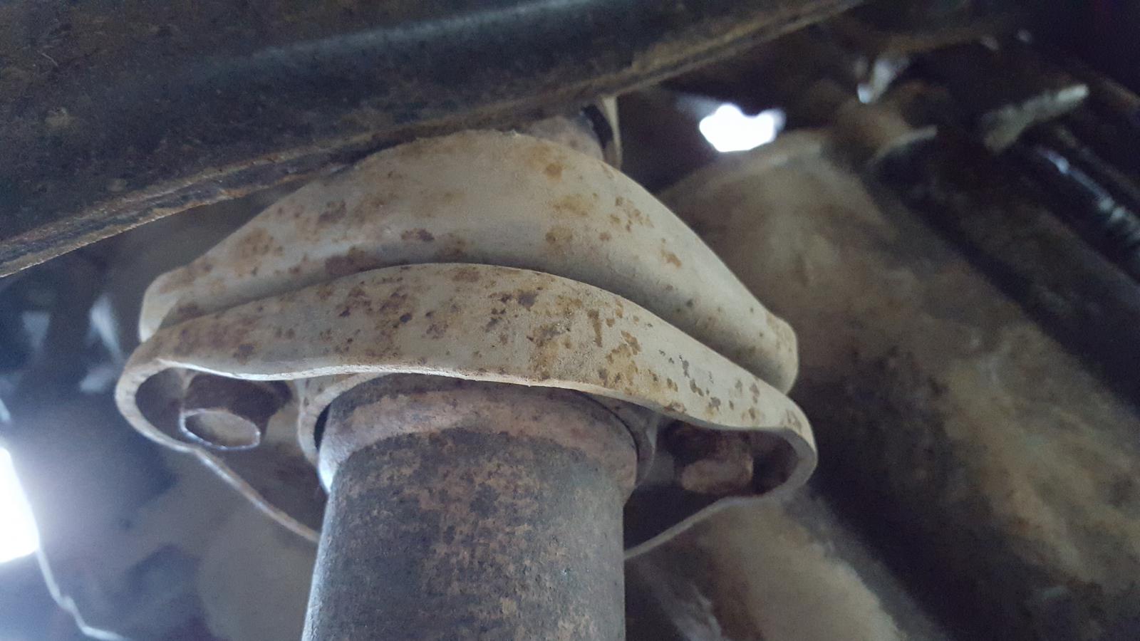

    As for the tranny mount, it's solid and was inspected after the noise occurred. The rubber isolator is quite flexible, but clearly not ripped. Even so I will try your suggestion when I have a second person available for it. I'll also unbolt the crossmember with the trans supported to ensure that the mount is good.

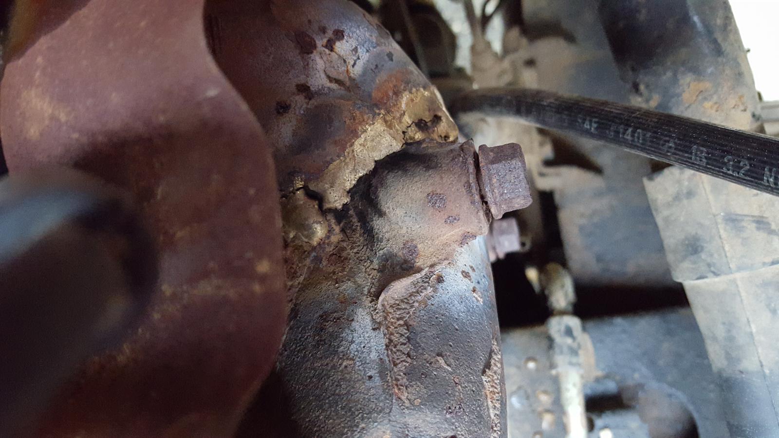

    There is an exhaust leak from the right bank manifold to the y-pipe (old gasket), and it makes an audible noise that will also be remedied before the teardown.
