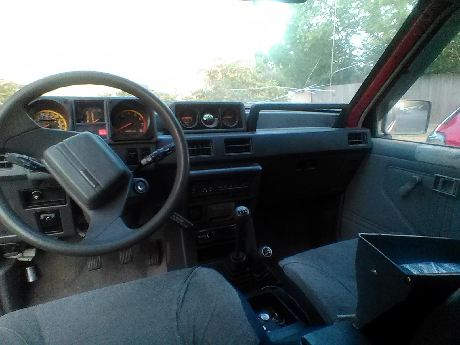

Thanks for all of the compliments on the dash guys, everyone I show it to tells me they couldn't tell it wasn't stock, which is pretty much what I was going for. It's still nice to hear that folks who know what is supposed to be there like it too

As for the dash I'm loving it. It's everything that I'd hope it would be
