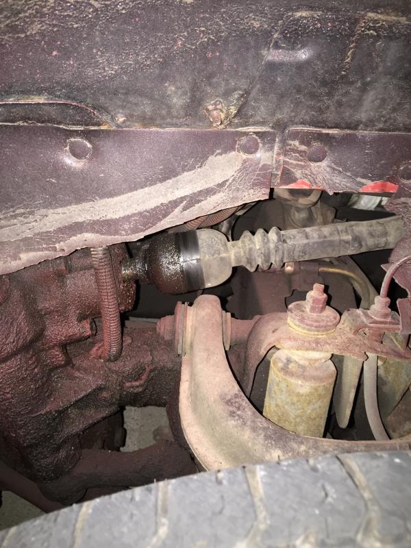

    Hi all, new to forums as I purchased a 1987 Dodge Ram 50 4x4 from craigslist. Came with two sets of wheels, interior just needs TLC, neighbor is going to help restoring the upholstery and now I'm just trying to make sure that its operational. Initial thing I had to do is get that rear rusted area removed and have it repainted. The main issue I now have is that there's a leak by the front left control arm area and me being noob, I need some expert advice. Its being said that there's a leak and photo shows where the gunks coming from; however right side is fine, just the left gunking up the control arm. Please advise as I want to fix my truck soon and I dont want to pay some ridiculous price.

    welcome! sweet ride!...4wd! i am under the impression you are referring to the power steering box leak. verify the correct fluid is inside...doesn't appear to be leaking terribly from the pics...have you had to add power steering fluid?...may be able to simply tighten the "valve housing nut". rockauto sells a rebuild kit....there is a rockauto discount thread http://www.mightyram50.net/vbulletin...e-Thread/page2

    Pressure wash it, and I agree with the leek location. It only took 20 years to look like that.

    Friend of the family looked at the truck. He sprayed some degreaser, then a quick wash here and there. Looks almost new. He did mention to add power steering fluid with stop leak. He made the engine bay look almost brand new. Now I just want to make sure that I get the joints replaced and shocks installed not sure if shocks will take long.

    +1 on the power steering rebuild kit, draining the old fluid and adjusting the nut to where it feels right for you. It's kind of a bitch pulling the gear out and replacing the seals but it's doable with a buddy and an afternoon. Those seals are probably dry and rotted out.

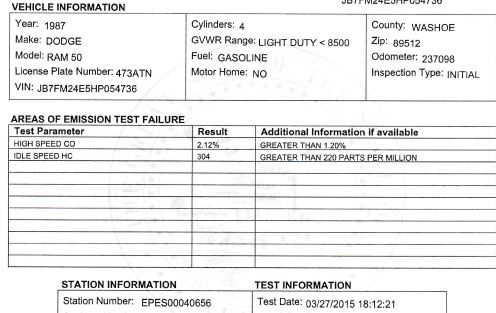

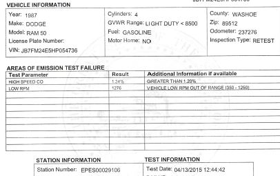

    Two smog checks all failed. First one I had oil change filters changed spark plugs changed, no luck. Second I had to drive around to flush out the bad fluids again and refill and failed by .02. Someone told me to put marvel mystery oil in gas and oil have it run for a while and do the rest to pass

    I got 12 days left and I'm desperate. Might switch out the catalytic converter. Was told it idles too low now lol. Don't want it to sound like its at 4K rpm constantly either.

    Don't throw parts at it.
    What are the numbers for the failed smogs?
    Added the Marvel Mystery Oil and had it run for a bit to get it flushing in there. Was going to attempt to test again; however, I figure to try it out tomorrow.
