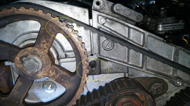

    Evening Gents,
    I have what I believe is probably a basic automotive question that I feel like I should know the answer to. I recently changed the timing belt on my truck. While I feel like this is typically a pretty simple process, mine was a bit of a challenge. When my crankshaft Mark is at tdc, the cam and injector pump are way off their timing marks. It feels like they are both almost mid stroke. I had to Mark them and clamp them in place to swap the belt and keep things at least setup the way it was. The truck runs but I don't feel like it sounds right so I would like to check timing. What do you think my best approach to this issue should be?
    3,846
    Ok so you have a diesel. Well the timing is extremely critical. You can easily get it off by 1 tooth. Injection needs to start around 17 deg I think. Re check everything and make sure things don't roll back when tighten up the belt. Do you have a manual?

    At the moment I only have the manuals I've been able to locate on the site here. More than willing to buy one, just haven't come across one in my searches. I know that the timing is pretty much exactly what it was before the belt replacement, I marked where it was originally and reworked everything a dozen times or so until i had it exact, and it runs the same way it did previously. My concern is that it was never right before. I wasn't sure how the pump and cam could be that far off when the crank is TDC and still run lol (but likely just my lack of knowledge). It idles fine, and run/drives without issue, it just doesn't sound quite right in comparison to some of the sound clips I've listened to.
    I guess my biggest question here that I should've asked, can the crankshaft pulley be installed more than one way, or is it a safe assumption that all the timing marks are correct? The engine has been rebuilt to some extent so I really have no clue what's been done to it.
    As an example, here's a pic of the cam shaft sprocket while the crank is at TDC.

    The marks not lining up is weird. I would get a sanity check at a shop.
